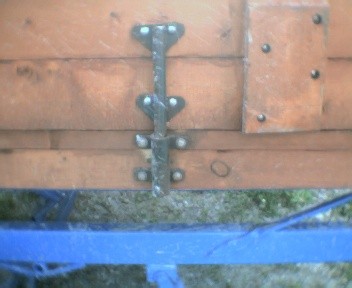

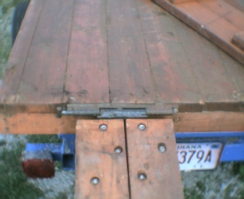

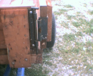

I made up some outta 1/2 pipe and angle iron.I used 1/2 rod for the pins and welded a T handle on top.I made stake pockets out of 3/4 inch pipe and 1/2 for the stakes.Just welded the pipes to some plates and bolted these to the sides.The wagon has matching brackets on the rear so the sides can double as loading ramps. /forums/images/graemlins/smile.gif

   / Latches for haywagon sides? #5
Picture of a side rail corner bracket. Opened to show how it works.
   / Latches for haywagon sides? #6
And one of the side rail stake and pocket.I haul manure in this dump wagon every weekend and it's plenty strong for that.
   / Latches for haywagon sides? #7
One last picture of a side rail in the ramp position. /forums/images/graemlins/laugh.gif
