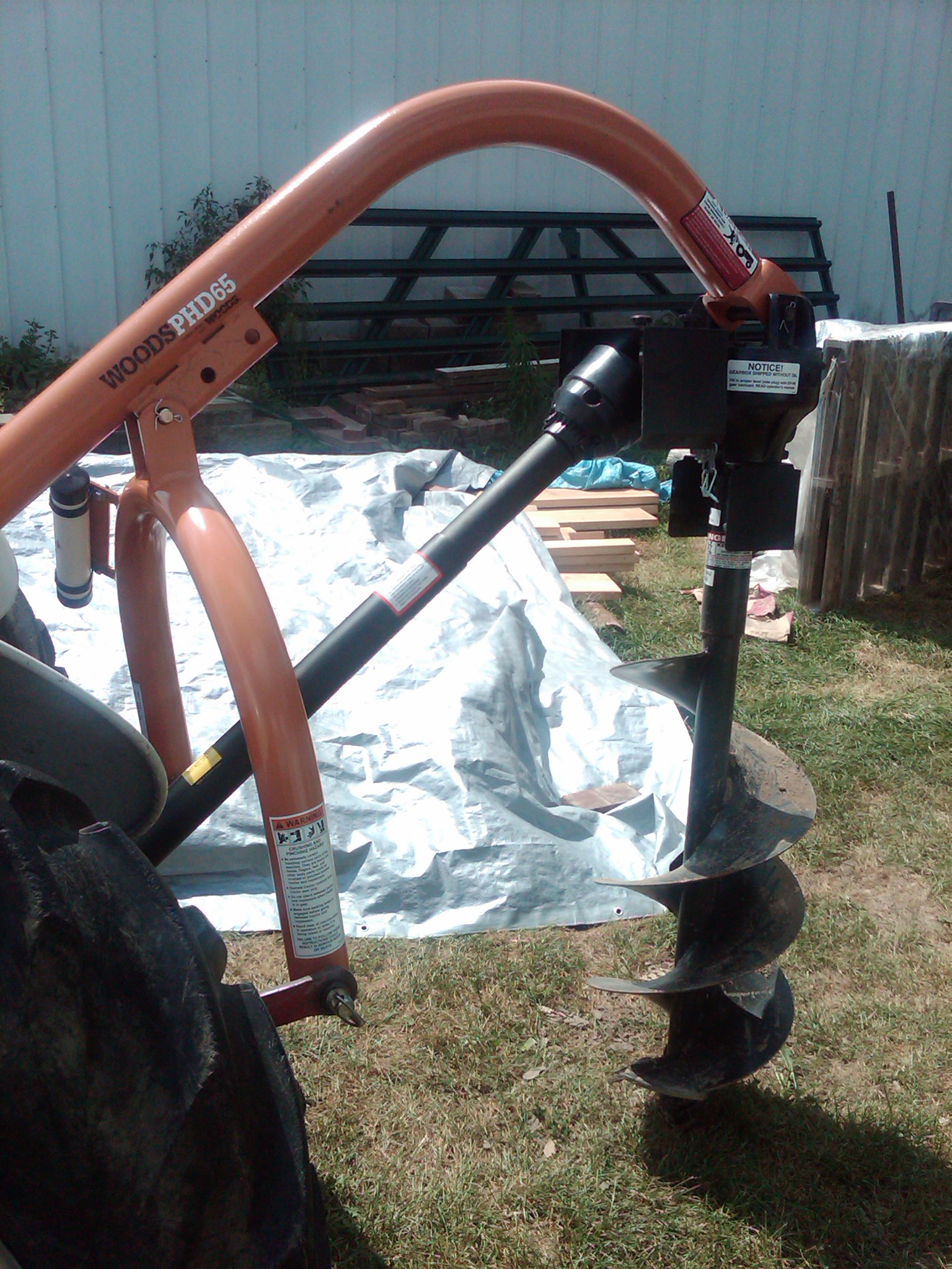

Post hole digger - we believe we want a heavy duty with a 9" auger to start. Initially we need to do a fence. Later on - the sky's the limit. Should we finance a Land Pride through Kubota or can we save money and buy one somewhere else -or- is there one that is 'better' that we should buy because it makes more sense?

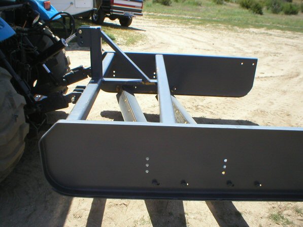

Box blade - we believe we want extremely heavy. We need a very long driveway and want to carve in atv/mx trails. Not sure how wide we would want? Not sure on the weight? Are the scarifiers relative to the width? Should we finance a Land Pride through Kubota or can we save money and buy one somewhere else -or- is there one that is 'better' that we should buy because it makes more sense?

The box Blade should be as wide as the wheel track outside to outside.
Land pride makes nice box blades and your right the heavier the better.
The Box Blade I would probably buy and finance with the tractor.
The Post hole digger I would shop around. The only significant difference in them is if you get one with the down pressure kit. You could really go top shelf and get one the is hydraulic and mounts to the FEL they have forward and reverse.

Buy a medium or large tree planting auger and you will never require any other auger when you buy it-the tapered auger and carbide cutters will allow quick digging with no bouncing and the taper allows it to just suck its self in nicely because there is no side wall resistance or rocks sticking out.
You will have to shovel a little more dirt back in the hole but thats a minor issue when compared to using a small auger and having it bounce all over and break shear pins.
The small augers are a pain with hard ground and they will also try to make the hole larger from side to side simply because they bang around so much.
Trple R is right in what he is telling you as far as implements goes, as they are very pricey in that size; a used plow and replacement Weiss conservation tillage plow shares will suck down to 14 inches and bury your residue.
Even if you buy a large tree planting auger you can dig shallow holes quickly with the tapered head because there is no side wall resistance.

+1 for hydraulic top link. Should be standard equipment when owning a box blade.

Since you haven't bought any attachments yet, get the 3rd function valve for your FEL (it's like $1k and easy to install -- if your mechanically inclined) and get a skid-steer hydraulic post hole digger. I used a trencher on mine the other day and it rocks!
