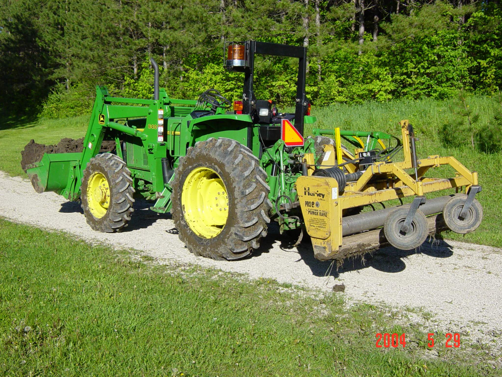

Does anyone have any experience using laser controlled grading equipment?
I have a Harley Pro 8 rake and have figured out a way to make the height adjustment be laser controlled quite easly and cheaply, relatively speaking.
Does anyone think this might be usefull, or is it just more trouble then it's worth? It would just be for plain flat work. Nothing fancy.

Like jenks mentioned, the power rake would be nice for loosening up soil to be graded with a laser controlled box blade, but IMHO the laser setup would be a waste on the Harley rake. It's not what it's designed to do. I'd go with a dual slope for everything but straight and level building pads.

DSC00314.jpgDoes a laser only shoot out one beam? Does that mean if your receiver is only a foot long and the laser isn't hitting it, that you are out of luck? Trying to understand this.
What is the difference between a single slope and dual slope?
As far as the rock rake goes, it would have been the easiest to incorporate. We have very stoney ground around here and the box blade would be useless for grading. The stones roll under the edge raising it.
I was going to use my JD that has a hydraulic remote that is electically controlled. It is actually for the loader/grapple, but I can easily plumb that to the rear, and then to the up/down circuit on the Harley Rake. Then I would get a receiver that is designed for visual operation (not machine control) like one mentioned above, and wire some opto isolators into the up and down LEDs and with this signal and relays, operate the cylinder. That for me, is the easy part.
This older Harley with the flat serrated bars shaves off high ground like no fixed blade can (short of a dozer) but I concede that filling in low areas could well be an issue. Maybe it's a waste of time and money, but it is something I would be thrilled to play with and maybe just kind of an introduction into automated machine control.
Rancher. How did you ever get that gravel delination sooo perfect????

View attachment 356334Does a laser only shoot out one beam? Does that mean if your receiver is only a foot long and the laser isn't hitting it, that you are out of luck? Trying to understand this.
The laser is shooting a very narrow beam so if you are out of the pick up band of the receiver you are out of luck as you say. The less expensive receivers have a shorter pick up range than the better ones too. For rough grading it should be obvious when you need to keep cutting down until you are with in the working parameters of the receiver. It should be just as obvious where you need to fill in a large depression to reach grade. Also notice some receivers pick up the laser for a full 360 degrees while some have a lesser arc.
About Rancher's work, he takes pride in his work and has plenty of seat time. Good job:thumbsup:
