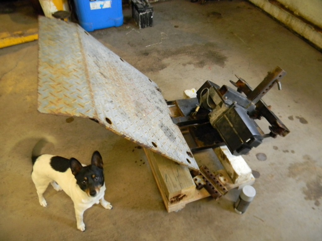

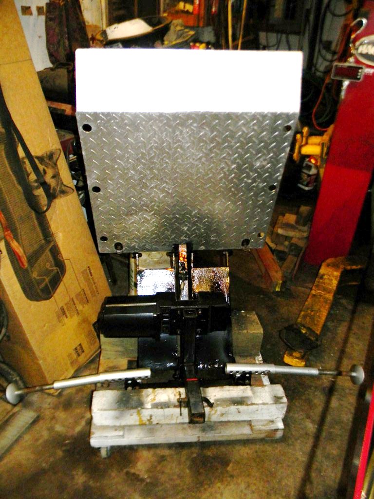

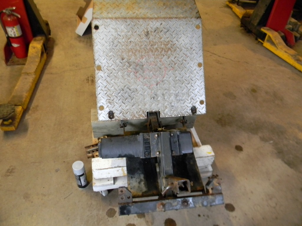

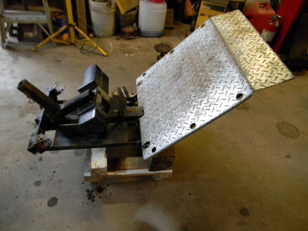

Best price I found was $432. plus about $80. shipping for a new one. After some surfing I found a used one on CL and snagged it for $110.
I tested the operation when I got it home and it works fine. It easily lifted my 220#. Made minor adjustments to the up/down limit switches and replaced the quick connect power plug. I started taking it apart for sand blasting and repaint then will install and get more pics.

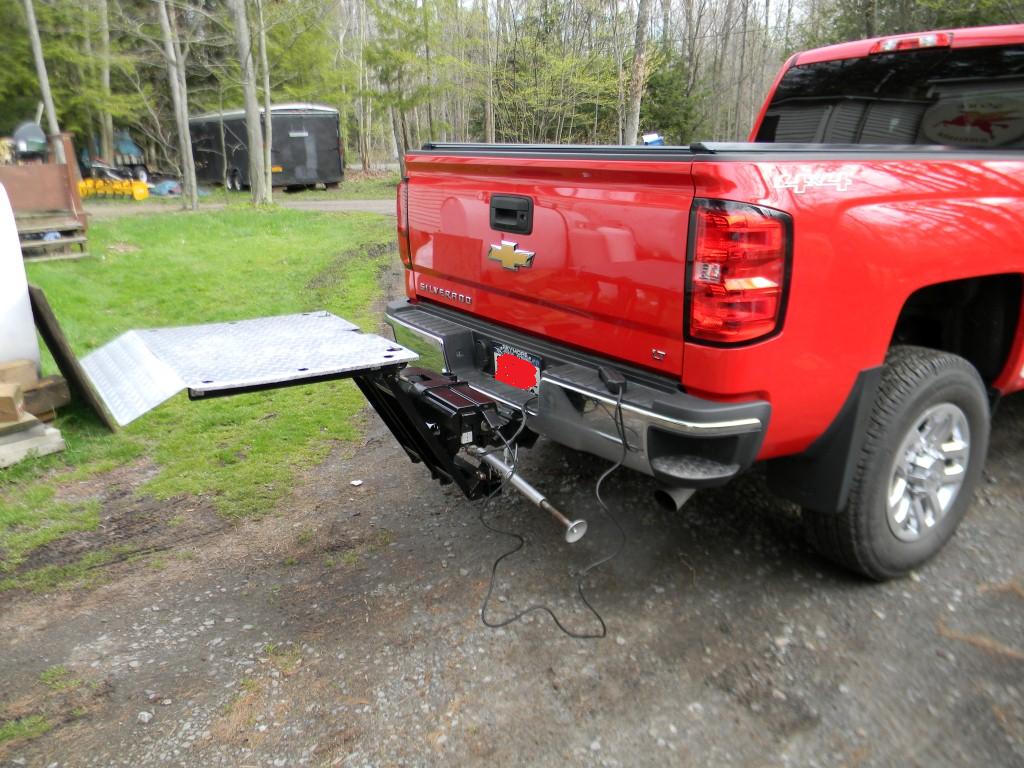

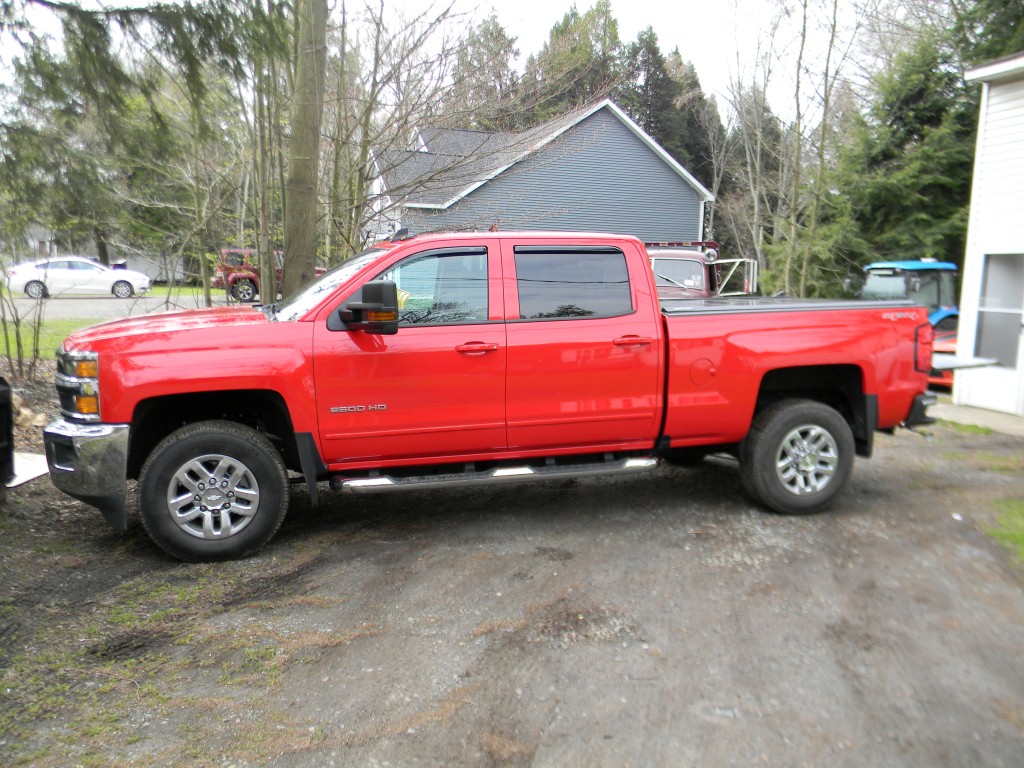

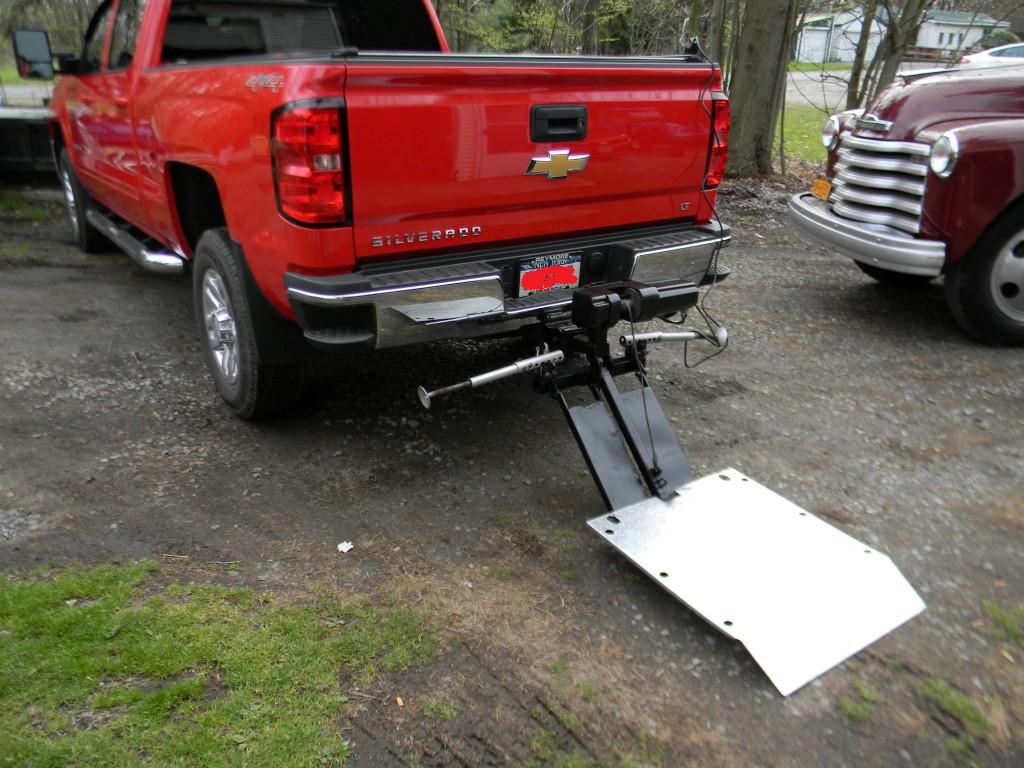

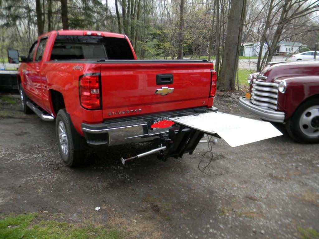

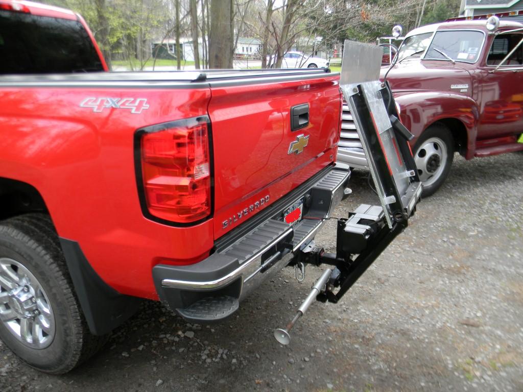

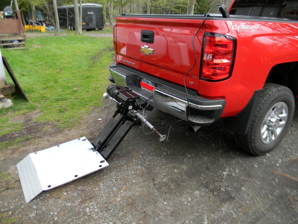

Apparently there wasn't too much interest in this lift but here's a few pics of the finished product all sandblasted, painted, reassembled and installed on the truck. I used it yesterday to load my 100# propane tanks and take them for refill. It worked like a charm and saved my back from lifting them. When not in use it sits on a roll around dolly. It weighs about 115# so I use my electric winch to lift it high enough to slide into the hitch.

Does it contact the open tailgate when raised all the way up?
   / Larin TGL-500 Receiver Lift
No it does not. There are adjustable limit cams for full up and full down positions. I adjusted my upper limit so it shuts off with an inch or so gap to not touch the gate.
I ran 6 ga. cables (red and black) along the frame up to the battery and installed a 40A breaker in line with the hot lead.
