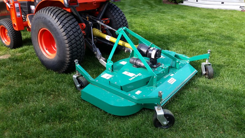

Hey guys I have l3560 that I love but want to get a pto finishing mower for it there is a guy nearby that has a used landpride 90" for a ok price would my tractor handle such a large beast it's a rear pto he used a 45hp at pto John Deere mine's rated at 28hp it is a landpride at3590 I'm mostly mowing manicured lawn and 2 acres of clover

Page 8 (printed page #) states that the tractor HP must be between 25 and 60 HP. With a 37 HP tractor and 29 at the PTO, you'd probably be fine as long as you're not cutting tall wet grass. I have a 30 HP tractor with 24 @ the PTO and run a 72" RFM without any issues.

I run an 84" rear discharge finish mower behind my 34 HP (28.3 HP at the PTO) just fine

I ended up finding a 84" for the same price so went that route as i was scared that maybe 90 was pushing the limits of the machine the dealer said even this 84 will tax the machine but should handle it if i move slow enough.

You should be fine with the 84" on your machine...unless you're trying to cut 12" high grass.
