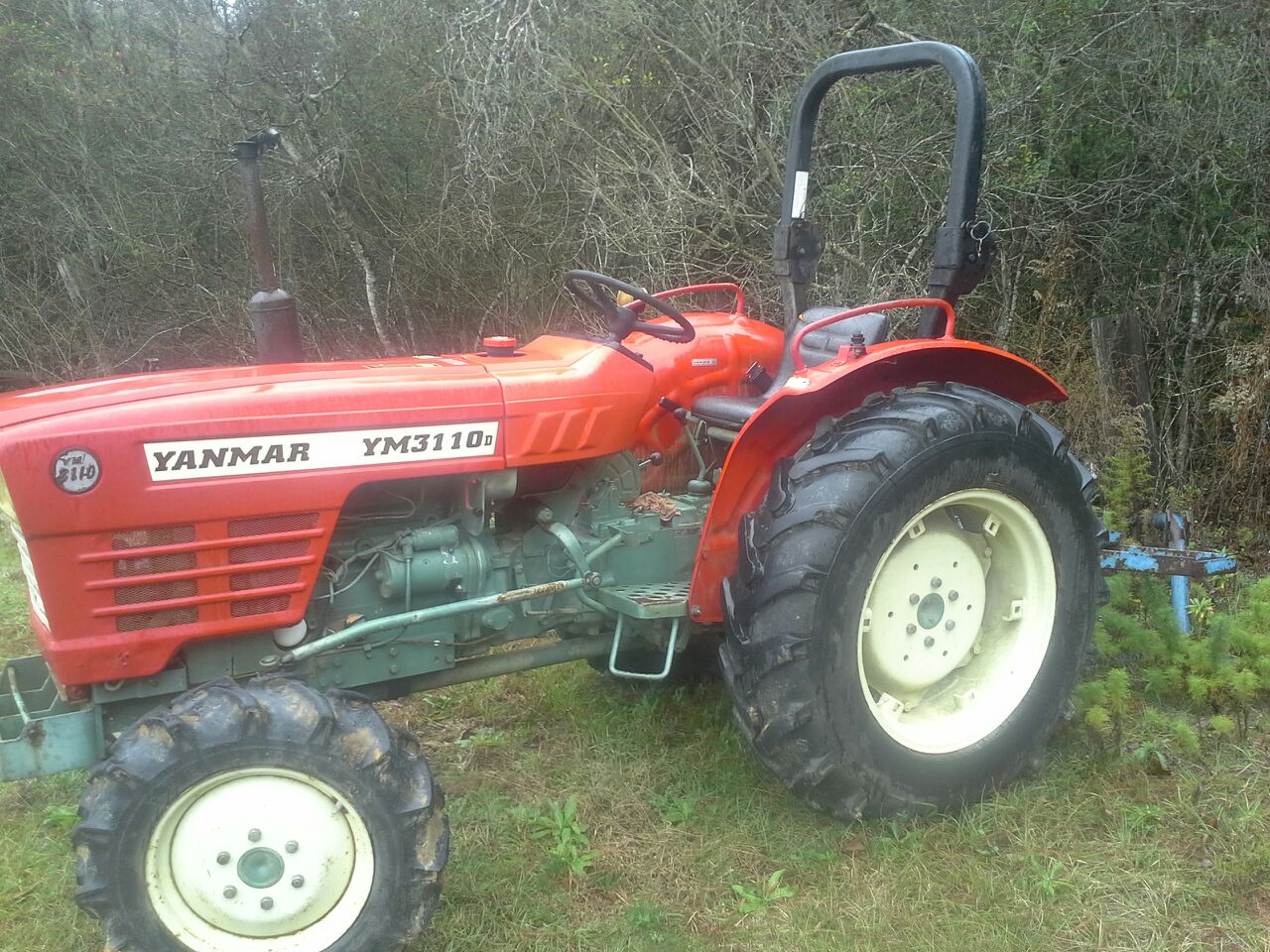

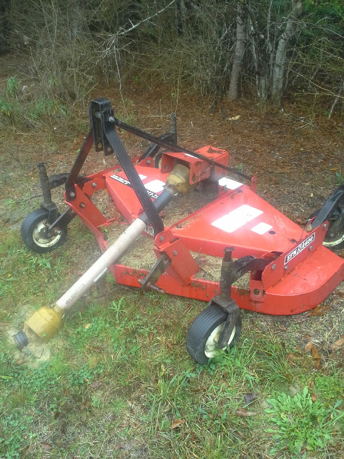

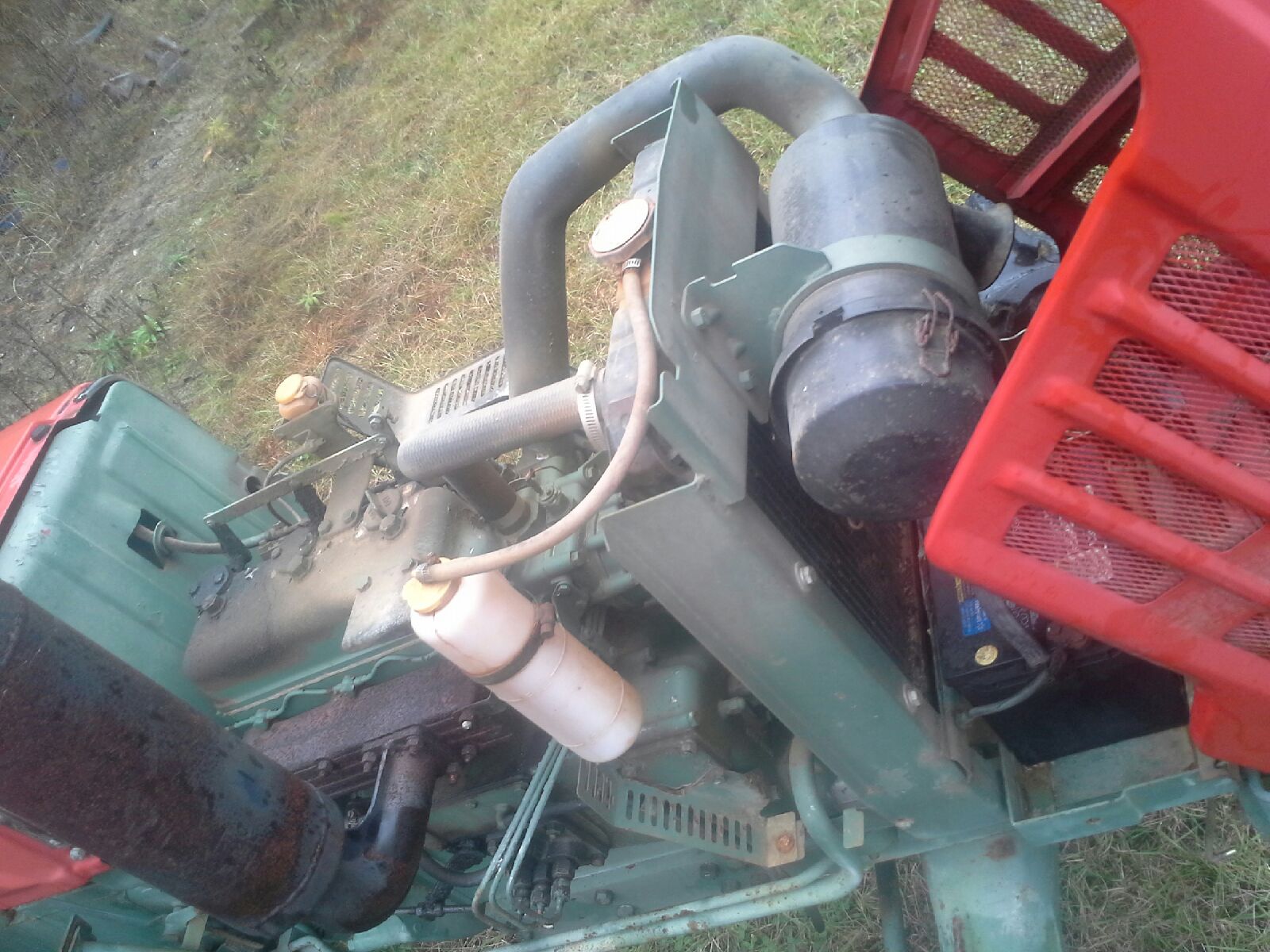

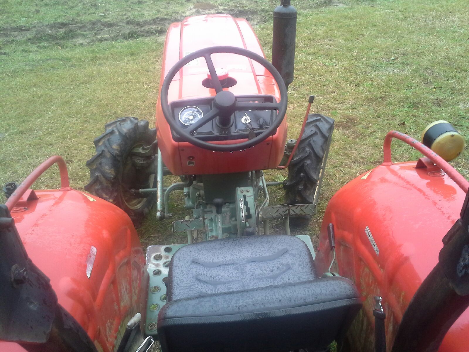

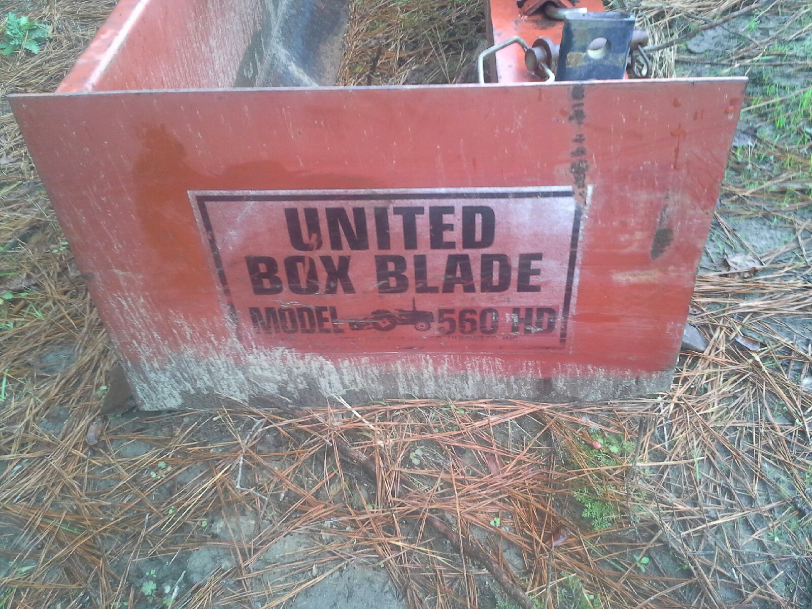

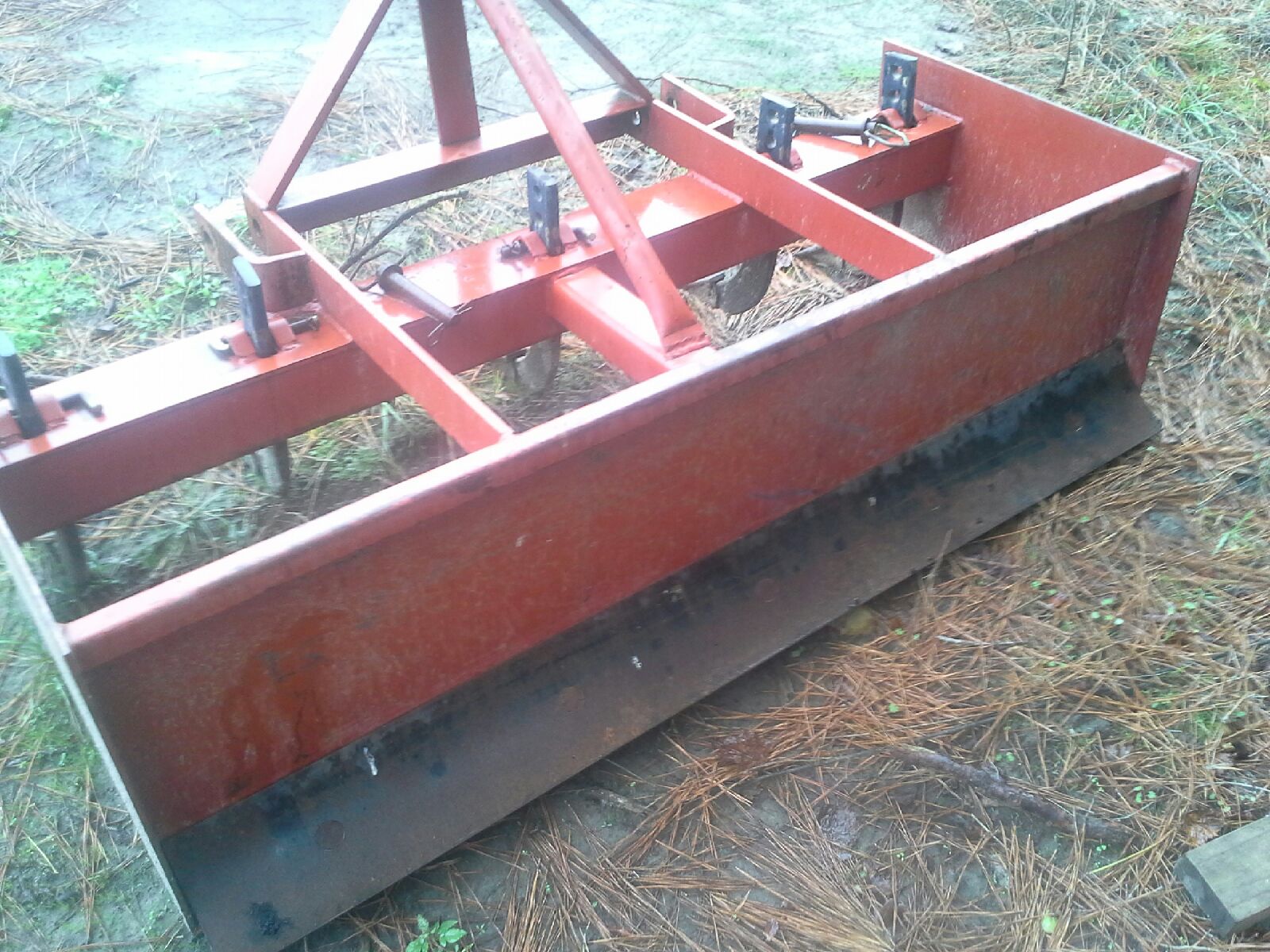

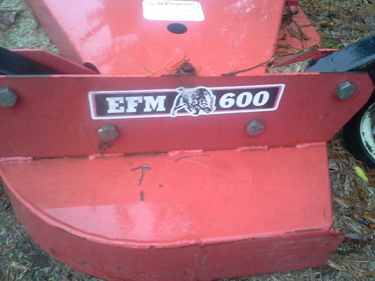

Thanks for the replies. I am definitely leaning towards the purchase of the YM3110D and attachments (I was already favoring that position with the initial post). Again, not really a need, but almost too good to pass up.
I have included a couple of pictures of the tractor and attachments that the owner sent to me yesterday. It looks to be in good condition and both the finish mower (Bush Hog EFM600) and box blade (United 560HD) look to be in great shape. I don't have pictures of the Land Pride 5' bush hog, but he says that it is a little older than the other implements and in working condition. He has only used the tractor to mow and maintain the driveway for the past three years. He stated that there are no problems with the tractor and that everything works.
Thanks.
