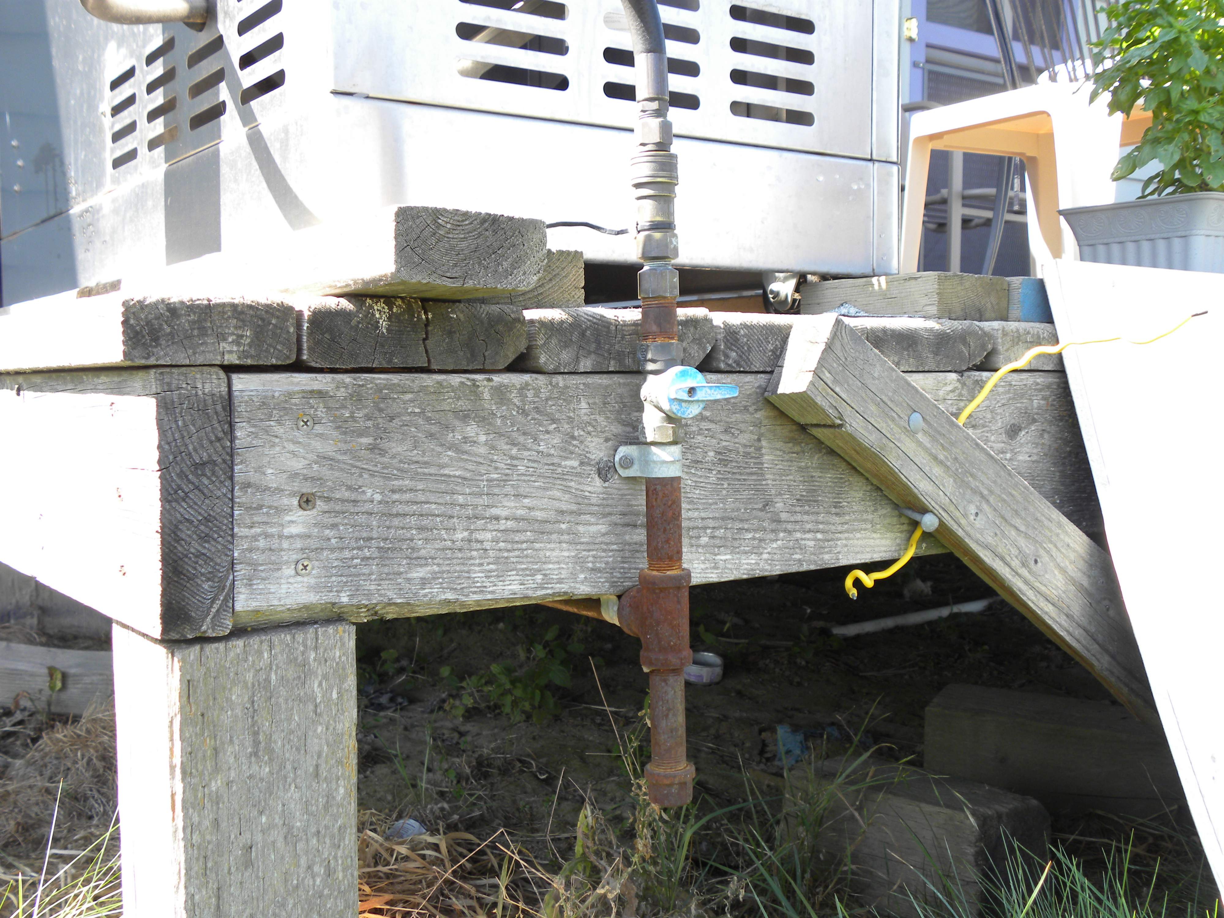

Hi, I have a very large gas grill on my deck. It has 5 burners, 1 rotisserie burner, 2 side burners and an oven. All this is expected to fun off a small 20# tank. I'm always running out of gas. Has anyone ever connected a portable gas grill to their home 500# of 1000# lpg tank? This grill weighs about 300 lbs, so it is never moved. I'm more concerned about operating pressures of these different size tanks. Thanks
   / Large gas grill vs. small lpg tank #2

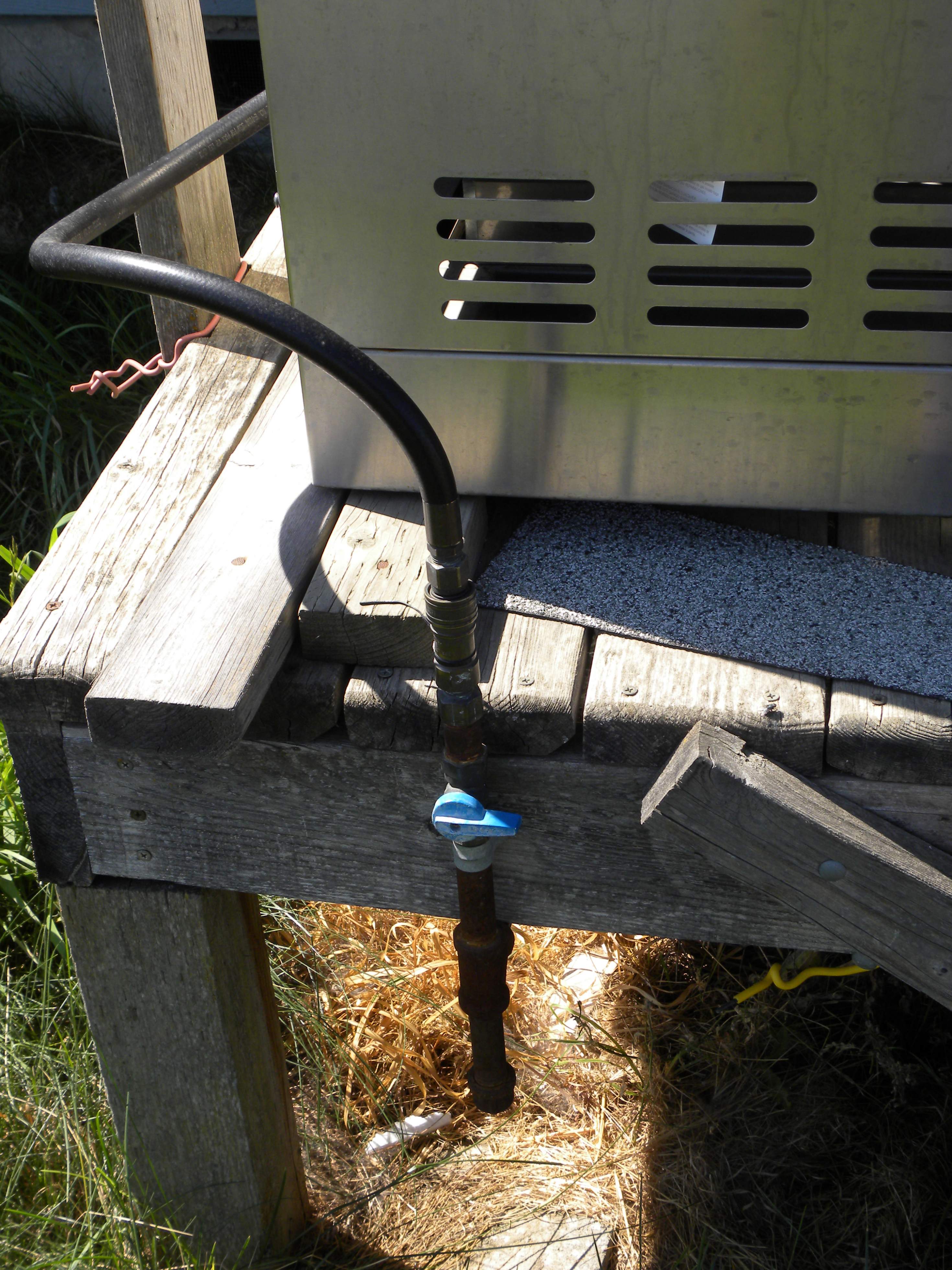

We did just that. When we added propane (1000 gal tank) to our home for heating and cooking, we included a drop with shutoff for bbq. I had a bbq rated quick disconnect hose made at the local hose shop that connected at the shutoff, removed the regulator that came on the bbq and all good. Never run out of gas now. We always shut the valve off after use to avoid draining our 1000 gal tank if there was a leak on bbq.
