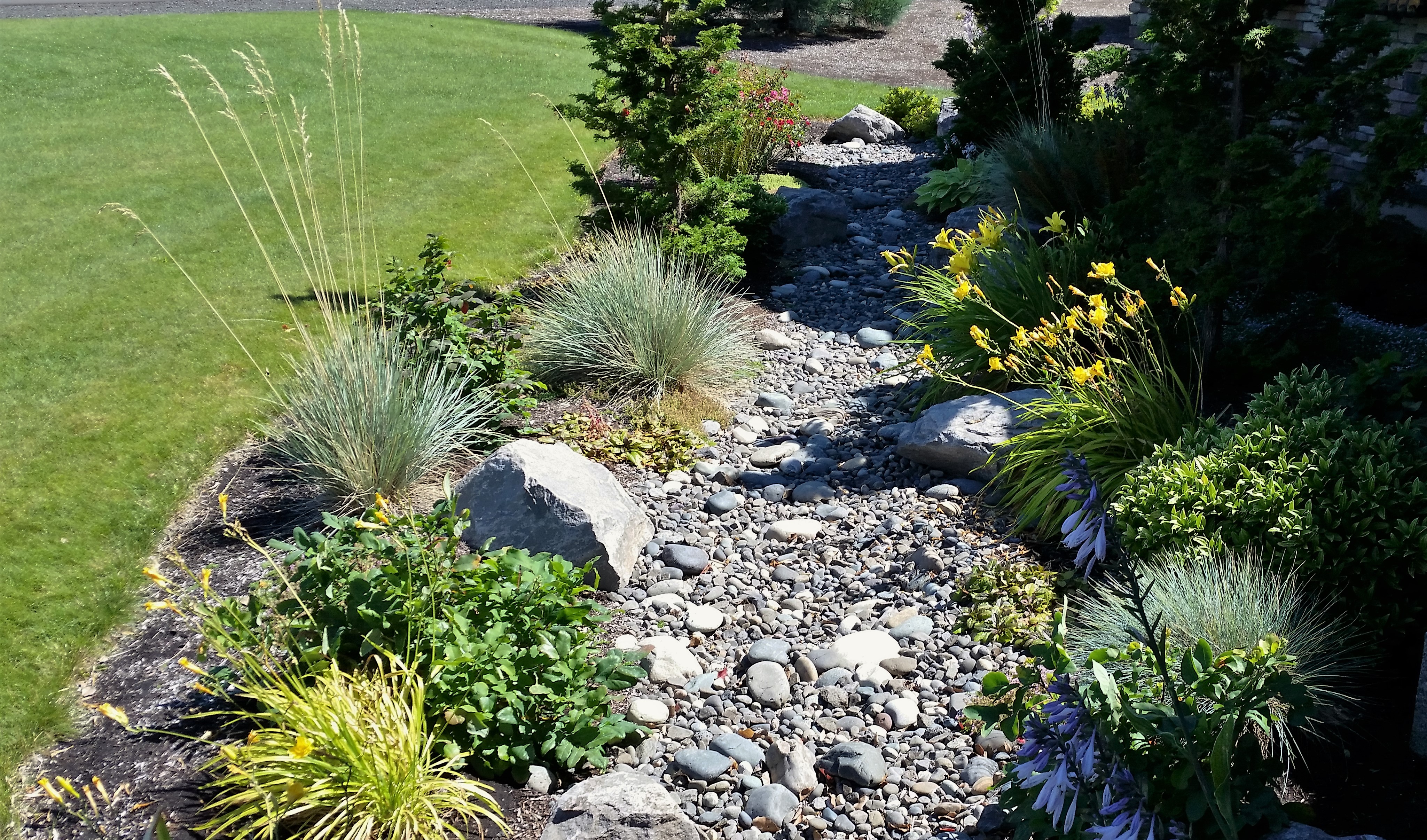

I don't have any pictures of my creek as I'm still in the planning stages of seeing if a wet creek is worth. I will however be installing a dry creek for sure similar to the one below. My wife loves playing around with plants and flowers so I can get my creek and she gets a place to put her plants.
dry-creek-bed-drainage- (1).jpg.
