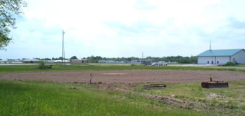

Just bought a 6 foot rake today and have never used one. I've been trying to get a 170 foot circle leveled and cleaned up for thee last two days working with a disk, box blade and home made drag made out of heave duty chain link fence. My problem is the grass clumps just bunch up in a pile when the pile gets big enough the drag ends up going over the top leaving a mounds of dirt and grass all over the place. The rake is a last ditch effort before calling in a landscape company.

Spent the morning with the landscape rake, after two days of fighting clumps and two hours with the rake to get rid of most of them I am completly sold. Still have a few clumps but had to get to work so will finish it tomorrow morning.
