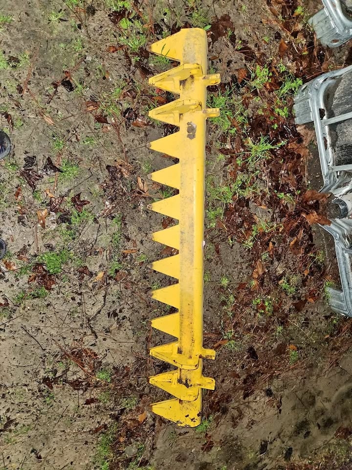

I'm needing a rake as well and saw this.
Seen someone mount this to a box blade, box blades are cheaper and more available then rakes so maybe a way around expensive rake.
Of course mounting on bucket would work but
rather pull from 3 point then back drag from bucket.
Thoughts? This one is 52" which matches my bucket.
