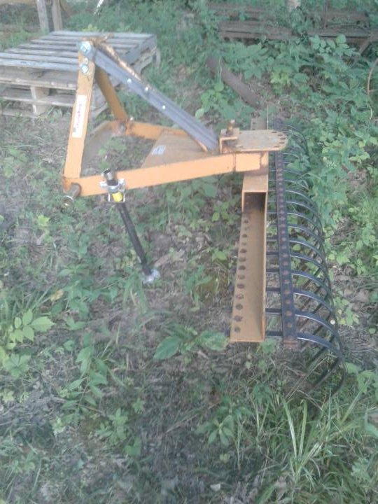

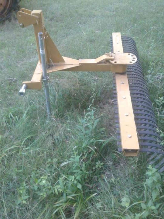

Been looking for used for a few month’s, found a guy just 50 miles away who has 2 of them for sale. It’s a king cutter so not top quality but it’s almost new for $500. The other is unbranded for $450. Both 6 ft rakes, going to look at tomorrow and buy the heaviest built out of the two. Thanks for all the responses.
