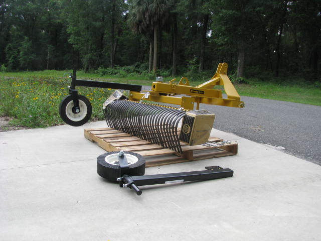

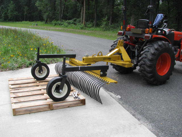

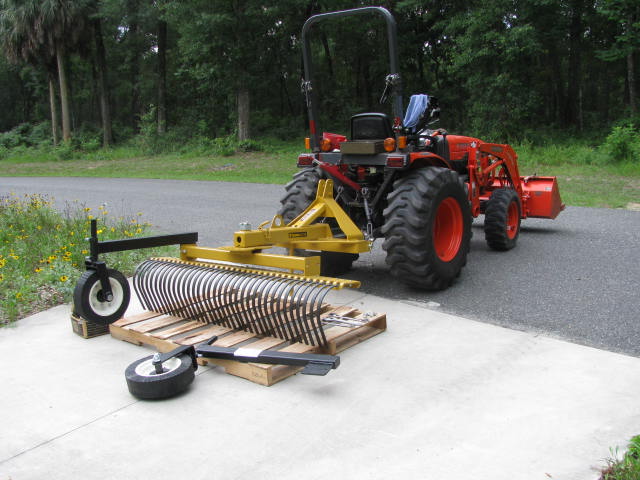

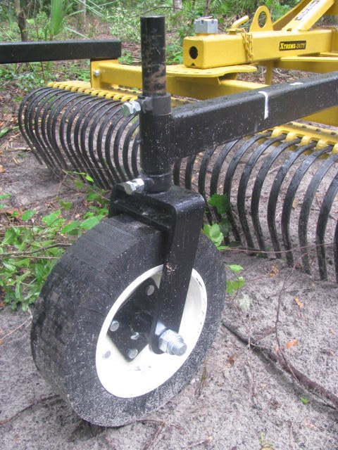

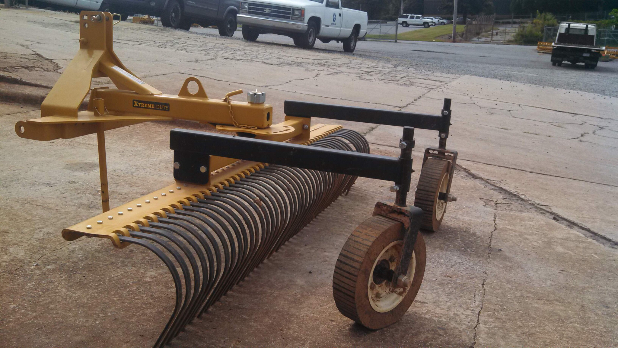

Everythingattachments.com makes excellent Landscape Rakes. Mine is 72", purchased in May 2013; $797 + $299 gauge wheels = $1,096. I would unhesitatingly repeat the purchase.

When you have gauge wheels and the rake is set on an angle, the outboard gauge wheel protrude ~~~way out there~~~ limiting maneuverability.

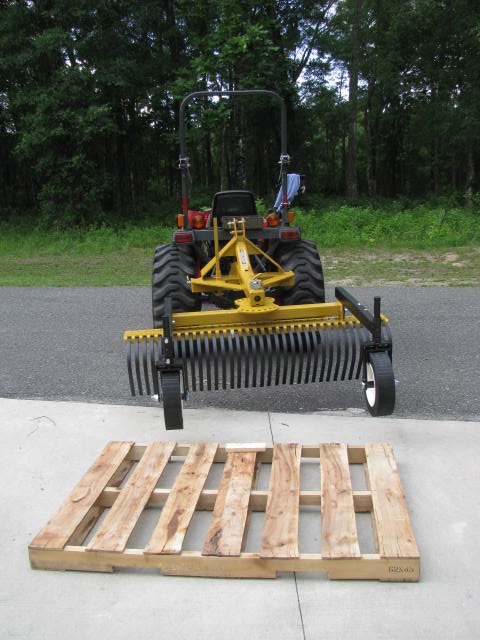

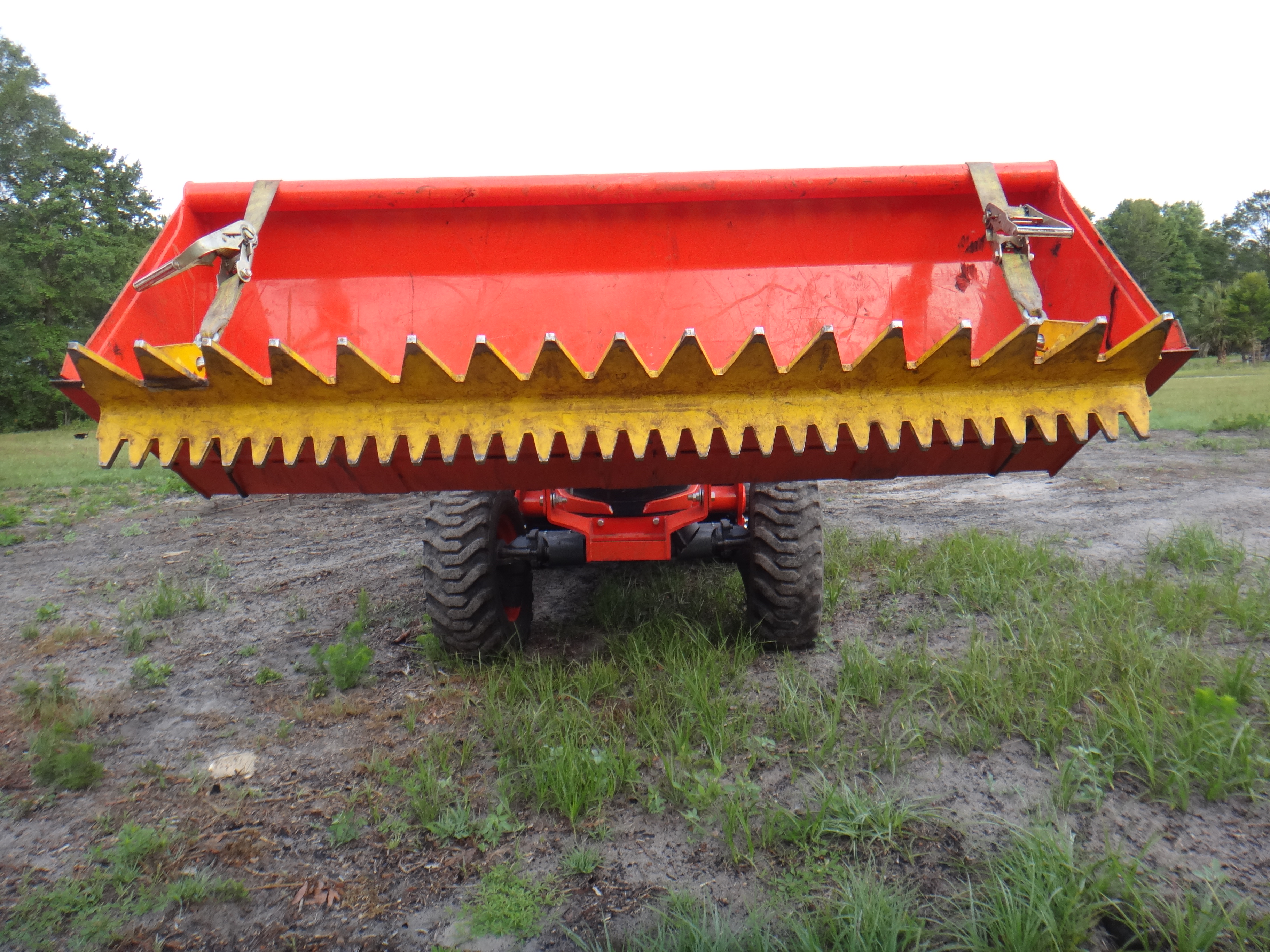

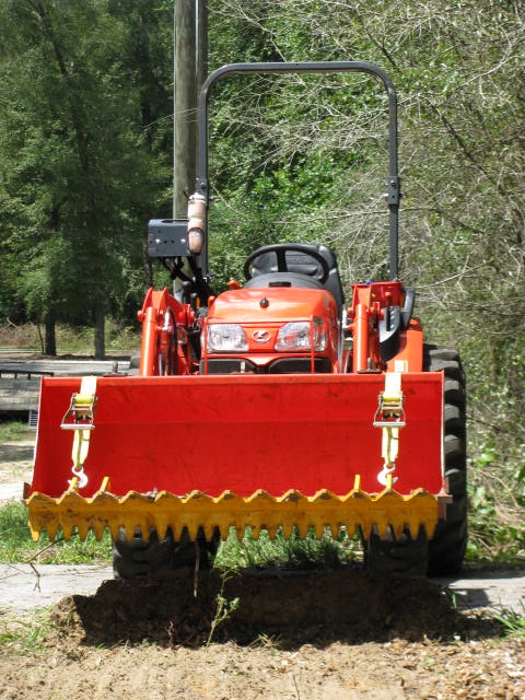

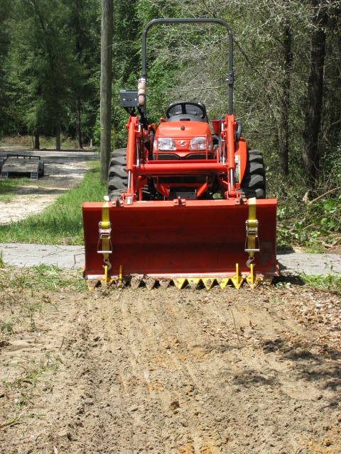

I was clearing an acre lot today. A Ratchet Rake is far better for woodland and trail work and for piling debris than a Landscape Rake. A Ratchet Rake also can move dirt 20' to 30' much like a Box Blade. I use my Ratchet Rake far more than my ETA Landscape Rake, but I do not need to grade a long driveway.

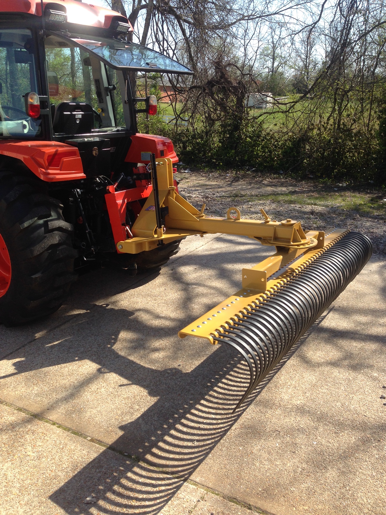

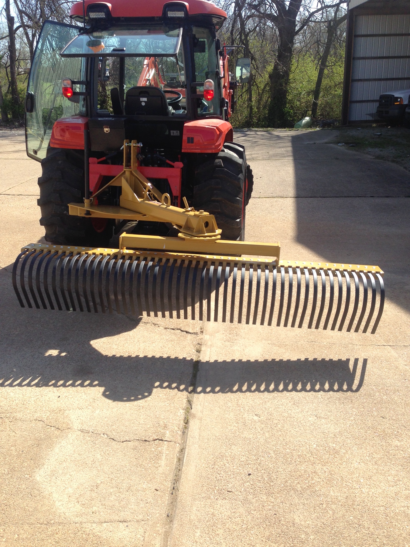

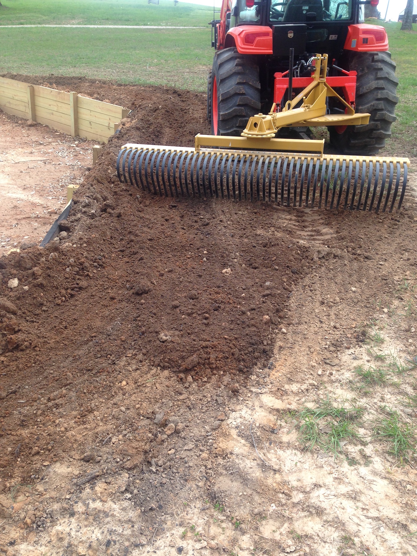

I just bought a everything attachments 8 ft rake and love it, the tine bar is by far the best design for a rake, I wouldn’t go with anything smaller. IMG_3134.JPGIMG_3137.JPG

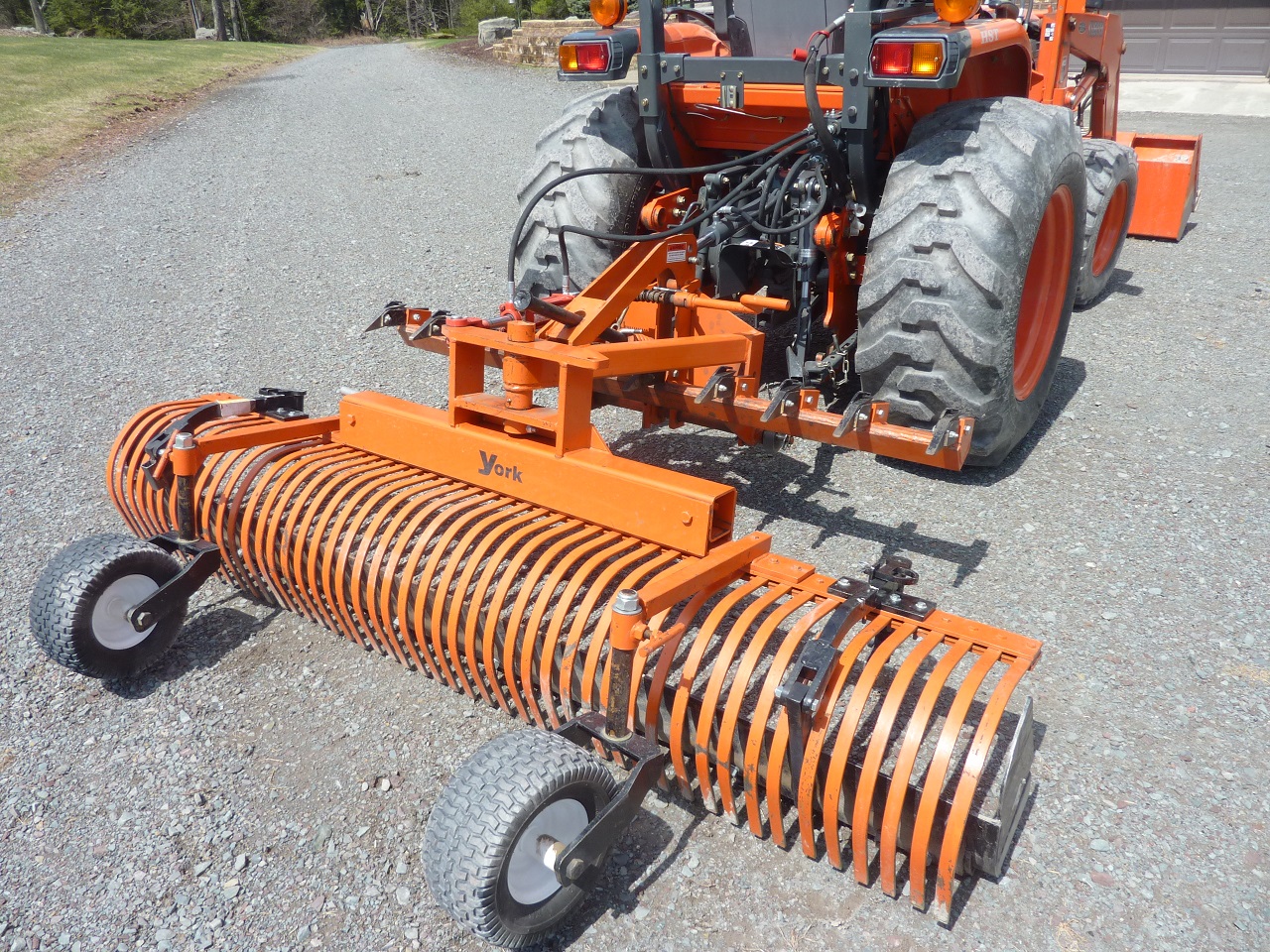

+1 on the York rake.

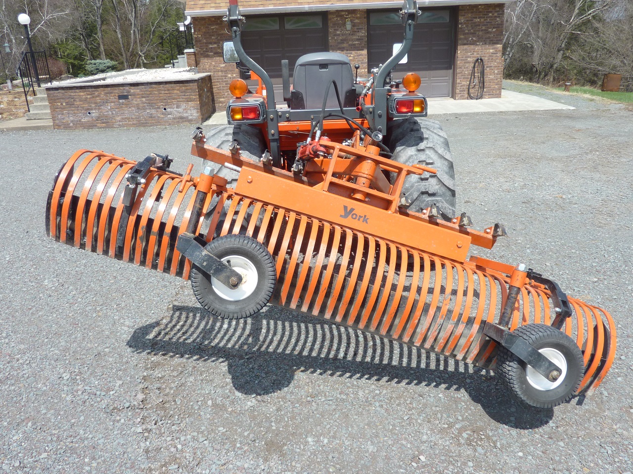

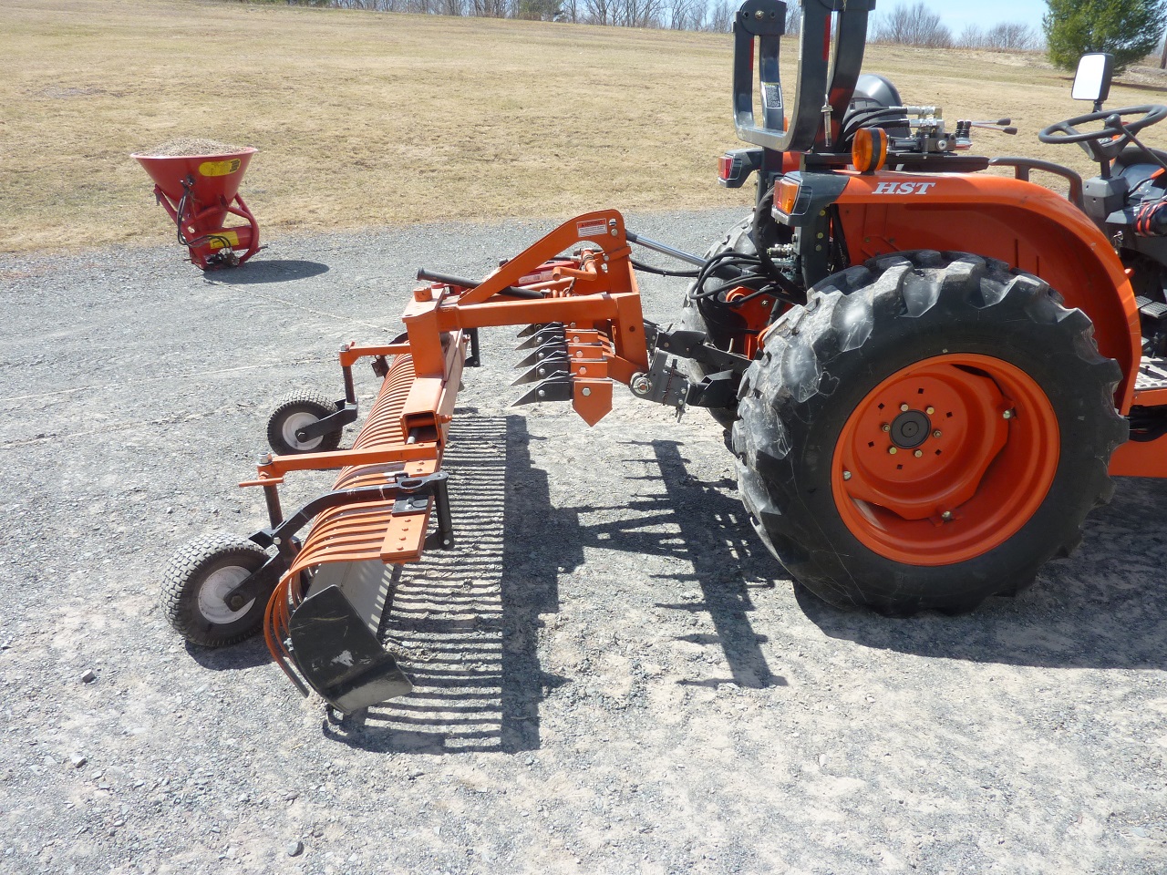

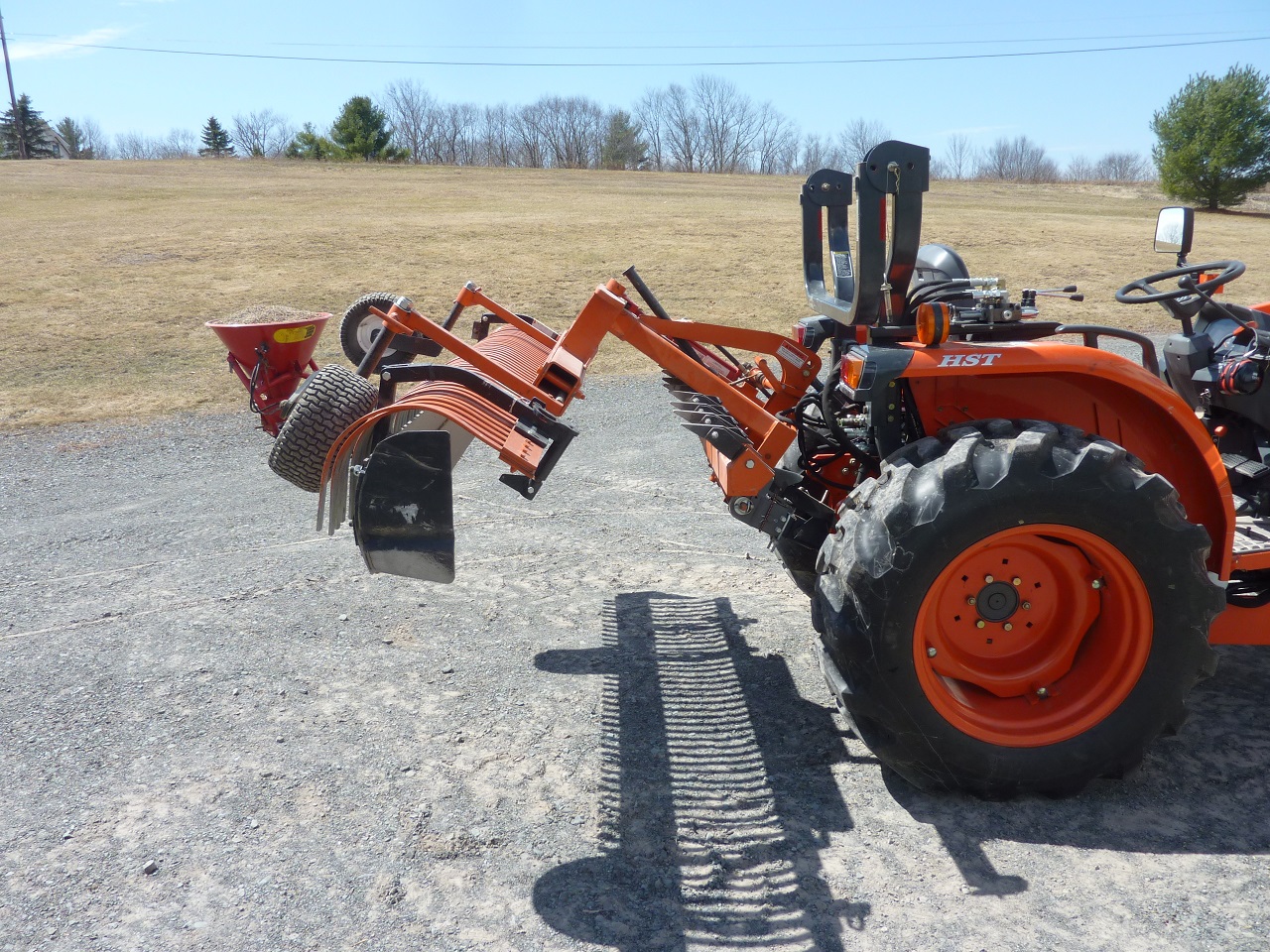

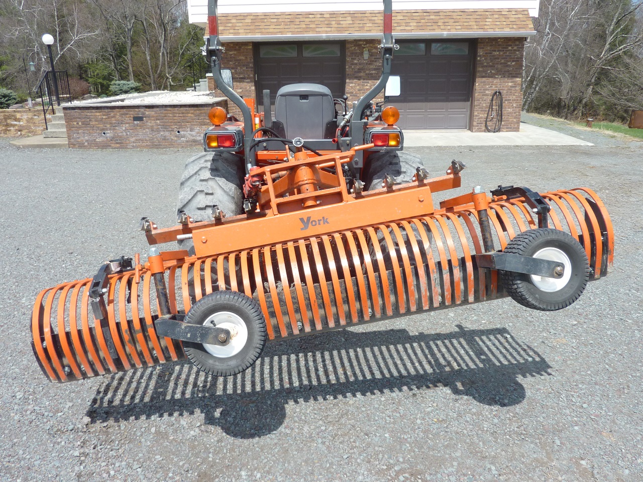

I bought a 7' unit for use behind my old L3430HST. I also invested in a T&T kit which more than doubles the usefulness of the rake. I maintain 1.25 miles of gravel road and several 400+ foot driveways. The T&T allows me to clean the ditches and put a good crown on the road surface. IMO, gauge wheels are a must for maintaining a smooth even surface.
At full angle, the 7' York is about the same width as the track of my new MX5800HST with R4 tires. Were I buying a rake for this tractor now, I'd go with an 8' unit.
Initially, when I bought the MX, I was going to sell the 7' York and get an 8' model. Instead, for a variety of reasons, I bought a second tractor. I picked up an L6060HST on sale last spring. The L6060 has a narrower track than the MX and works well with the 7' York rake. As a bonus, the T&T kit I bought for my old L3430 does not fit the MX but works fine on the L6060.

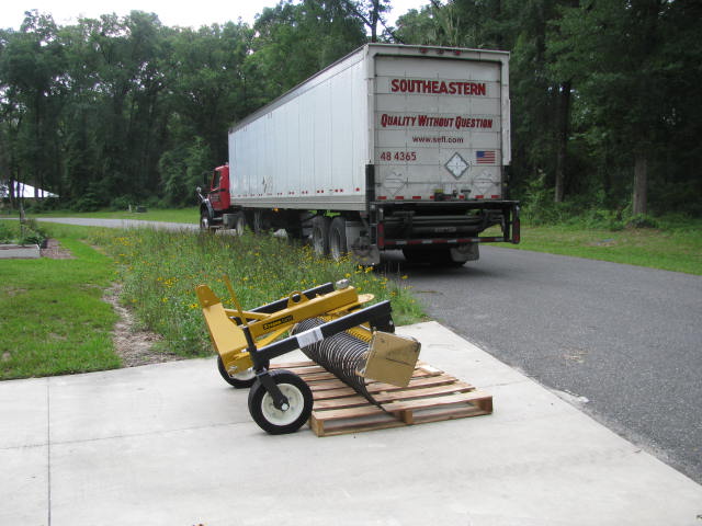

So after more research, this is prob. the LR I'm going to purchase. What do y'all think of it? Also... are the gauge wheels a put on & leave on kind of thing or are they simple to remove should I want to?
