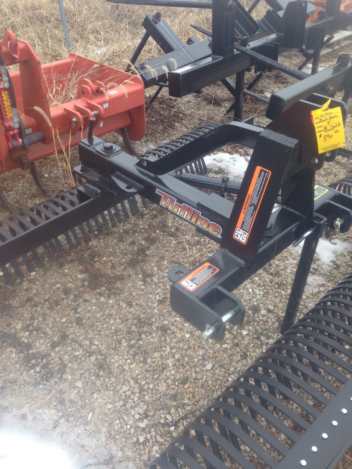

Still not decided on which rake yet, looked a a Tufline at a local dealer, really nice and heavy except for the tine bar, and it’s a piece of angle , thick angle but still angle. IMG_0042.JPG

Can you weld or have weld on another angle iron to the exiting angle iron stiffen it up on the tuffline model you liked ? Should not cost that much and your going to have it loaded anyway to get it home.

Yes I can weld, I’ve even toyed with the idea of building my own from scratch , but just not sure I can commit the time right now with all the other things I’ve got going.
