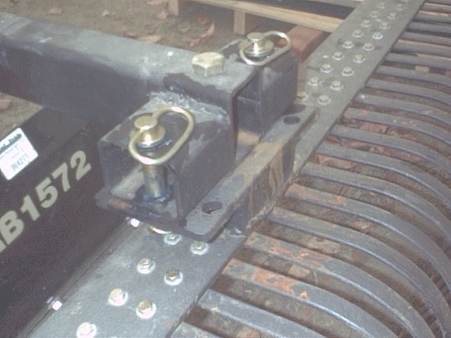

Just mount them 2" on center with 3/8" grade 8 bolts. My rake is super heavy duty and those tines hold up just fine.
I believe they are the same ones used by Woods, Landpride and several others.

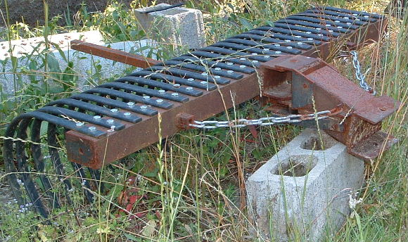

Do you have any photos you can post? Thanks.
   / Landscape rake tines #6
Ok, here is an attempt at a picture attachment. I built this rake a few years ago for the sleeve hitch on my sears 27HP garden tractor. With the mower deck removed, it was not too heavy to lift using the main lift lever, but it was pretty heavy. because of this I had to keep the hitch short. A consequence of this is that the lift lever didn't lift it very high. Far enough to transit, but not far enough to clear a load of trash. I added a latch assembly to the middle and by pulling up on the lever that sticks out through the middle of the tines, you can lift the whole tine rack up 90 degrees to allow you to drive away from a large pile of debris. It also swivels about 45 degrees left or right. The chains hold it at the desired angle. I mainly built it to haul in the branches I was trimming from the lower 8-10 feet on the trees on my property to reduce the fire hazard.

Thanks! Looks like you built it right. /forums/images/graemlins/smile.gif
