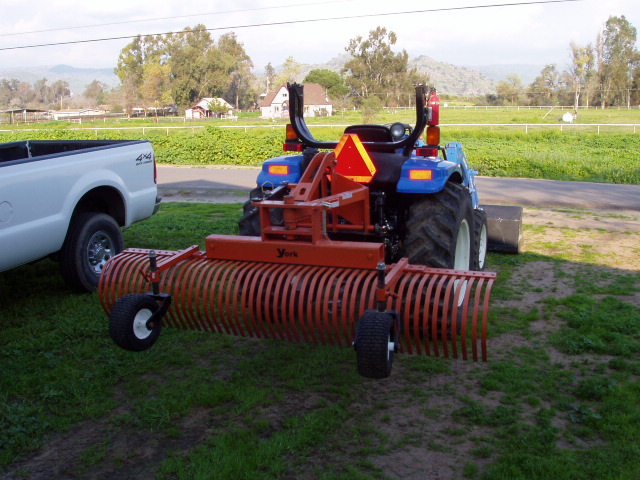

They do just what they are called, gauge the depth of the pass and most importantly keep the rake from gouging in when the tractor rolls through any humps or depressions, unlike what happens when a 3-pt blade or box scraper passes over the same ground. There is a thread in one of the sections that pertains to building your own set of gauge wheels.
To me, they are a must and I think the implement companies that build them are "gouging" us in the way they price them a la carte. My 8' York rake came used off of Craigslist and included the gauge wheels. I've operated it both ways and the difference is huge with the gauge wheels down but if there comes a task where the wheels are not needed, slide them up and out of the way. Buy them or build them.
