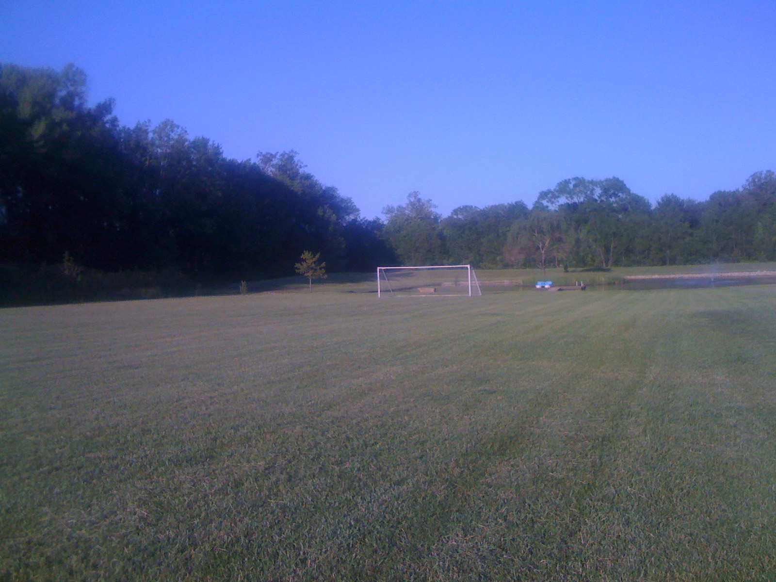

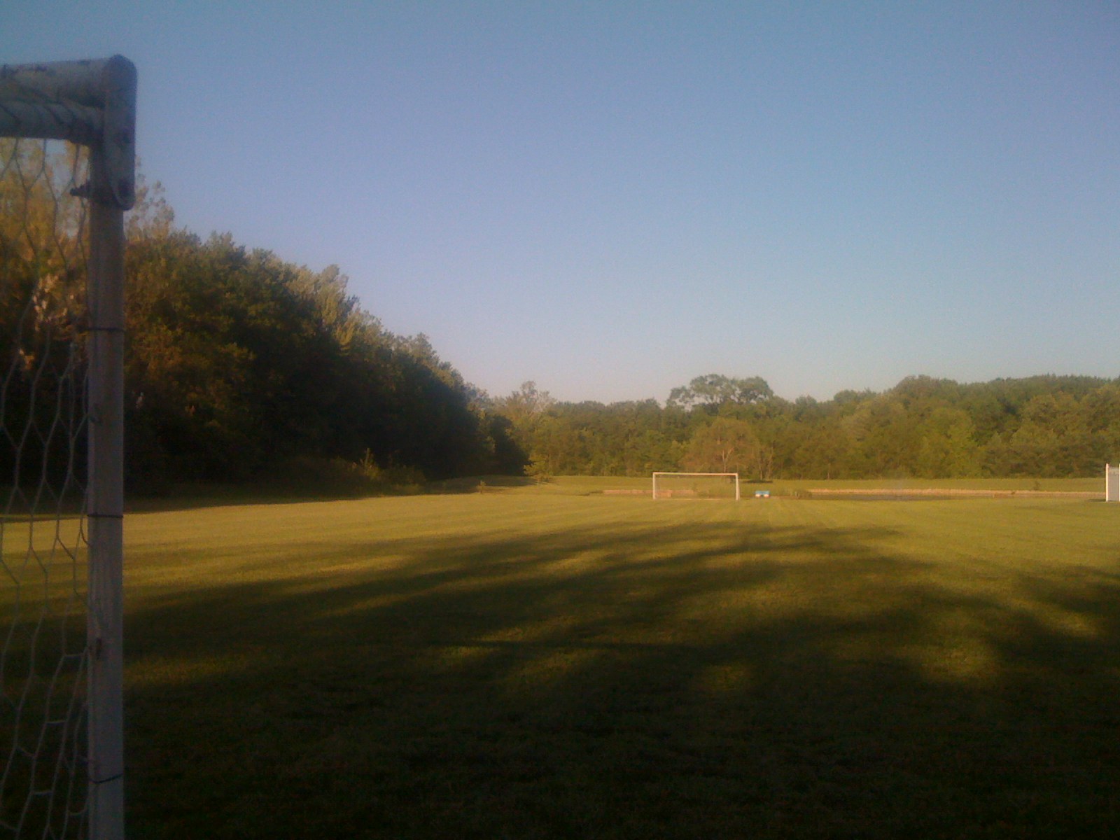

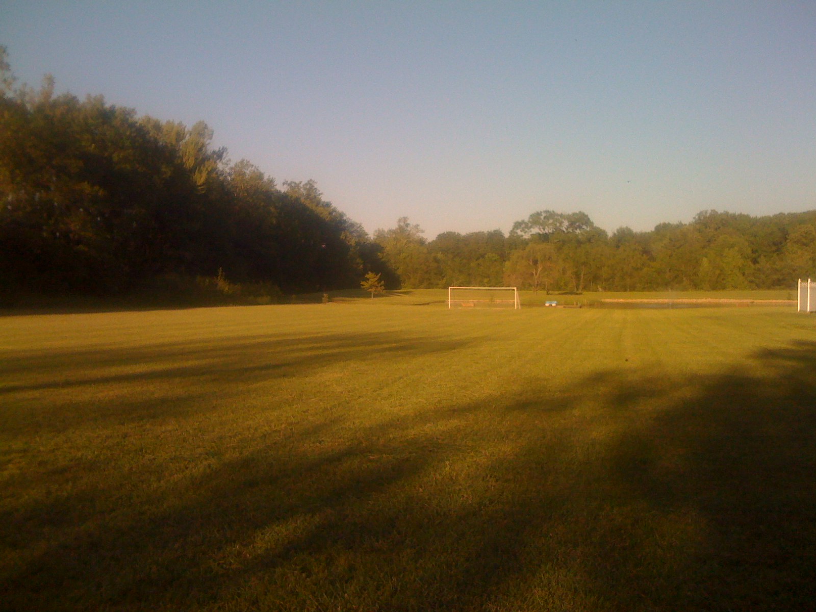

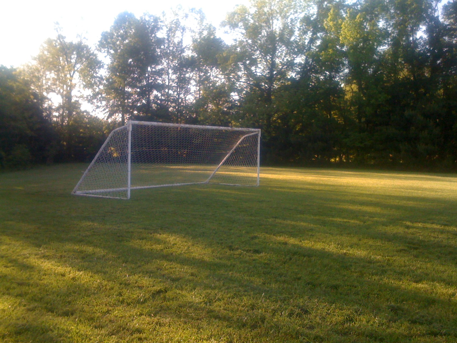

As I briefly mentioned in another post, I bought a cheap Leinbach pulverizer several years ago for a job. I was planning on buying the Gill brand, but there was an absolutely huge difference in price. As long as you don't have loose grass laying on top of the soil, a pulverizer works wonders. In doing soccer fields (I have one in my backyard that two teams practice on) I've found the pulverizer to be the perfect tool to use right before seeding and then using my cultipacker right after seeding. The pulverizer will make the difference between a lumpy, bumpy finish and that similar to a fairway.
The attached pictures show the field in my backyard that used to be a humpy corn field. Our city charges teams to use the city soccer fields for practice and some of the girls' parents can't afford to pay the team dues needed. Since I had the land and equipment I welded up some regulation soccer goals, had a company donate the nets, and put in a regulation size soccer field. The only expense to my daughter's teams to practice here all year is for the team to cover the commercial insurance policy holding me harmless from any accident that may occur there. Anyway, without using a pulverizer, it wouldn't be possible for me to have put in my soccer field as well as a few others. The Leinbach is inexpensive but has proven to hold up well as long as you keep the bearings greased.
