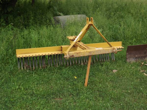

I "think" I'm in the market for a landscape rake. I can't find anyone who has one, but I basically just need it to scratch up the ground a bit so I can get some grass seed in the soil. I also have a few places where I planted grass seed and it's lumpy etc, so I thought this might help level it a little. I should also state that I'm not picky on my yard.
I don't see myself using this a lot, so I was trying to find the best deal (price wise) to buy one. I don't need to have a real wide one either. It would look goofy behind my MX5800, but for an implement that I might only use a few times this year, I'm okay with a light duty unit.
I've had zero luck on Craigslist finding a used one. I guess anyone who has one, keeps them.
Best option to buy one? I'm surprised that even the cheapest one at TSC or Rural King is $400.
/ Landscape rake on the cheap (price)? #2
Agri Supply had the best price when I got mine.
/ Landscape rake on the cheap (price)? #3
A quick look on CL this morning shows this: 00t0t_h2kNWGvCd91_600x450.jpg
York Rake - farm & garden - by owner - sale

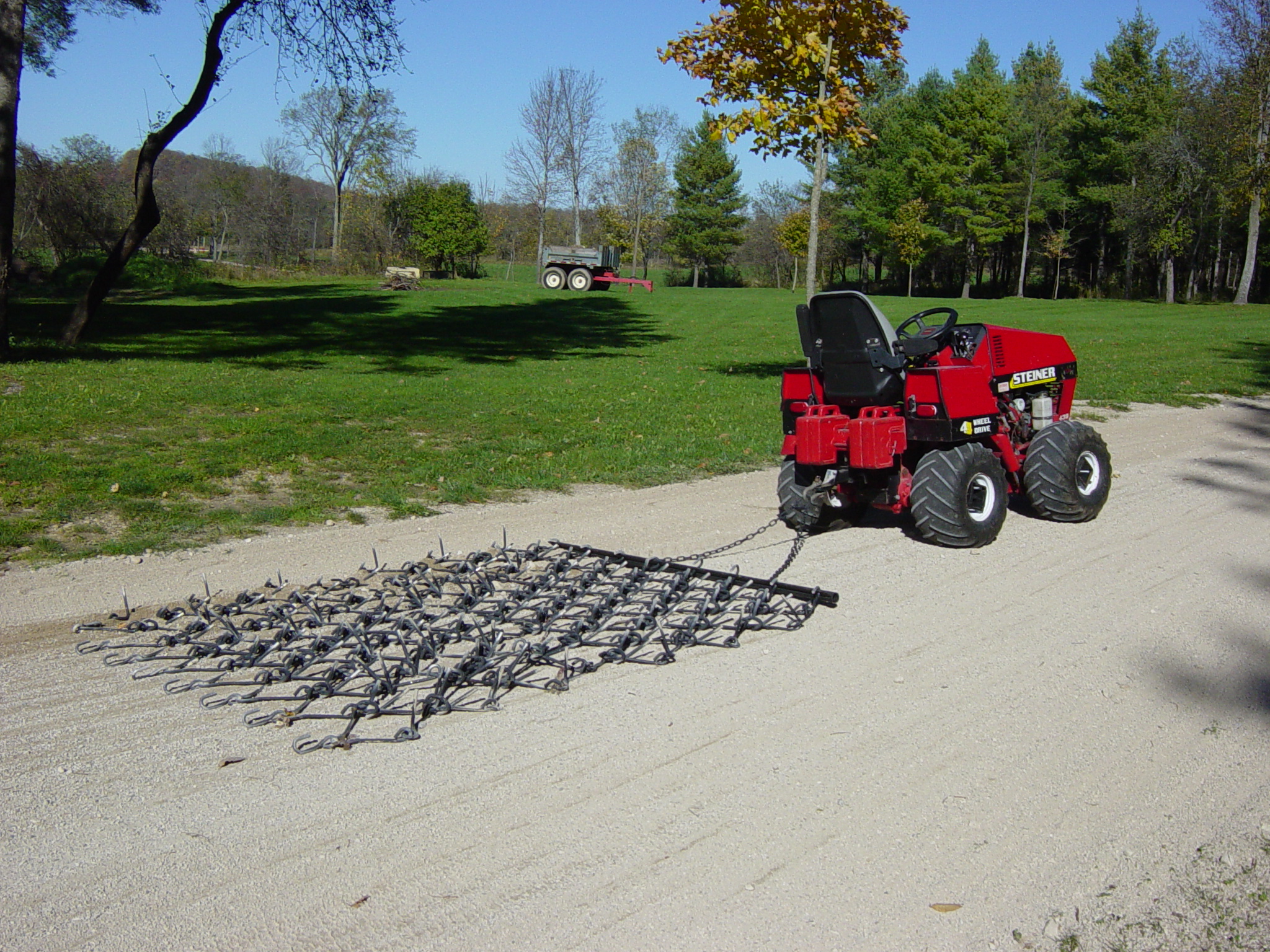

For scratching in seed, have you considered a drag harrow?

I'm not sure if a drag harrow would work for me. I had some dozer work done last year and it's packed in there pretty tight. I ran the neighbors 5' disc across it last fall but it just made larger clumps.
Nice find on the York Rate. I'll see where they are at.
/ Landscape rake on the cheap (price)? #6
Sounds like you have some heavy clay. Perhaps the York rake will work. Maybe a toothed land plane is what you need.

I bought a Loyal drag harrow last year from TSC. A smaller one for the Steiner. It is quite aggressive when used with the tines down. Still a bit pricey for what it is.

Most drag harrows have three different settings, flat for covering/flattening terrain, medium tine for light work and if you flip it over max tine (on mine) the tines go down about 4 inches when in max setting and will wreck the ground
