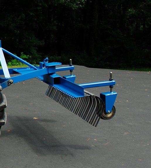

I bought a rake at our local farm store with no wheels. It would dig in going over the low and high spots. I ordered wheels from a different brand at the Ford dealer and welded them on and repainted to match my Ford. They made a nice difference in grading my gravel trail.
I have since added a piece of indoor/outdoor carpet to the front to keep the gravel from beaning me. They come out of there like a sling shot.

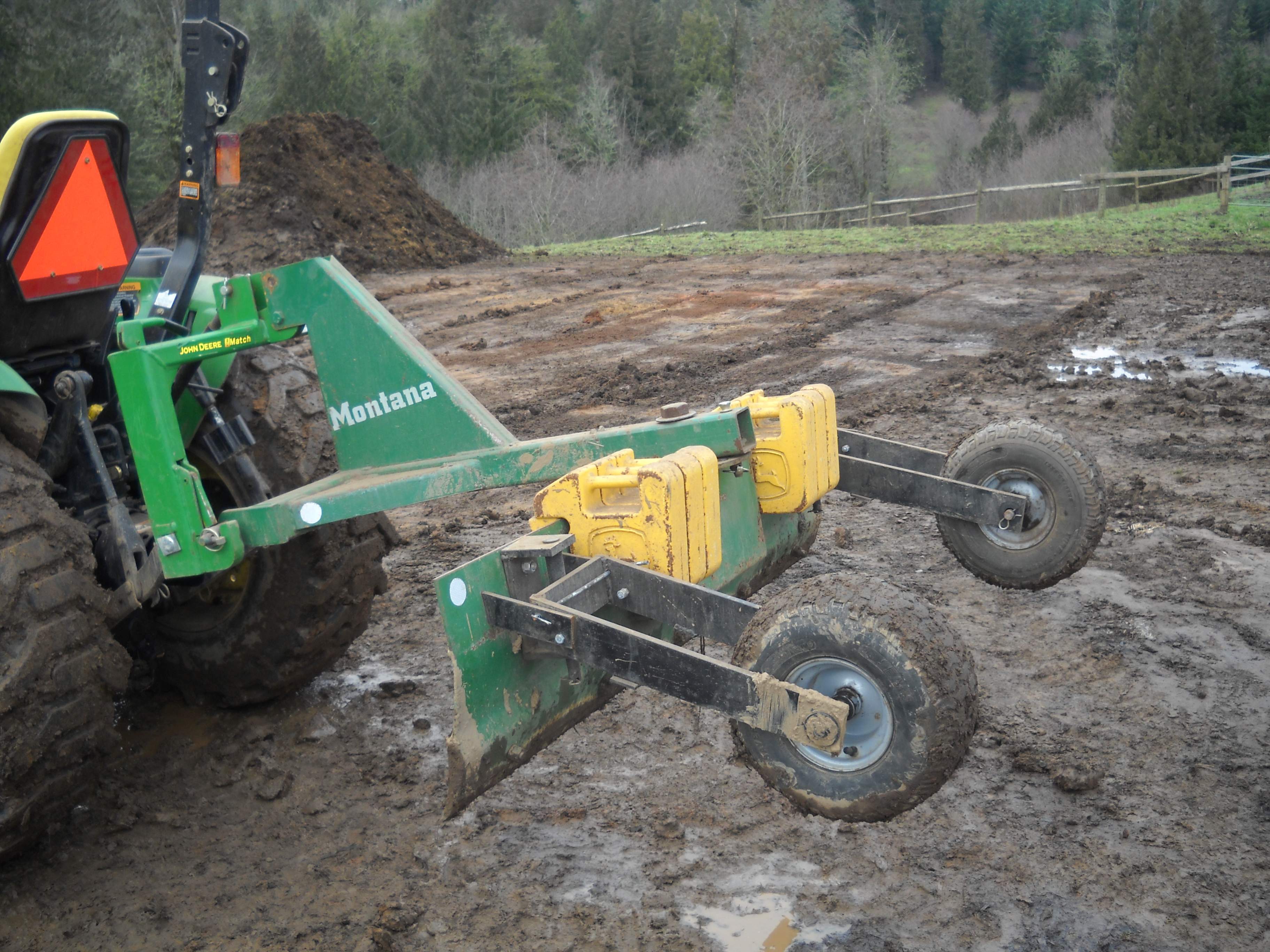

I have thought of making some for my landscape rake but haven't since i have some on my rear blade. they are a very very useful addition to my rear blade, it allows me to plow snow without digging to deep, grade gravel and let some under the blade, and more precisely grade. They also area great parking stand when rotated in reverse and I also can hang 6 JD 40 pound weights to the blade now for ballast and digging force. Mine can be locked in forward mode or I can simply pull a pin and unlock the wheels so they can run straight when the blade is angled so the tires wont wear down. :)
