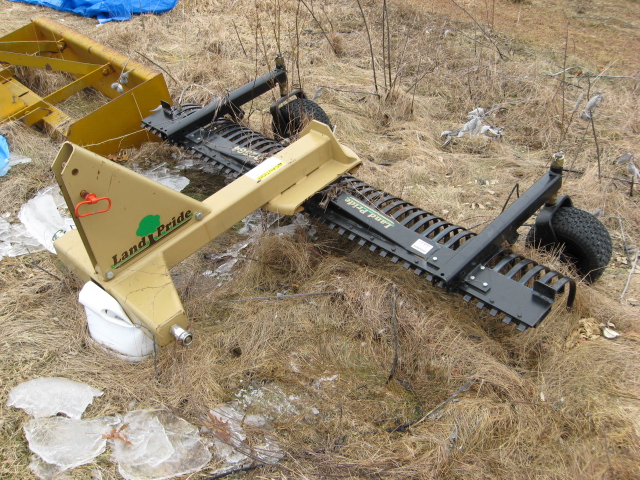

I have a 7' (2584 model) that I will be selling. It is 1.5 years old and has been hardly used. Email me at jrlandscaping781@msn. if interested
Now I see why the KK guage wheels are only $200 vs $350 for the landpride. The landpride is way better built. Rather than tubing going from the rake to the wheels, the KK has what I believe is a 1/4" x 2" bar, but I'd have to measure to be sure.
