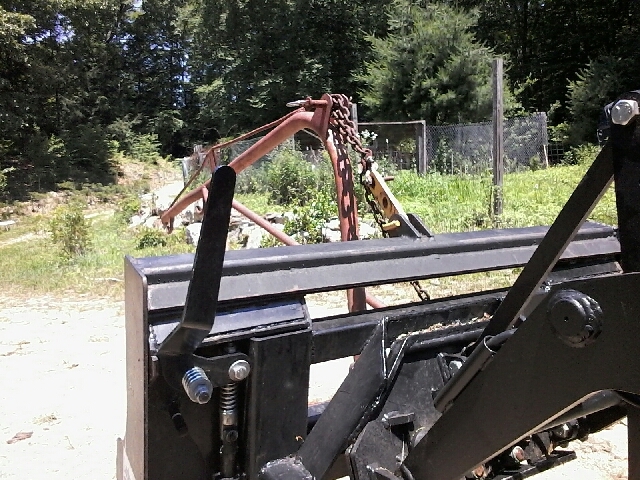

I have found that over the years there are a lot of 3pt attachments that I wanted to use on my Power Tracs. I made a PT to Skid Steer adapter, which is one of the most used accessories I have and from there I bought a Skid steer to 3pt adapter. Gets a tad bulky (and you could just weld your plate to the 3pt adapter) having multiple adapters, but it actually works good. If you think you will be satisfied with just the rake, go for it! Or look to the future and use an adapter. I attached a pic showing PT to skid steer to 3pt with a 3pt lifting boom mounted.
You could look back at my previous post to see more if your interested.

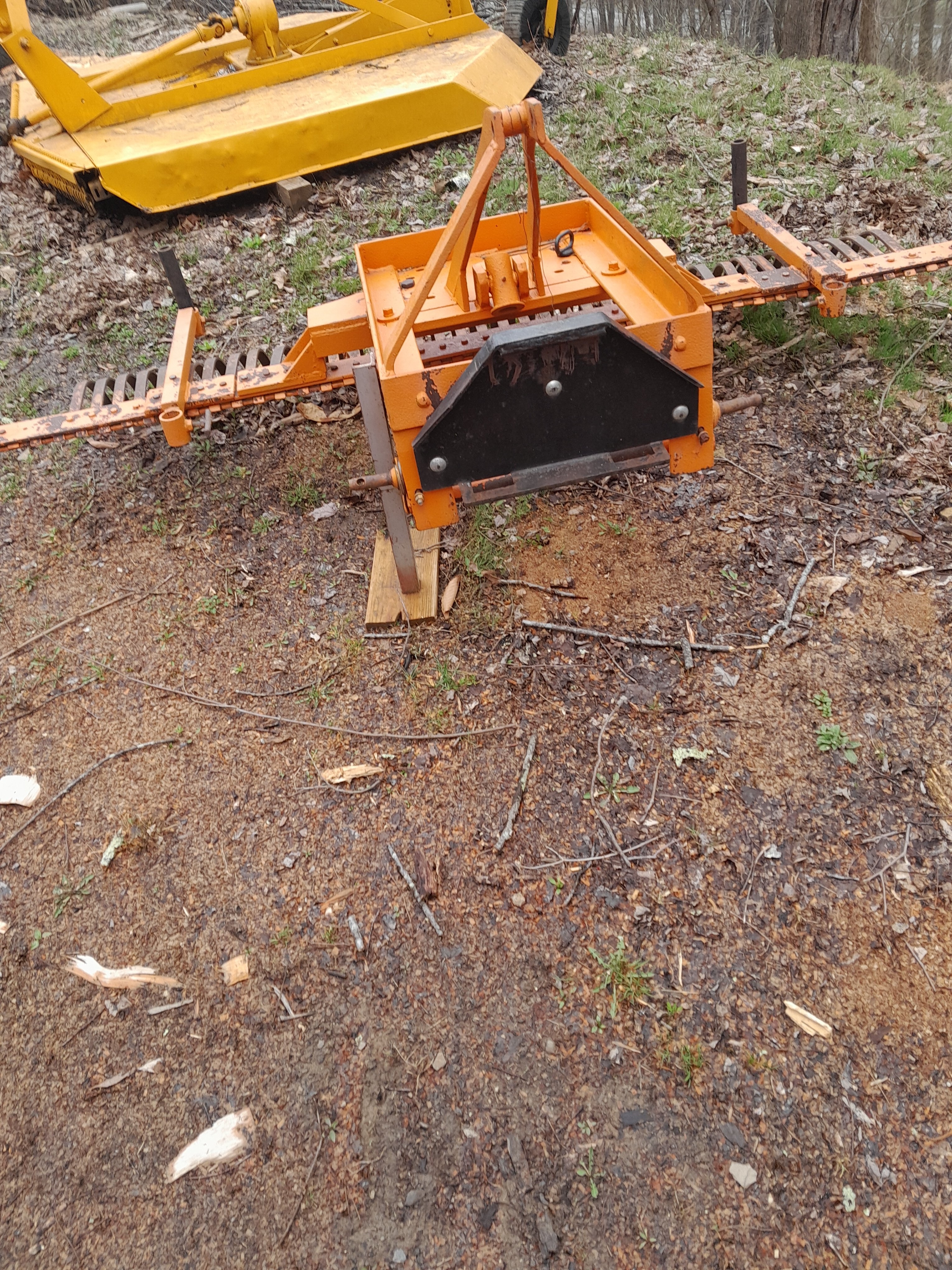

Here is my setup for a york rake can use it with my farm tractor 3 point hitch or my power trac's
