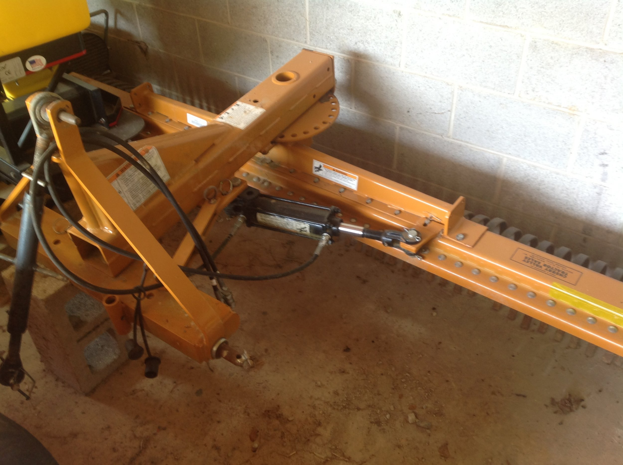

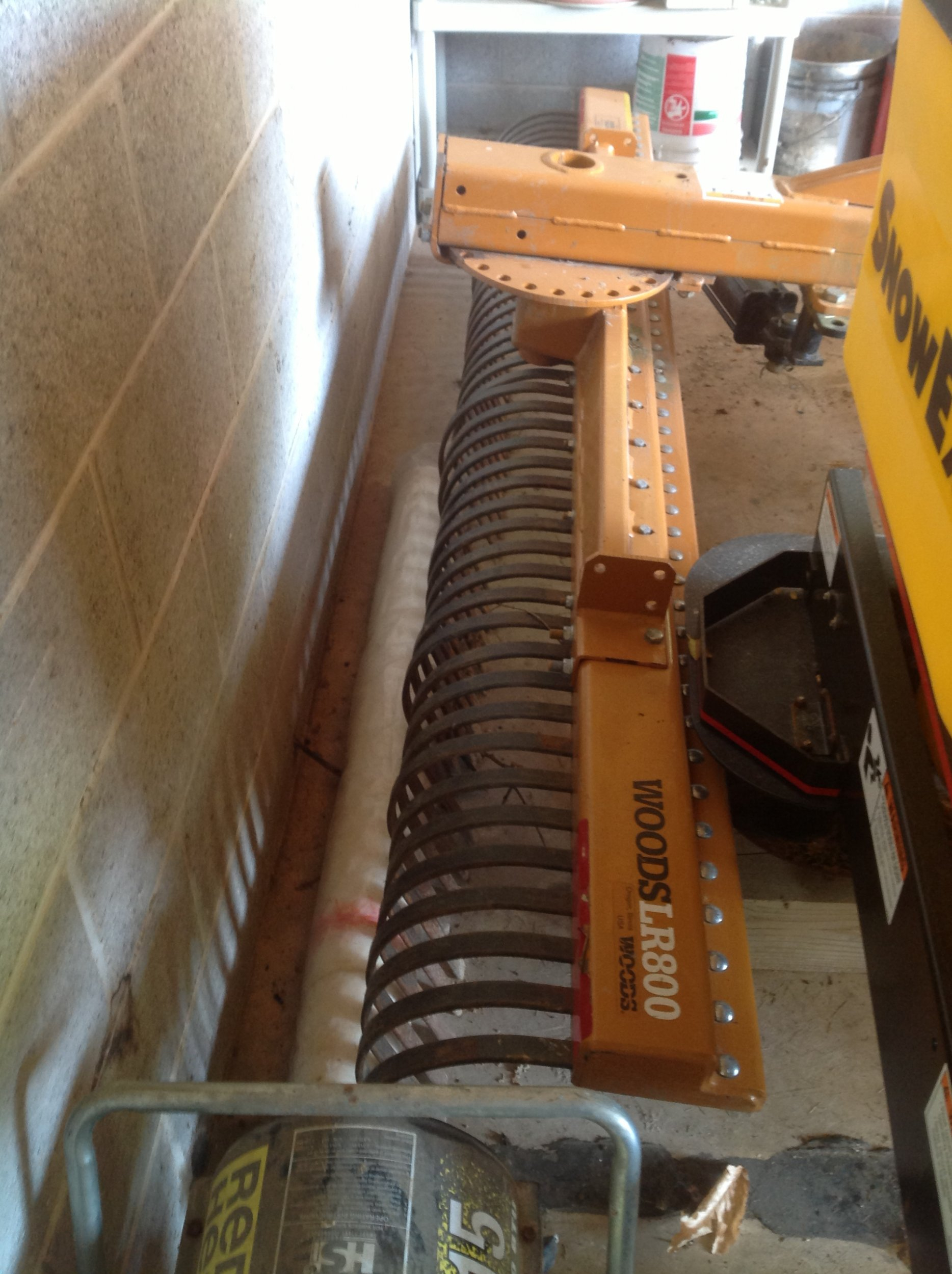

Woods makes a nice rake, too. Remember if you go wider, you can always angle the rake to make it narrower when passing between trees. Get a hydraulic angle cylinder and it can be easy to do from the seat.
Here's my Woods 8’ power angle rake.
I used this rake behind a 126HP tractor and never broke anything on it, so it should work for anything smaller than that.
You can also accessorize the rake with a flip down grader blade, which I should have done.....
