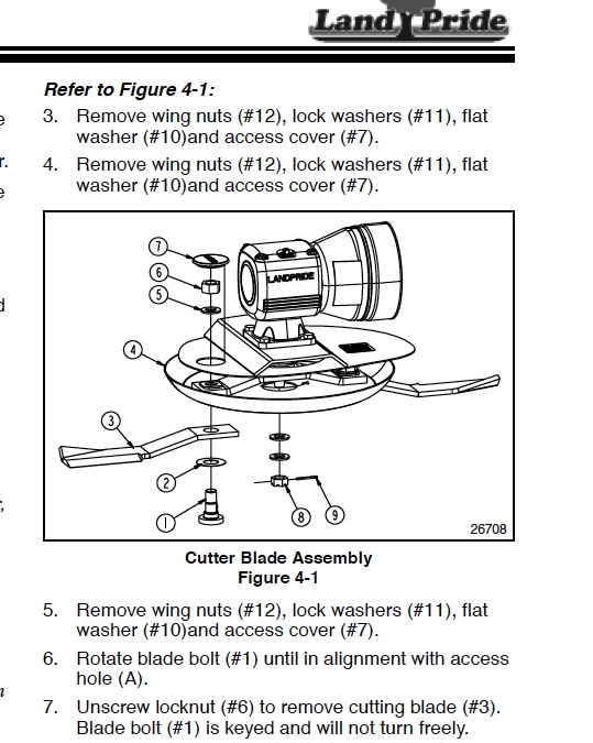

Time to take the blades off my LandPride RCR-1548 for sharpening. The manual, though, seems to have a misprint: Steps 3,4, and 5 are identical, and they refer to a figure with completely different labeling.
I'm hoping someone has an older edition than mine and can tell me what it's supposed to say. (Mine's just like the version online.) Or if you can assure me that there's no safety-critical information in the missing steps, that would be just as good.

I suggest you contact Land Pride. I'm sure they'd appreciate the "proofread" since an incorrect disassembly/reassembly could cause damage or injury.
At the minimum, they could pull that manual offline until it's corrected.
I have a Land Pride cutter. I'll dig out the manual this afternoon and see what it says. I have a scanner so, hopefully I can post the correct disassembly procedure.

I sent them an e-mail a few days ago. Maybe they'll answer when they get back from the beach.

You find the access hole in the top
you put a big impact wrench on the really big socket
and you run it out
then you whack the bolt with mallet/hammer/wood to knock it out of the hole.

Last night, I got an e-mail from LP. They've re-written the page, re-drawn the figure, and put a new version of the manual on line. I call that good service-after-sale. :thumbsup:
