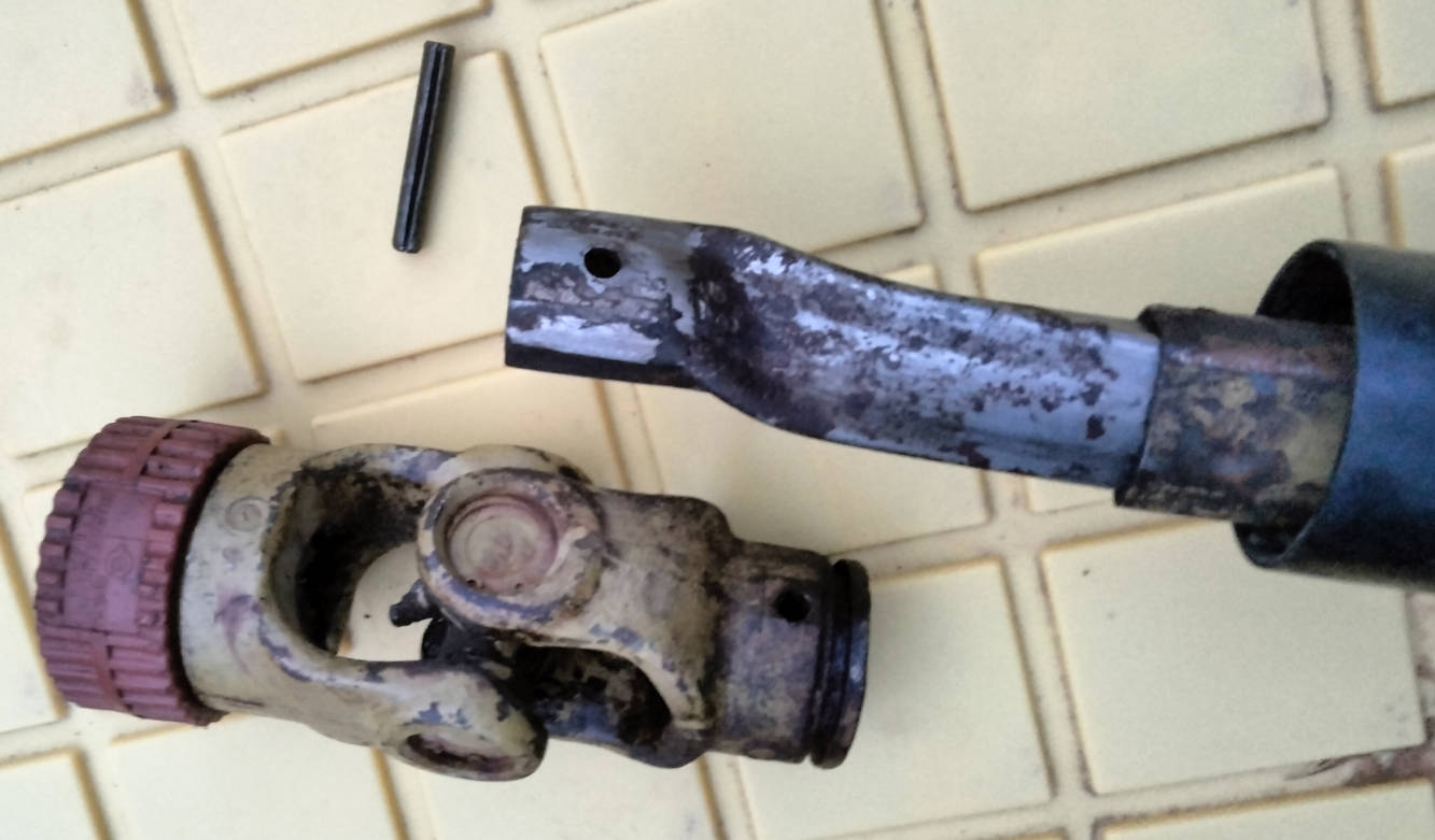

I picked up this PTO shaft at auction to get my flail running.
Grrr....
Anyway, I have to cut 6" off of the length to make it fit, but I was anticipating cutting my 6" off of the middle.
That is the reality of these auctions, one often gets a mess.
