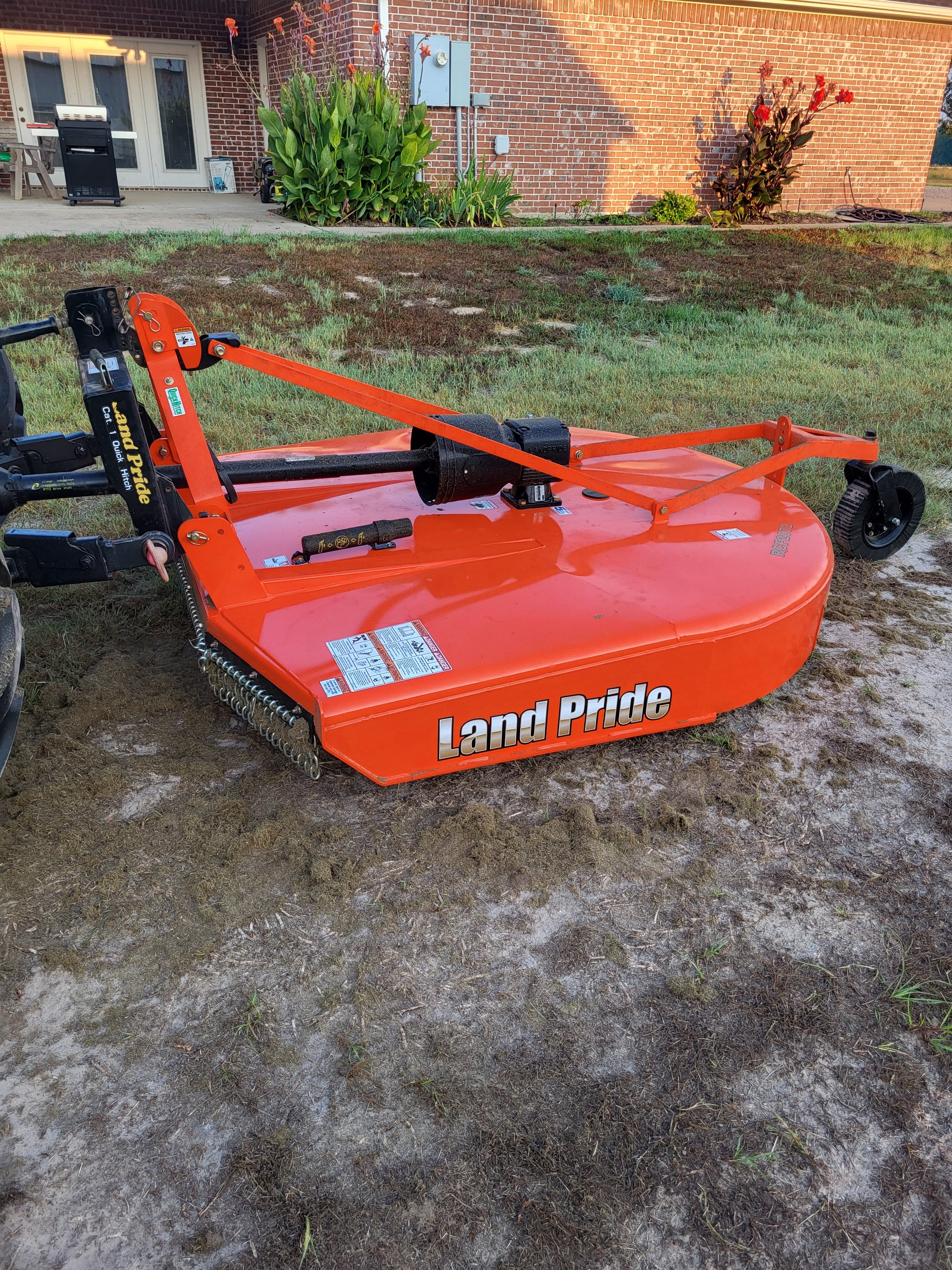

My land pride 2772 has been through hell and back. It has cut many trees up to 3" diameter, one at a time of course. It has mowed many acres of old pasture. It has not required anything but regular maintenance. Would highly recommend.View attachment 2643633
I appreciate your reply. I couldn't find many testimonials for the 2772, so your input helps me get the information i need to make a decision. Thanks!

Thanks for the reply. Do you find the 11" deck height to accommodate a larger amount of material while you cut? and also do you get a lot of build up in the cutting chamber since the supports are on the inside, instead of on top like in the 1872?
Mine has the solid rear instead of chains. I don't notice any buildup. It cuts everything I need, which includes Bahai grass. If there is something larger than 2" it needs a chainsaw. Hitting it with a rotary cutter would be tough on any equipment.
