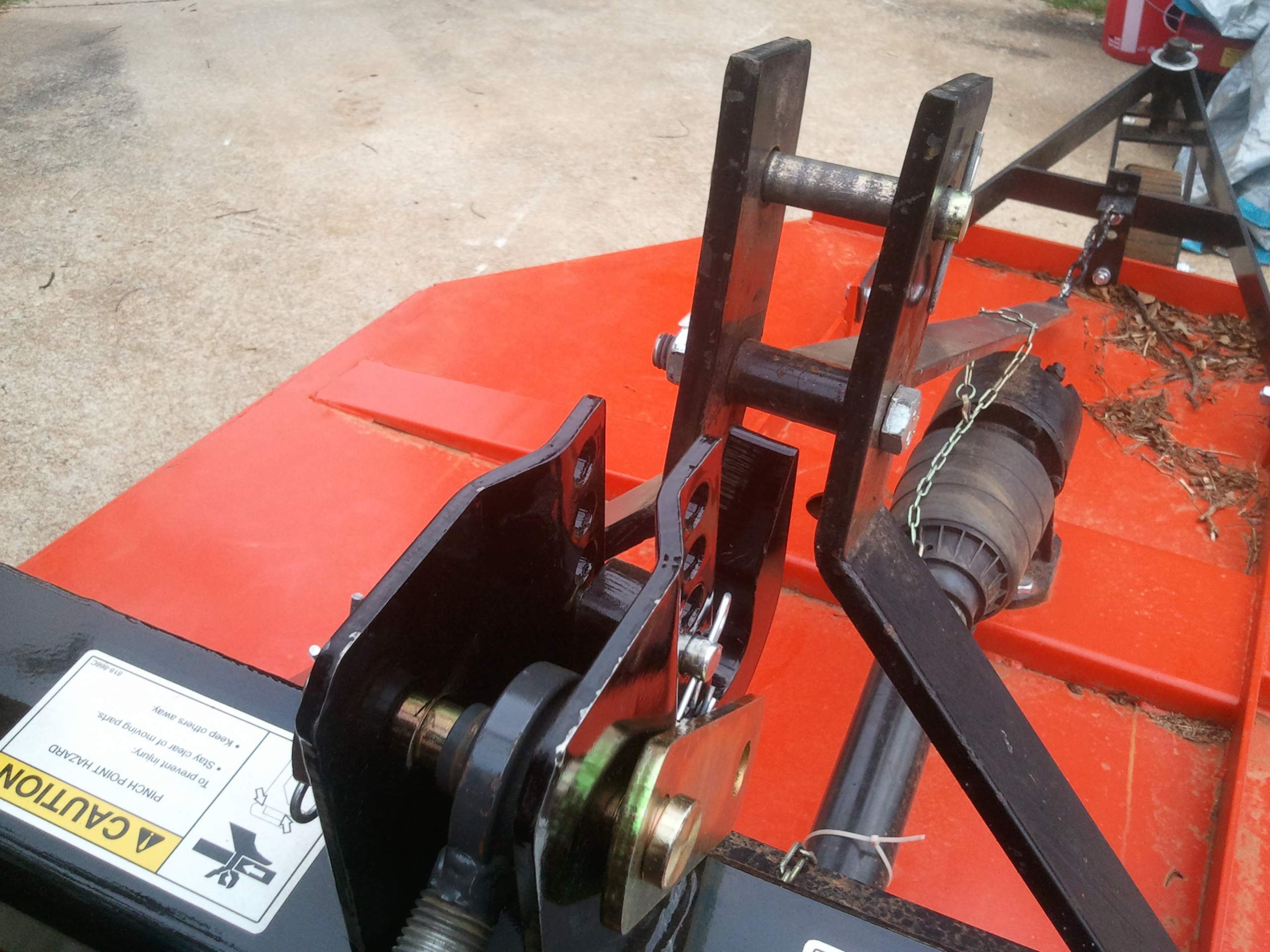

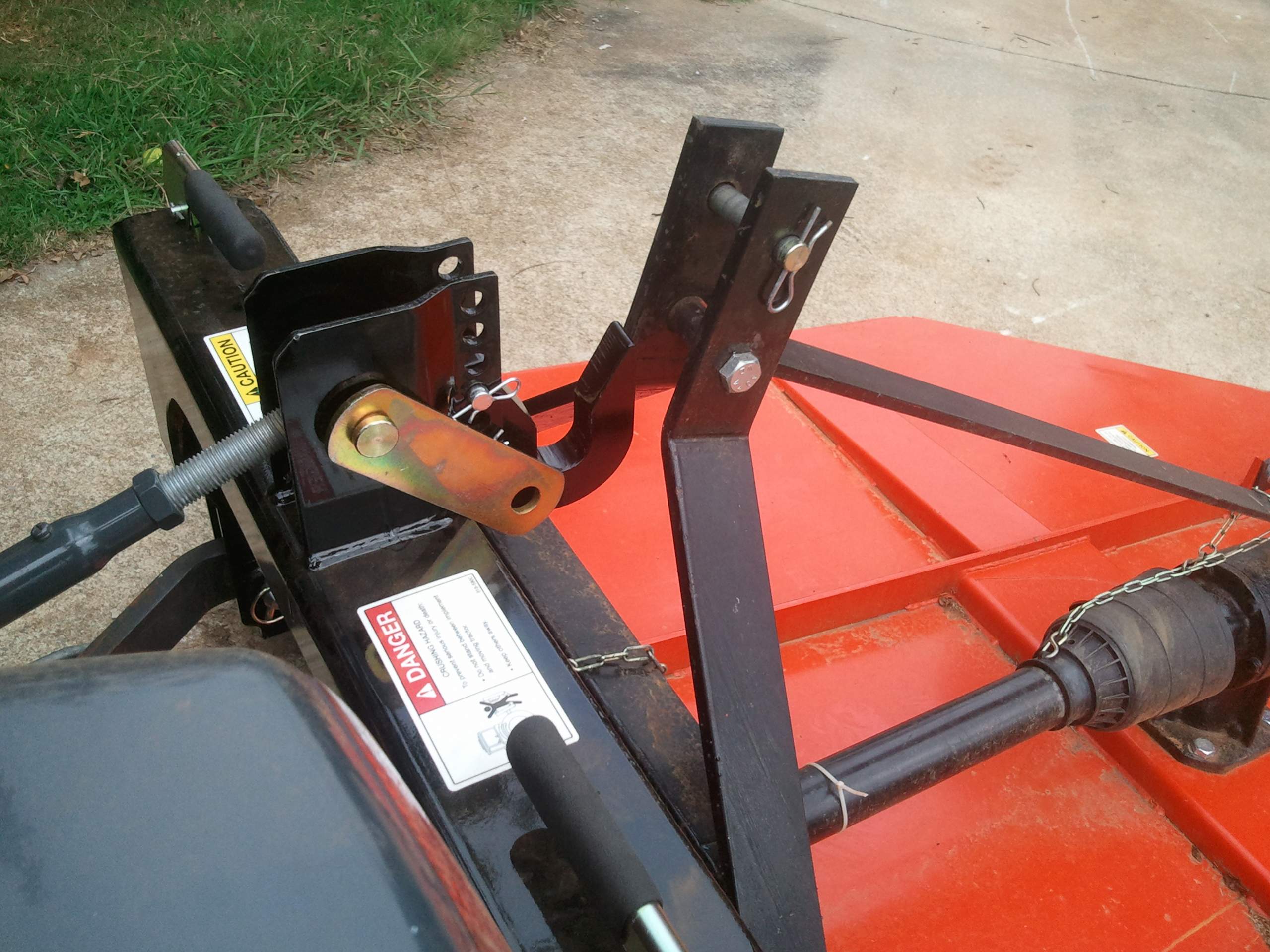

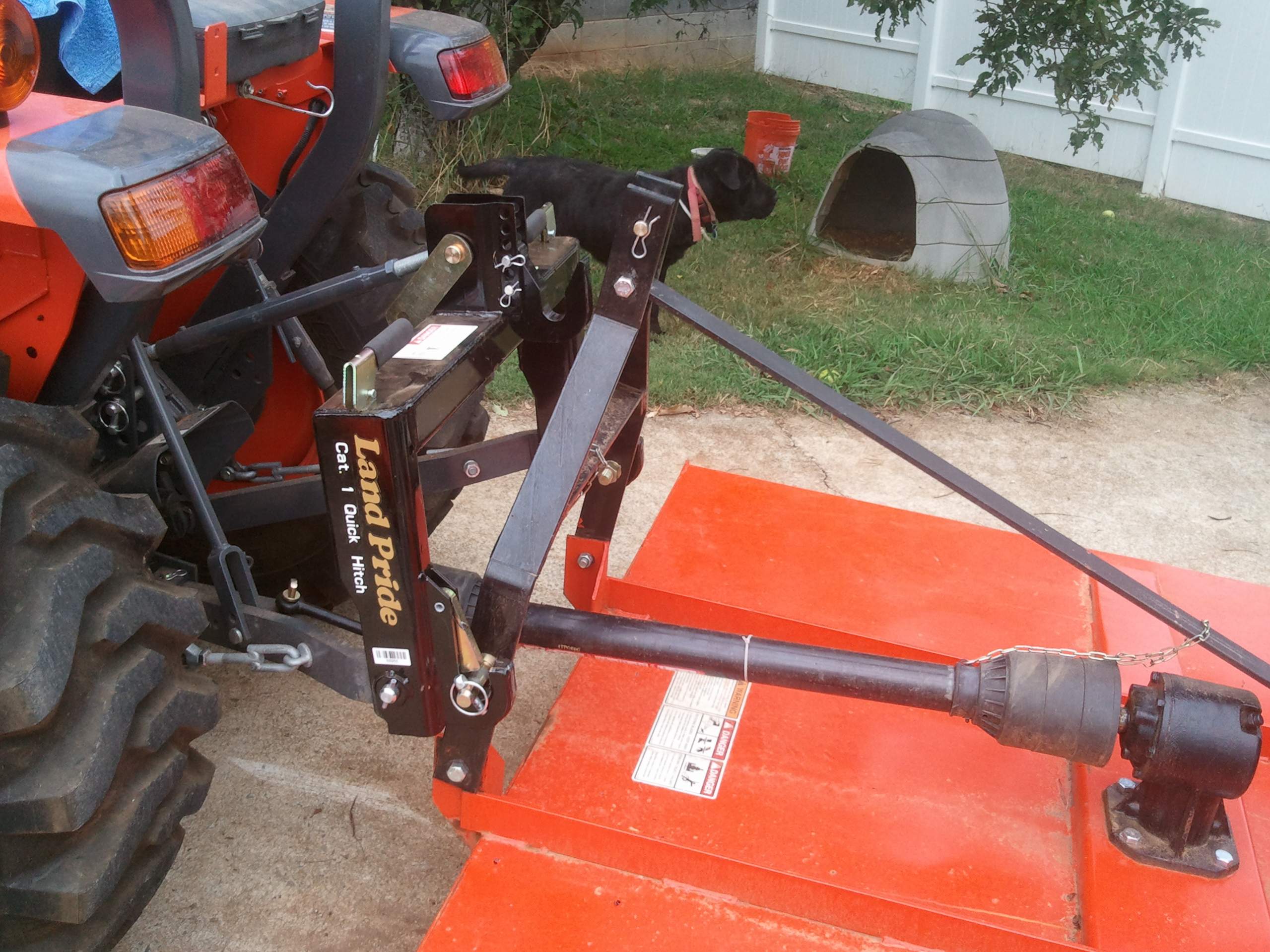

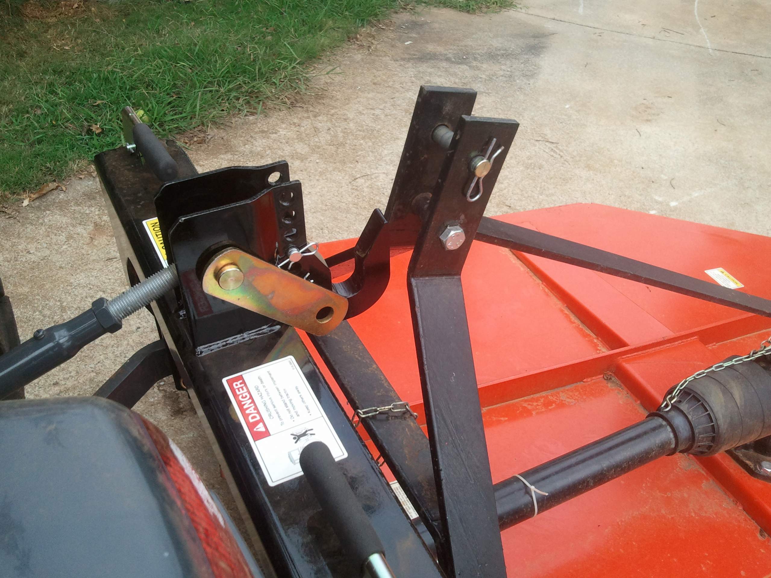

Attached are the pics. Perhaps the top link on the tractor needs to be more forward so that the quick hitch is leaning aware from the tractor some? Or do I just need to by another top link and attach it from the quick hitch to the implement?
The hook there will move as stated here but the gold piece on each side just won't stretch far enough. :(

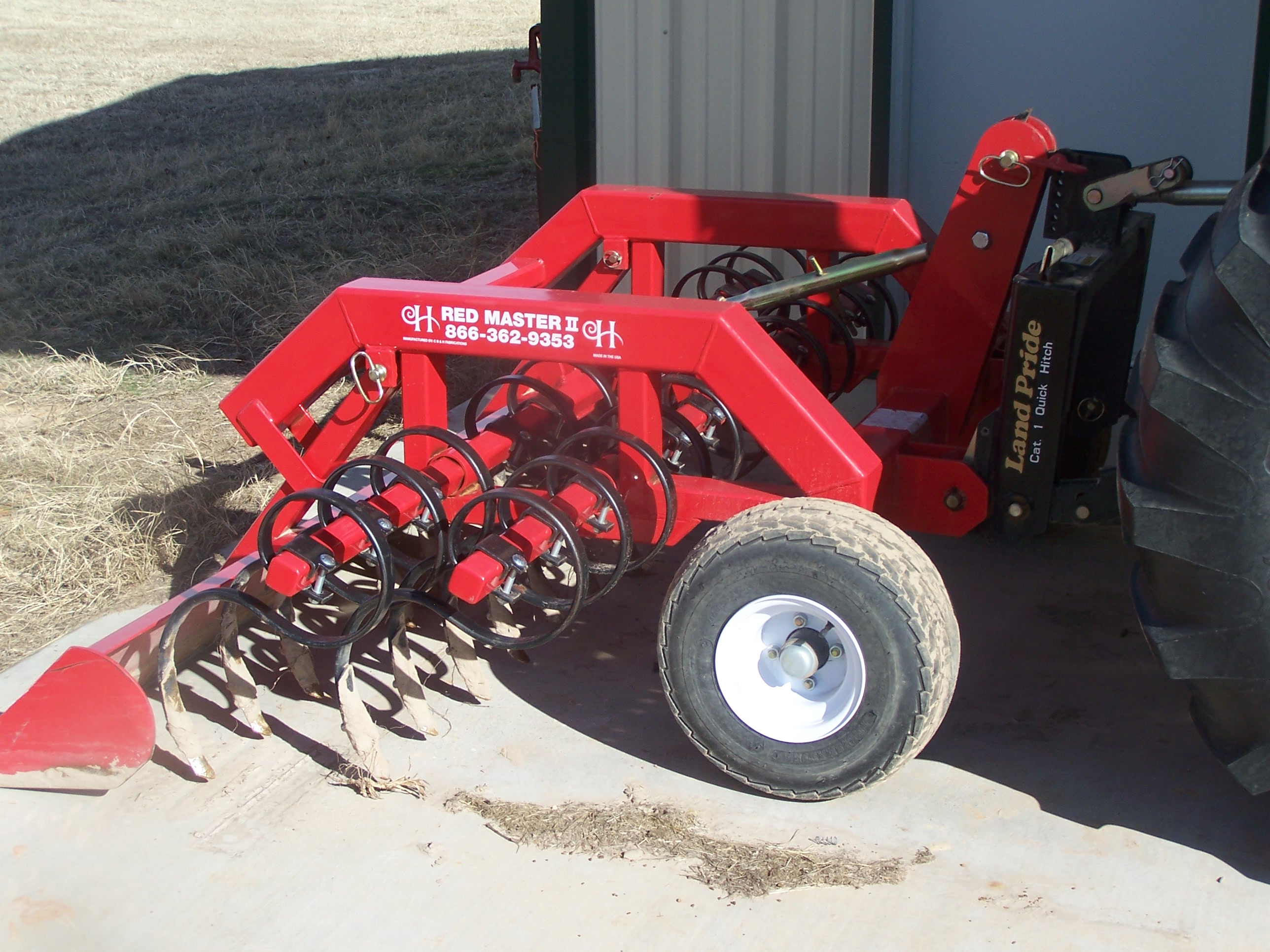

I have the same hitch on both my tractors. I have to change the tilt and the hook location when I change attachments. I sometimes have to remove the hook and slid it in thru the implement and then pin it in place. Here my arena drag behind the TC40DA.

I also see there are no bushings on the lower pins. They will tighten up your load and keep it from rattling and vibrating. I bought a set of the Landpride bushings for each implement so I don't have to move them around. They come in different lengths from 1 3/8" to 2" if I remember right.

geewhz01, If using floating top link remove top hook. You should have some flex at top hook for unlevel ground. You could also (I see you cutters top brace is weld cross wise on the bushing) Pull top pin out, move bushing/ strap to the top hole and use lower hole for top pin attachment since you QH top hook is adjustable.
