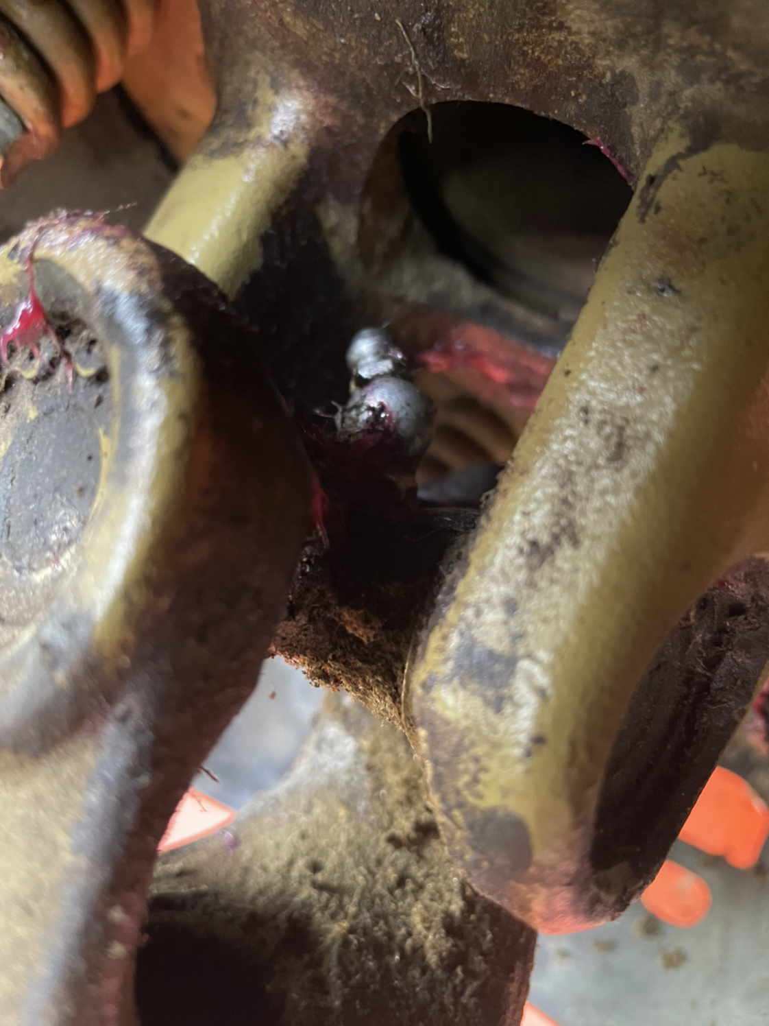

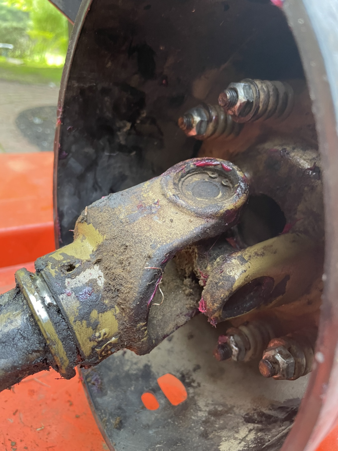

I just came across this article while trying to do the same thing on my RCR 1860.
I figured out how to remove the PTO shield, but even with that off, the angle of the grease fitting makes it impossible to get a regular grease gun on there.
Do I need a right angle for the grease gun? Any tips greatly appreciated.

See if you can get a small open end wrench in there and turn the zerk a few degrees so that you can access it when the knuckle is open.
   / Land Pride PTO Shaft - How to grease #8
Somebody must have thought that was a real funny joke there - Granite Tractor. The way that zerk is angled. I would remove that angled zerk and replace with a simple straight zerk. Then it will be a straight shot with your grease gun.

I share the frustration. Pictures don’t do the situation justice. I have an ag Meir shredder and no way can it be greased with the guard on. Not with the slip clutch in the way as well, and don’t talk about angled or straight zerks - I tried 90, 45, and straight all turned at various directions. No joy. (I did find one angle that worked - with extreme difficulty - but it was so loosed by the time I had used it 6 hours the zerk was gone).
Manual says grease every 10 hours but it takes 2-3 hours to take apart to do so.
My solution - for me and my situation - was to take a razor knife to the cover and cut a big a$$ hole/slot in it so I can grease the thing. On each end. Now I have a ton of exposed rotating elements but at least they are greased.
