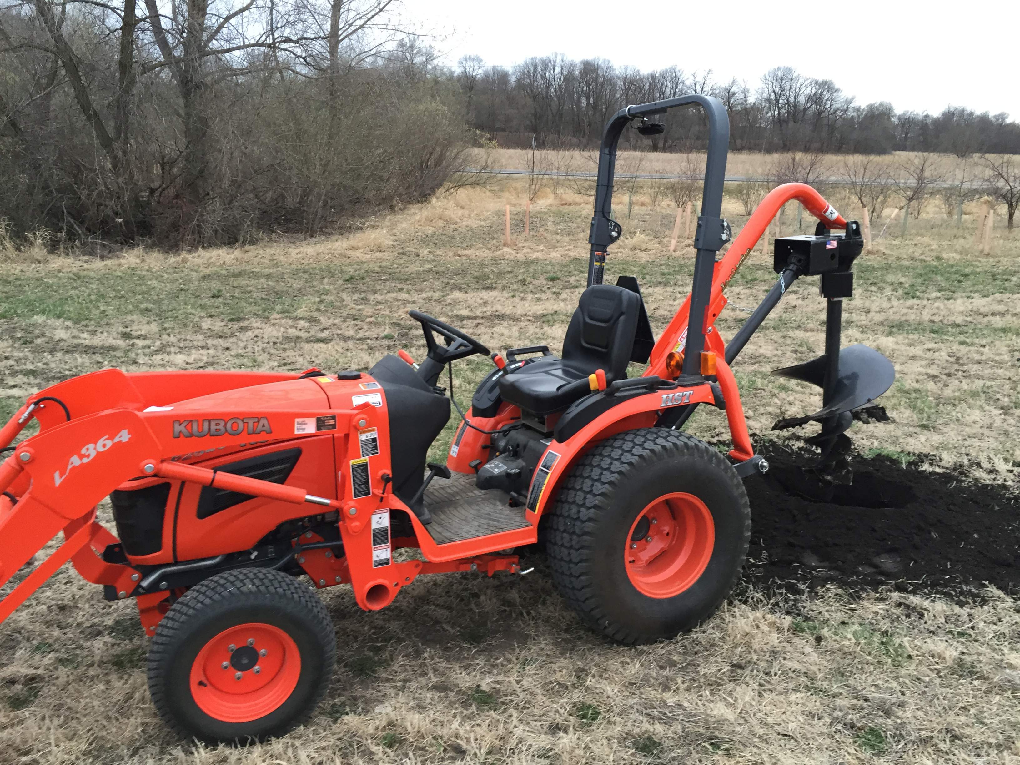

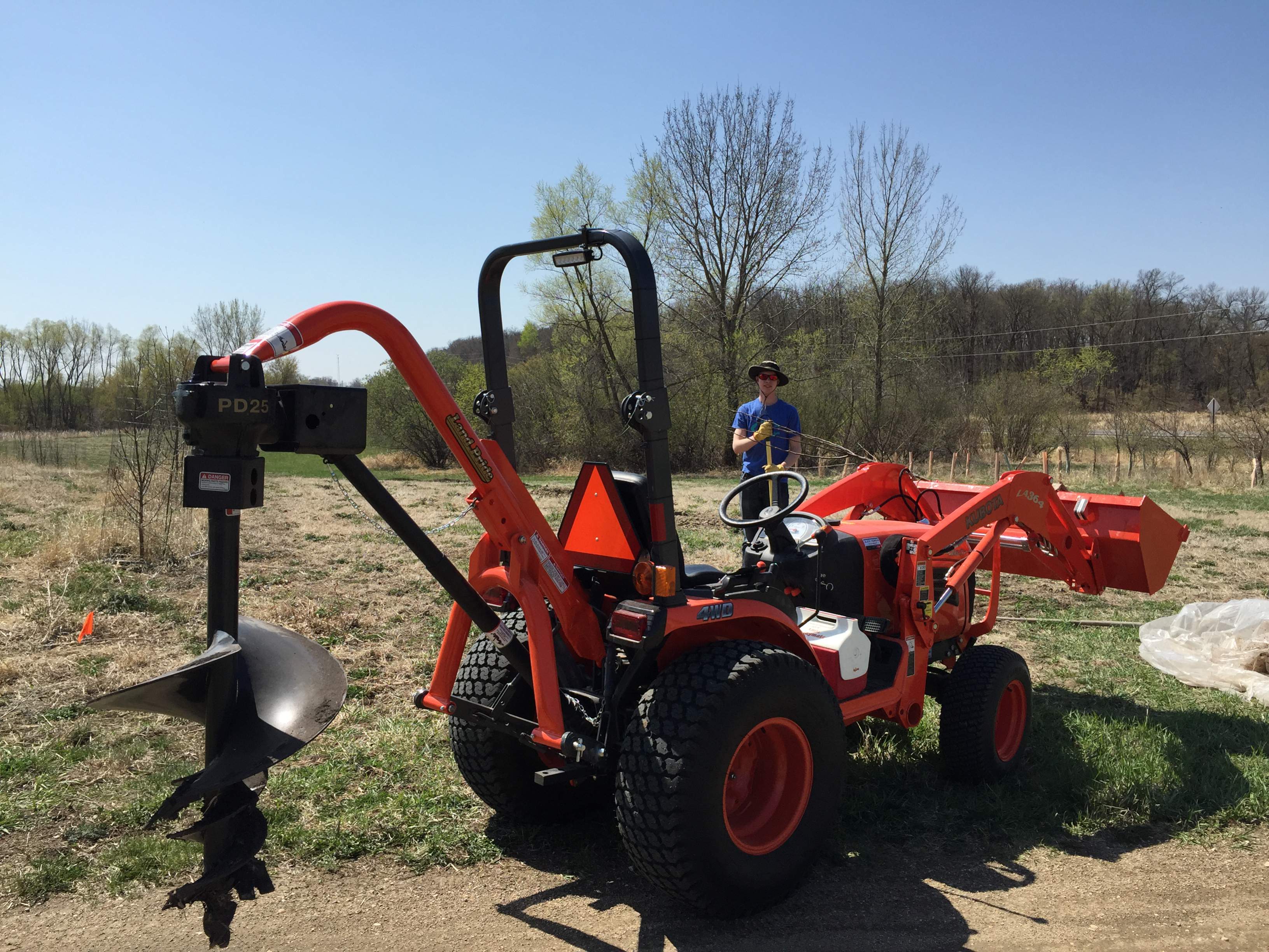

Does anyone have a plan for a homemade storage method for the PD25? Or any post hole auger? I don't feel like buying a flimsy stand.
Below, video I made of my B2620, with a PD25 & 2 foot auger, planting trees.

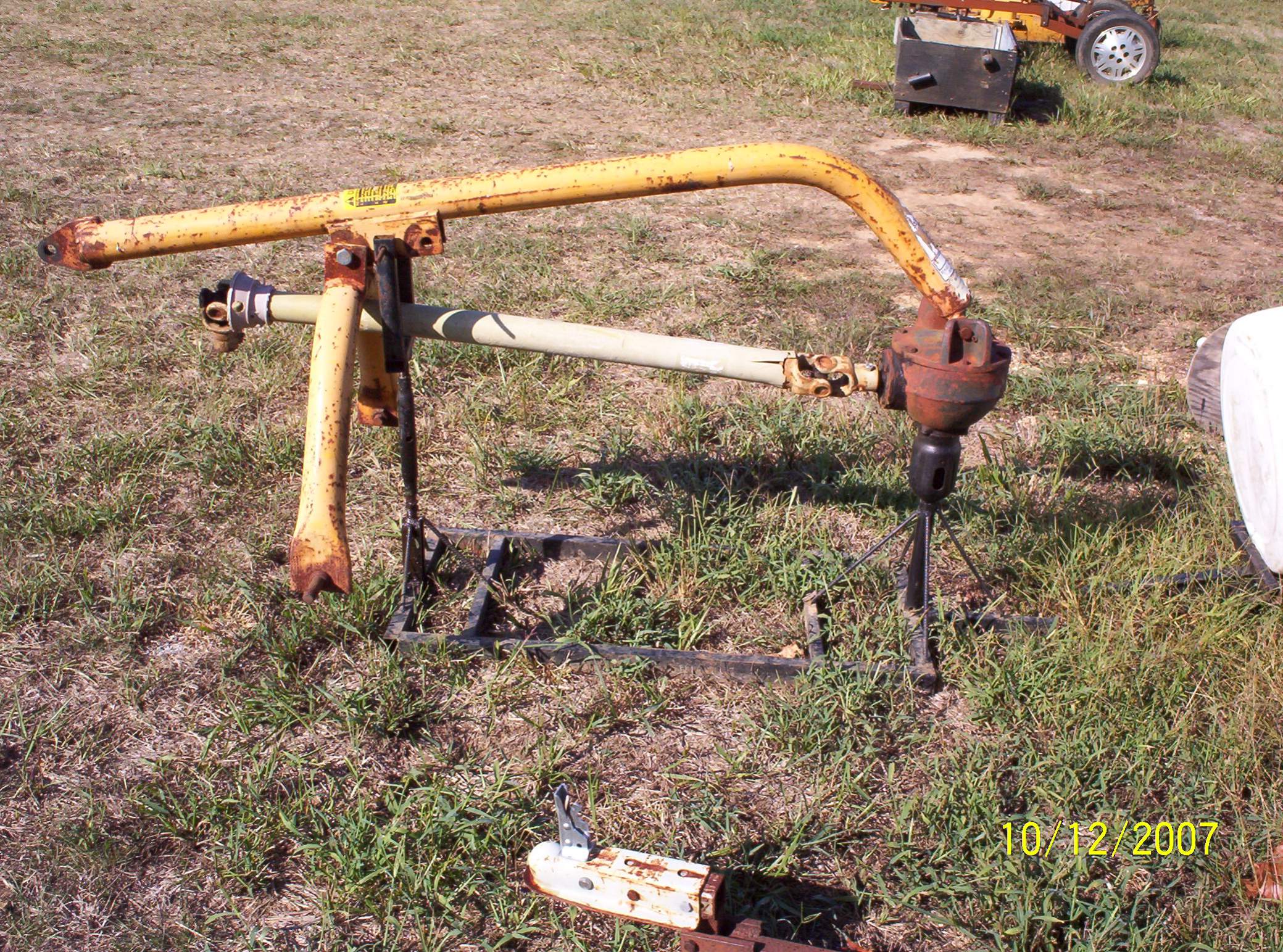

Lots of answers for this. This what I did, cost under $20, 10 years ago.
2-4x4s in the ground cut to the proper height after they were in the ground.
2-saddles for the top of the 4x4s to hold the 4x4 cross beam.
Very easy, takes about an hour and you get to use your PHD to dig the holes for the posts.
These were the first 2 holes that I dug with my PHD. :cool:
Oh, and not with the 18" auger that is on there in the picture, but a 6" auger that I also have. ;)

   / Land Pride PD 25, does anyone have a home made stand plan? #4
Thank you...great Idea. I'll need to put mine indoors..in my shop.
Curious, how do you attach the auger to the tractor..and lift the auger over this stand?
You do not lift the auger over, you lift the auger and pull out the cross beam out of the saddles.
Typical hitch-unhitch takes 5-6 minutes. It's easy, no heavy lifting involved.
If you look (search) there are a few guys that have copied this system other than modified it for a rolling cart.
To determine the height, just have your PHD fully raised and mark for the top of your cross beam to be 2" below that.
Good luck.;)

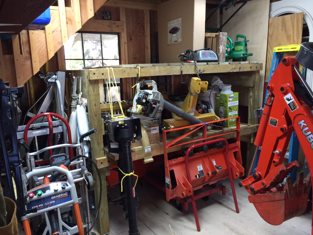

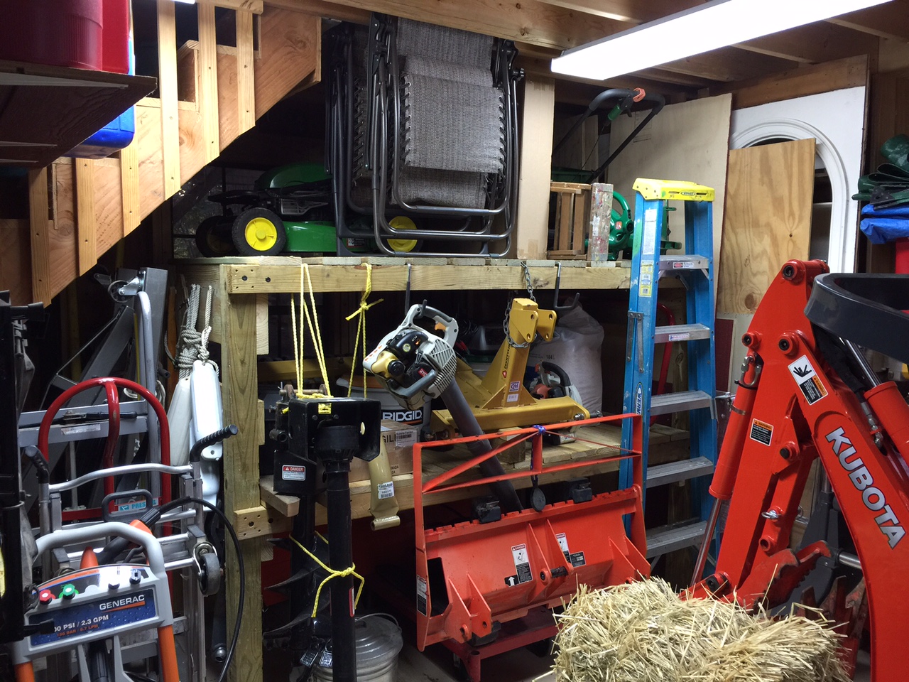

I have mine sitting on a wood bracket mounted to the front of my storage rack. with a safety rope to keep it there and compact so I can walk past it. I take the boom off and set it next to it on the shelf. It's only one pin to hook it back up. I back the tractor up to it. Make the connections then take the rope off before I drive away.

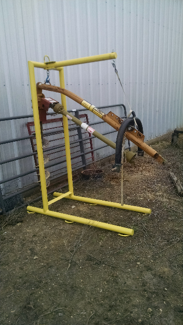

   / Land Pride PD 25, does anyone have a home made stand plan? #9
There was a whole thread here on how creative people got myself included. If I can find my picture it should help you out.
   / Land Pride PD 25, does anyone have a home made stand plan? #10
This is mine, I have posted it before. Just backup to it, turn crank up or down , hookup top pin.
Hookup drive shaft then the lower link.
