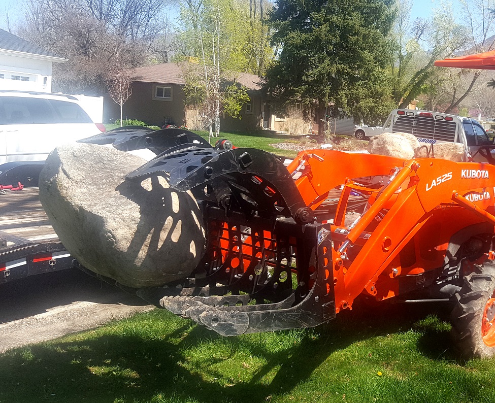

   / Land Pride or WRLong #7

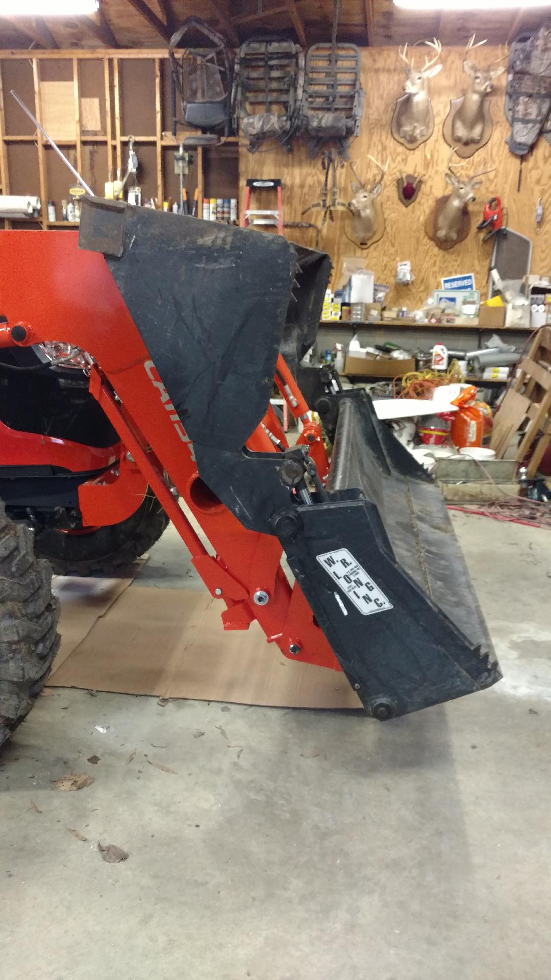

I've love my WR Long third functions on a 50hp and now my 70hp. It will fit your hand like a glove and the quality is tops. Kubota WR Long bucket open.jpgIMG_2616.JPG
