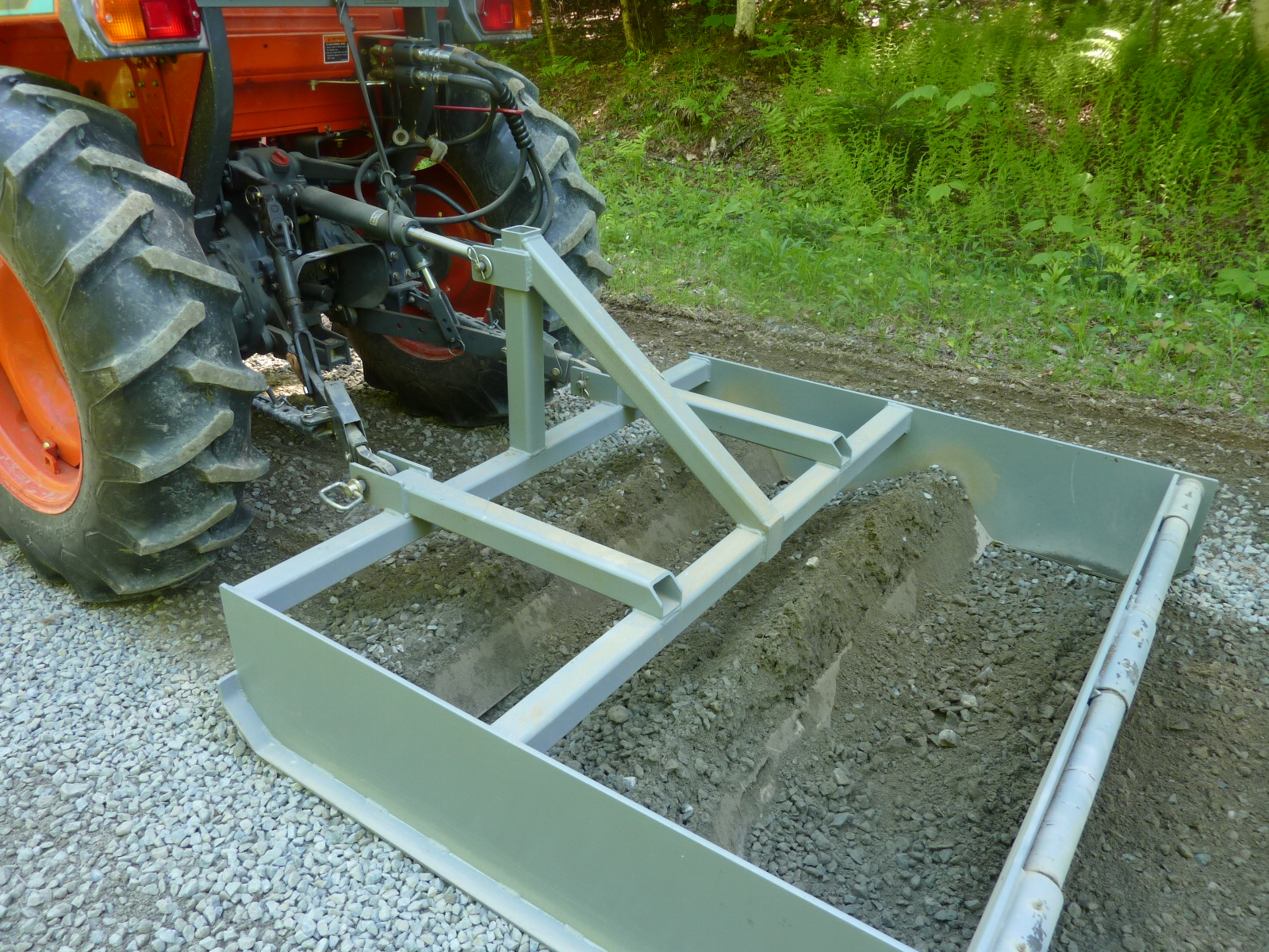

Not having a fancy grader scraper I tried different approaches.
While a pain in the neck (azz) I found grading with reversed back blade while driving backwards worked OK. The reason being all 4 wheels were then on flat graded base vs grading going forward the tractor would rise and dip on every bump causing the BB to dig every time.
That worked OK but I later made a 3 bladed 'drag' that really solved my grading issues.
