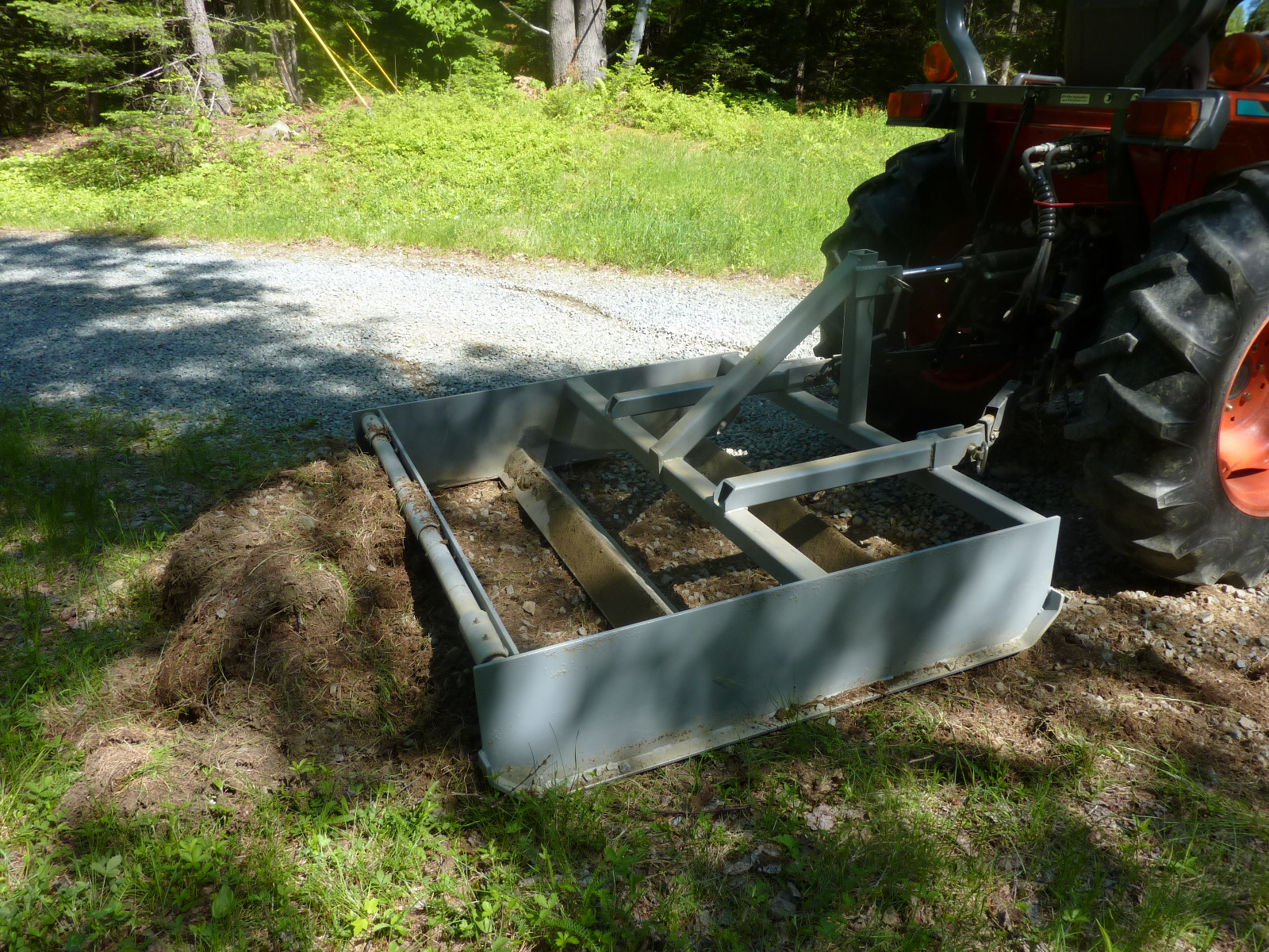

I built mine but it's 7 x 7. A bit large for your machine.

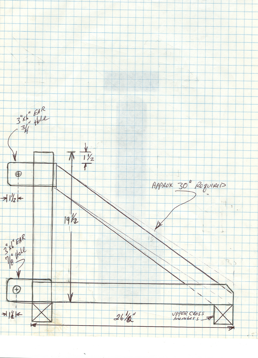

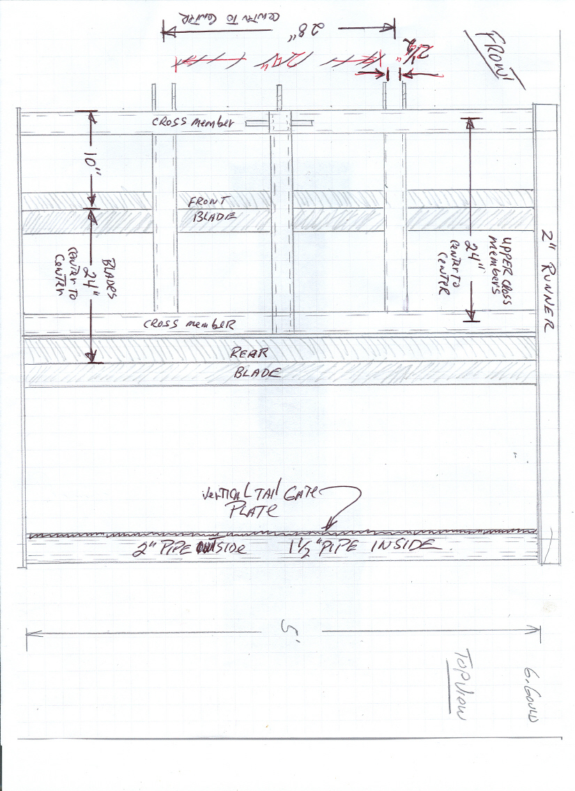

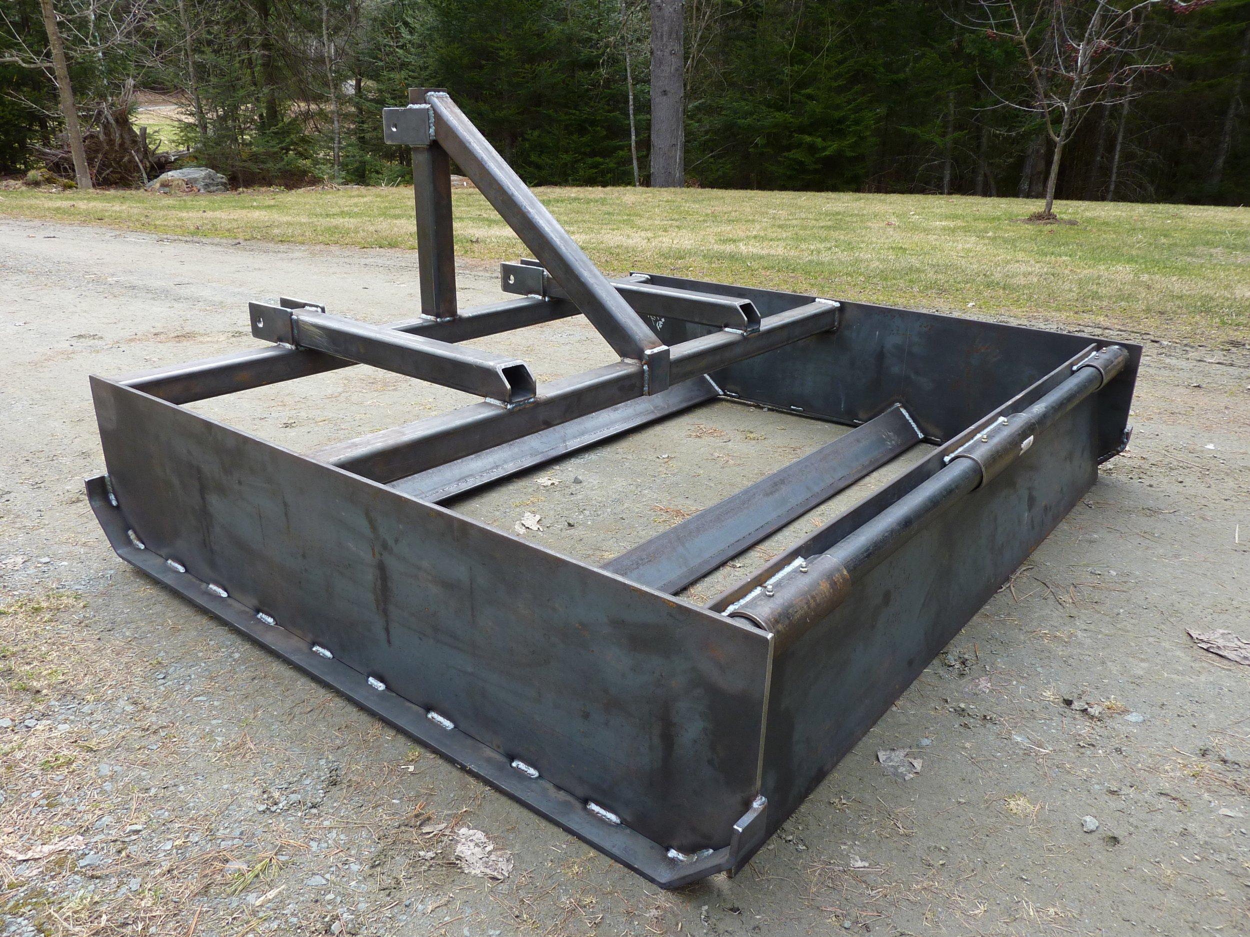

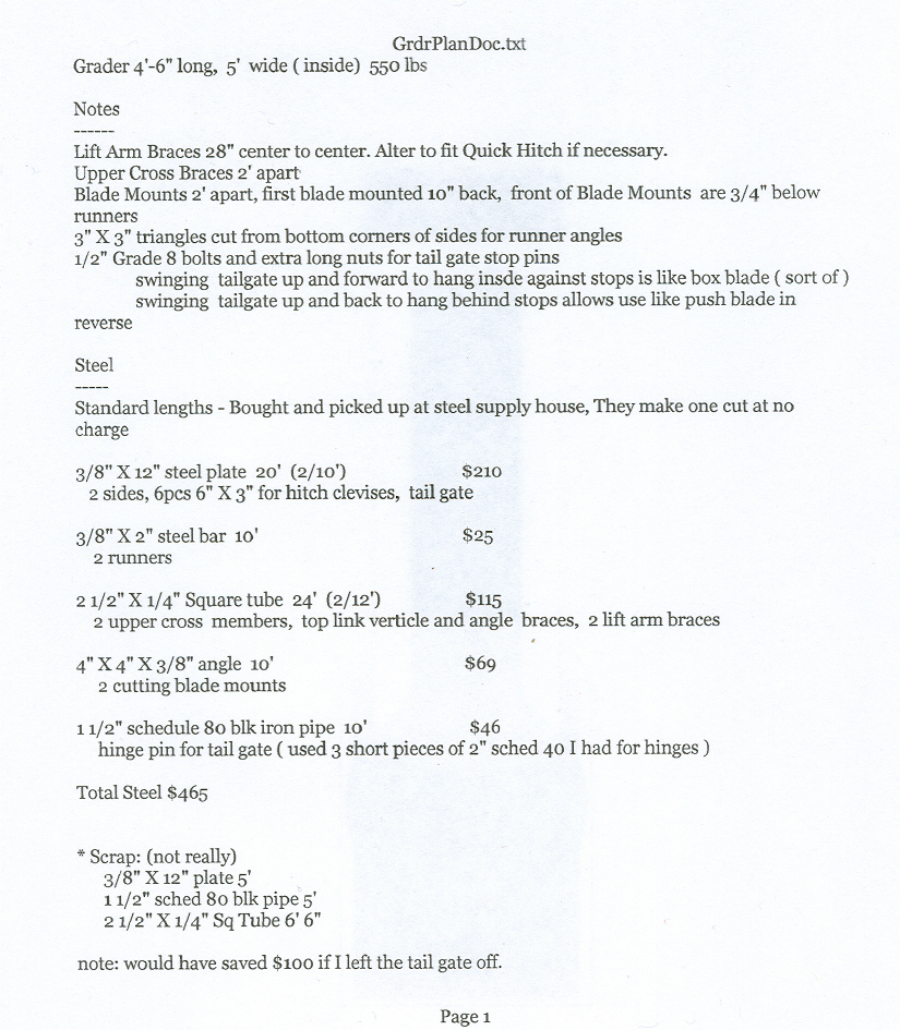

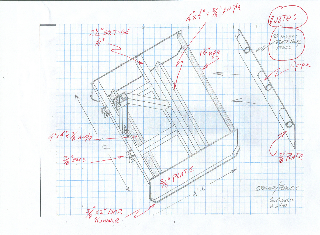

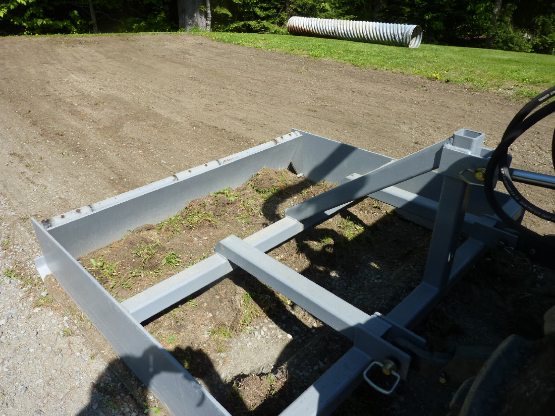

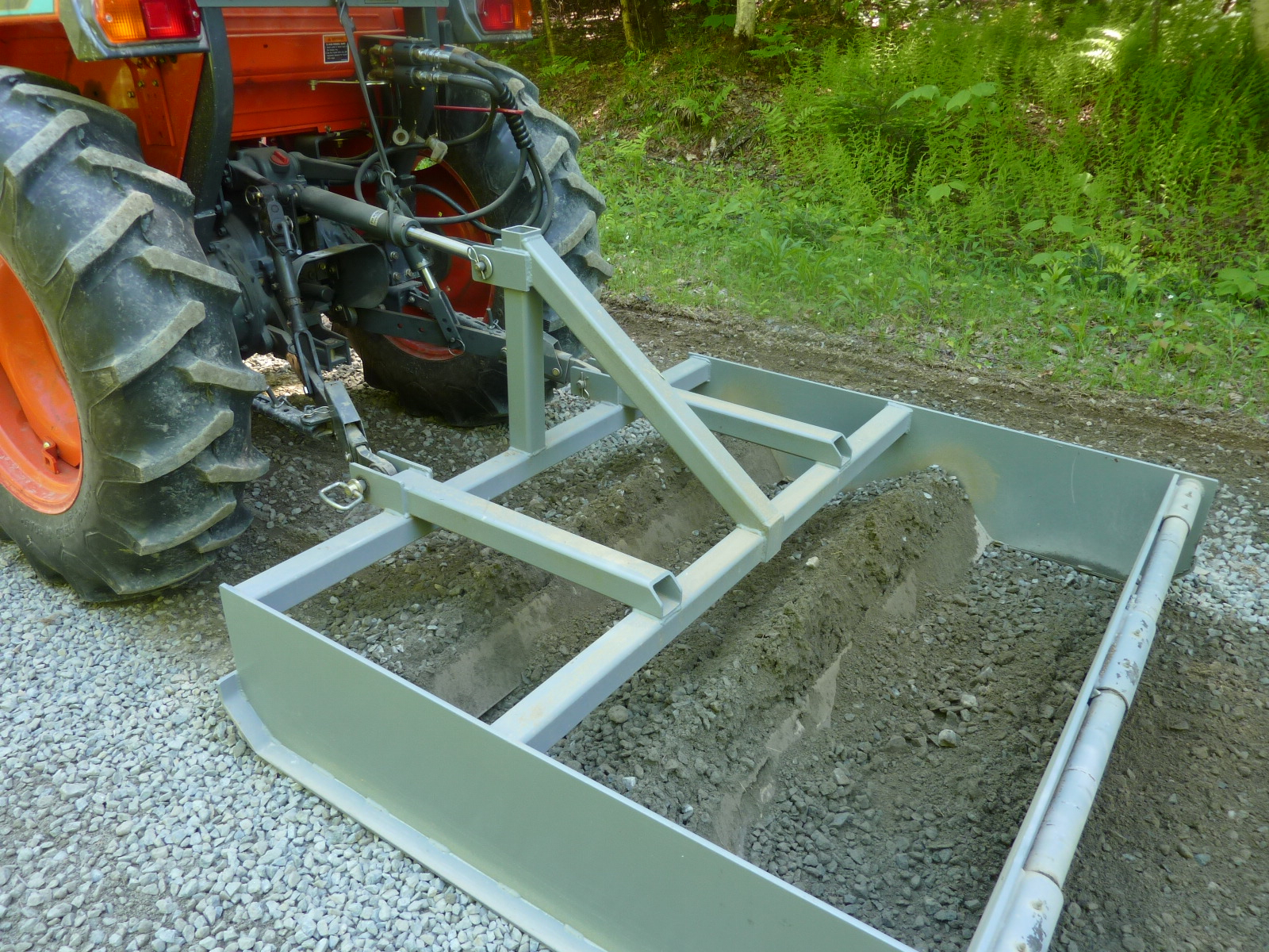

Here are the plans I made for one I built in 2010. I pull it with a 30 hp L3010. It is plenty for that tractor especially on the hills. You might want to scale it to your tractor width - I would not make it any wider than necessary. The with dimension is inside. Make it a little wider than the cutting edges you plan to use. It's just an example that you can change and simplify. The hitch dimensions are for Cat 1 3ph BUT are NOT quick hitch compatible. Not shown on the drawing but the sides are 12" high. If you put cross members/spreaders across the top like most have try not to put them over the blades. They can/will imped the flow of material. Material will build up going over the blades.
They are simple things - most anything will work well if it is heavy enough. Shoot for more than 100 lbs per foot of width. My 5 footer weighs 650 lbs

   / Land plane #6
I like your rear gate. I need to add one to mine just wasn't sure at the time how I wanted to do it. I mounted my blades at opposing angles instead of straight.
   / Land plane #7
I have a set of pins that the bottom of the gate hits against. If I swing the gate up and over so it hangs behind the pins it acts as a drag going forward or in reverse as a blade so I can push stuff off the road.
If I hang the gate in front of the pins I can use the grader to collect and move material like a box blade.
Even with the gate hanging behind the pins it is heavy enough to collect sod which I can then push aside like above.
gg
   / Land plane #8
On my build I went one step farther and added a cylinder to the rear gate to be able to adjust on the fly.
   / Land plane #9
I'm pretty sure that I remember some pictures that you posted of that. It makes for a very nice and versatile unit.
gg
   / Land plane #10
I was thinking of a cylinder for mine but you lose the ability to have it float unless you make some sort of linkage for it. I love your idea of a 358 degree gate so you can use it for multiple purposes. What's your gap from the bottom of the gate to ground surface?
