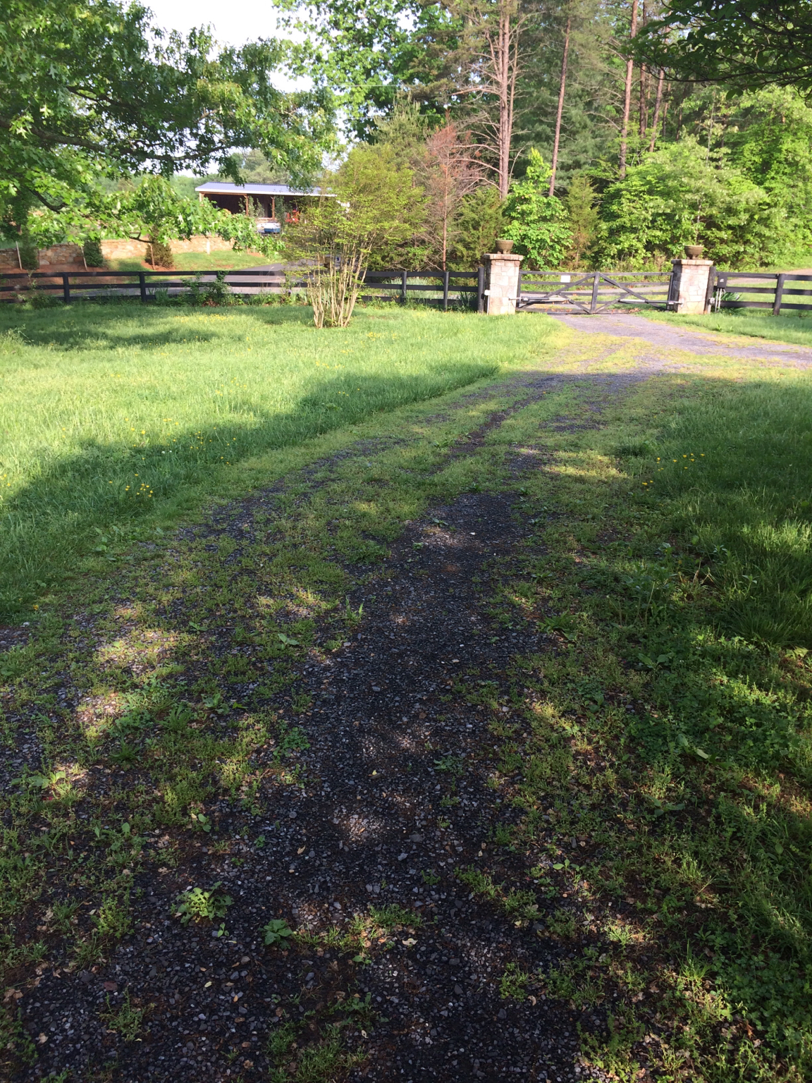

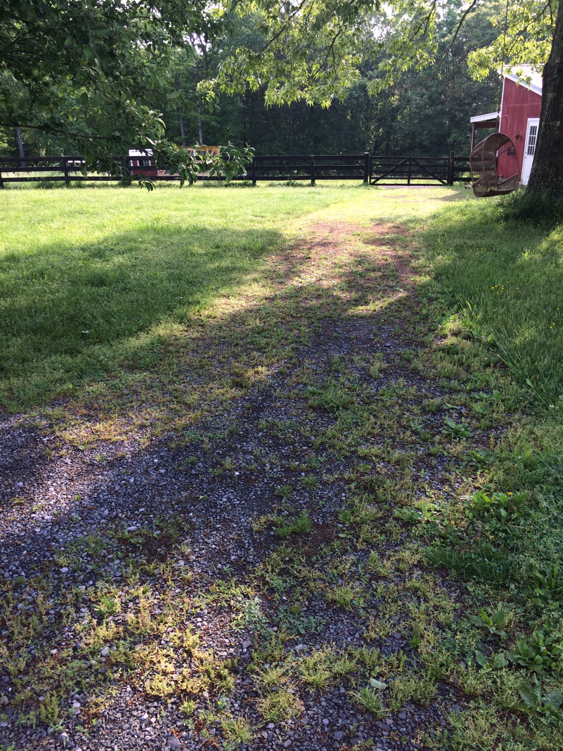

Our gravel driveway is being taken over by grass. We also share a 1/3mi long gravel lane with two other neighbors that needs maintenance. I'm looking at purchasing a 5ft land plane from Everything Attachments. My question is, would my 1952 Ford 8N be able to pull the 5ft land plane? No 4wd or diff lock, air in the tires.

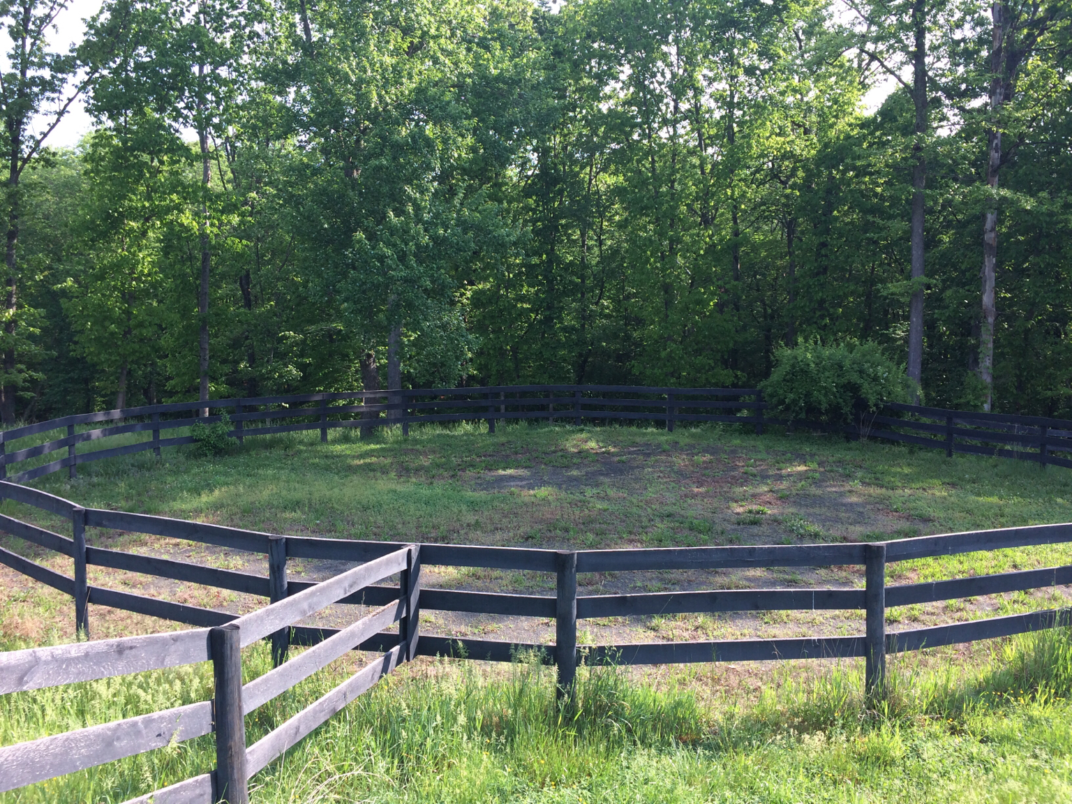

Also, we have a riding ring for horses that's also being taken over by grass. We presently don't have horses but would like to maintain the ring for use in the future. Would the land plane work on that too? Or would a landscape rake with gauge wheels be better?
Here are a couple pics of the driveway:

It will pull it. Similar to my TO20, it was made for pulling. First gear might be a little fast, so you may be working the clutch. Fluid in the tires would help for sure.
My suggestion would be definitely get scarifiers with the land plane. Maybe glycophosphate the drive first?
At some point a new stone layer will help too.
Hey if it doesn't work well with the Ford...you just have to get a new tractor! Good luck.

I'm not trying to be contrary but....I like the grass in your gravel driveway. I think it looks nice and, for sure, it adds a level of structural integrity to the driveway surface.
I have a Land Pride 84" (Land plane grading scraper) - GS2584. They are a VERY EASY implement to pull. Your 8N will have no problem pulling a five foot LPGS.
Small facts - the LPGS DOES NOT move material horizontally. So - - it will neither build or tear down the crown in a driveway. I will smooth a driveway out very nicely but WILL NOT move material from here to there. You will need a box blade to do that.
The LPGS will not remove grass well from your horse arena or driveway. A LPGS does not work well with sod. It lumps, bumps and sort of jumps over sod and accompanying grassy areas.
As Tompet has suggested - first, kill the grass. Second - a LPGS will handle sod much better if it has scarifiers that can first tear out the sod. Its still going to have difficulties dealing with the clumps of sod. Some form of rake will best remove the sod and leave the gravel.

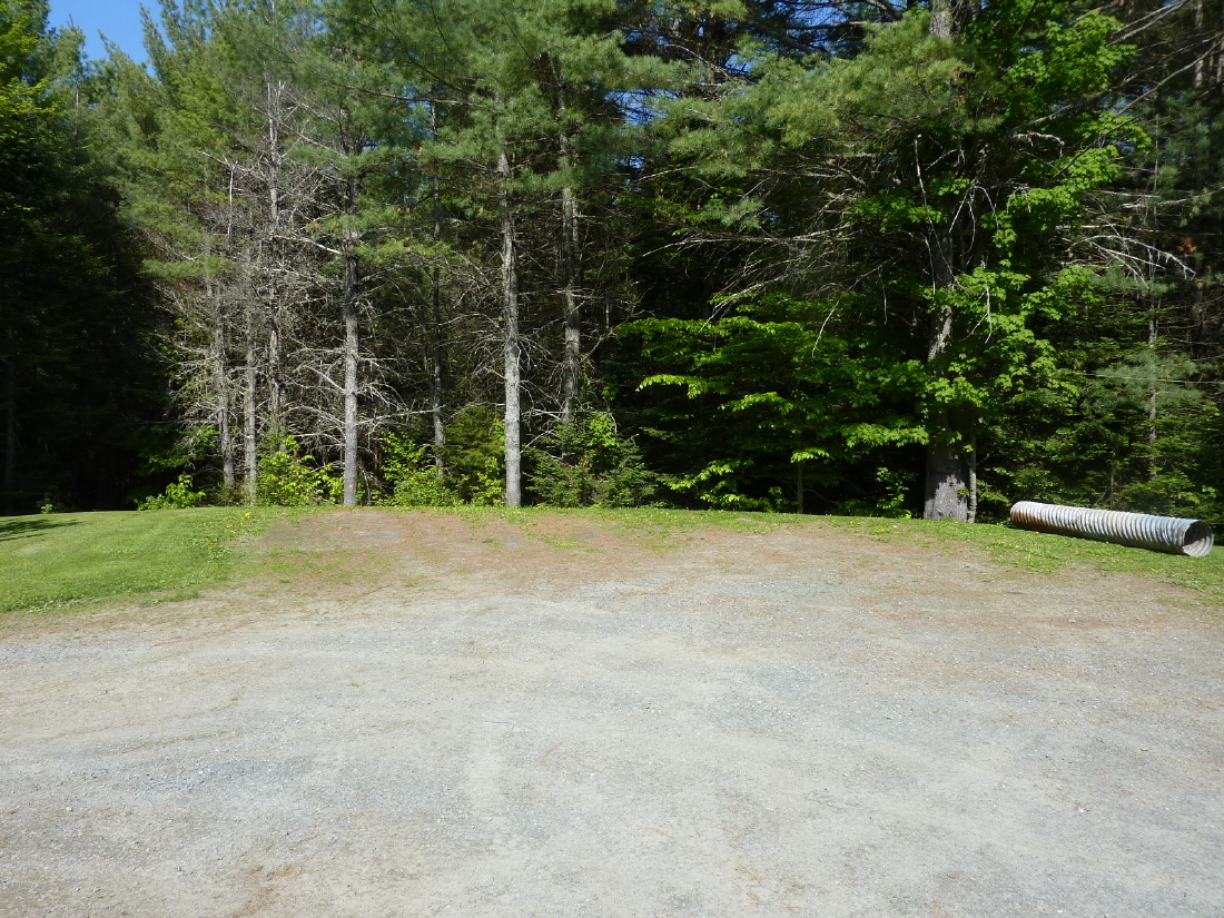

I have found that making a point to drive on the whole width of the driveway is the most effective way to kill grass and reduce the center ruts and associated washouts and potholes. Grass in the drive makes it very tedious to grade and the result is often bumpy, though after a frw weeks the sod will break down and eventually it can be graded reasonably well with a blade type tool (scraper, box, etc.). A york rake is good with a soddy driveway, but it tends to pull the coarser gravel to the top where it gts flung out of the driveif it is used too agressively. The most important thing is to keep a crown on the road, and that needs a box or scraper.

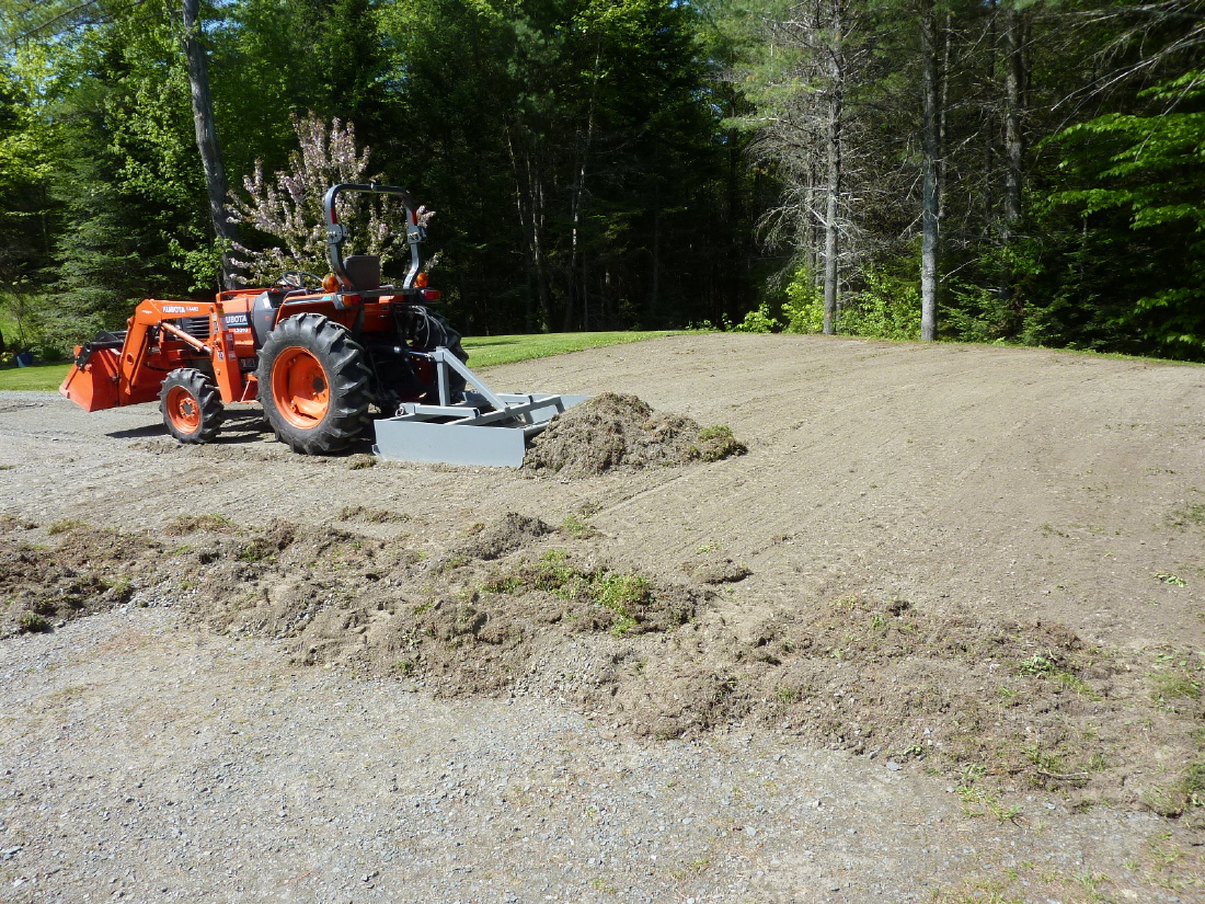

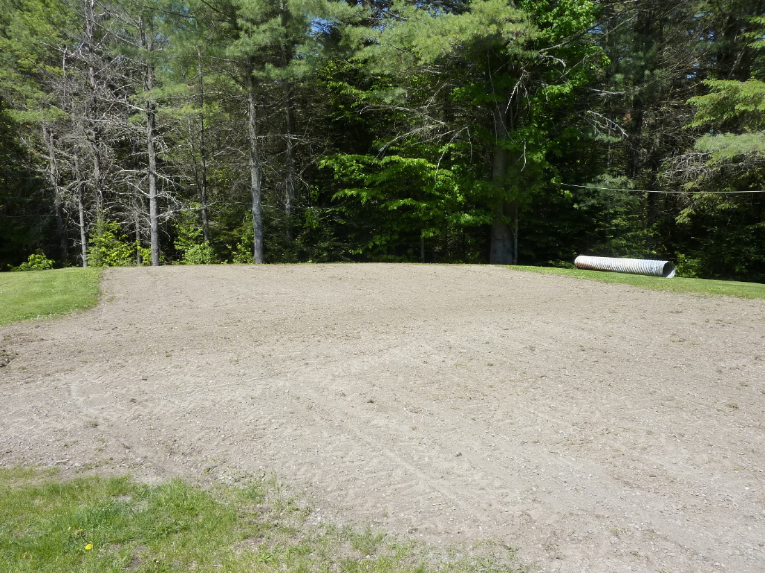

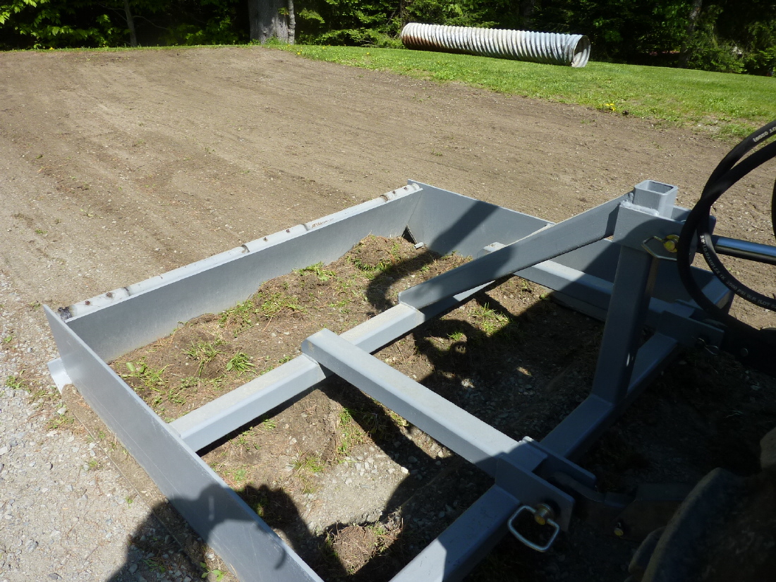

My neighbor just purchased a B2310 Kubota along with a number of attachments, including a 48 inch land pride grading scraper. It doesn't weigh very much but was surprising good at removing the grass in the middle of my driveway. He also was able to smooth and clean up the driveway into his property that had not seen a lick of maintenance in about 20 years. It was a lot easier to use than a traditional scraper blade with a much shorter learning curve, I'd say just about perfect for a novice tractor owner.
