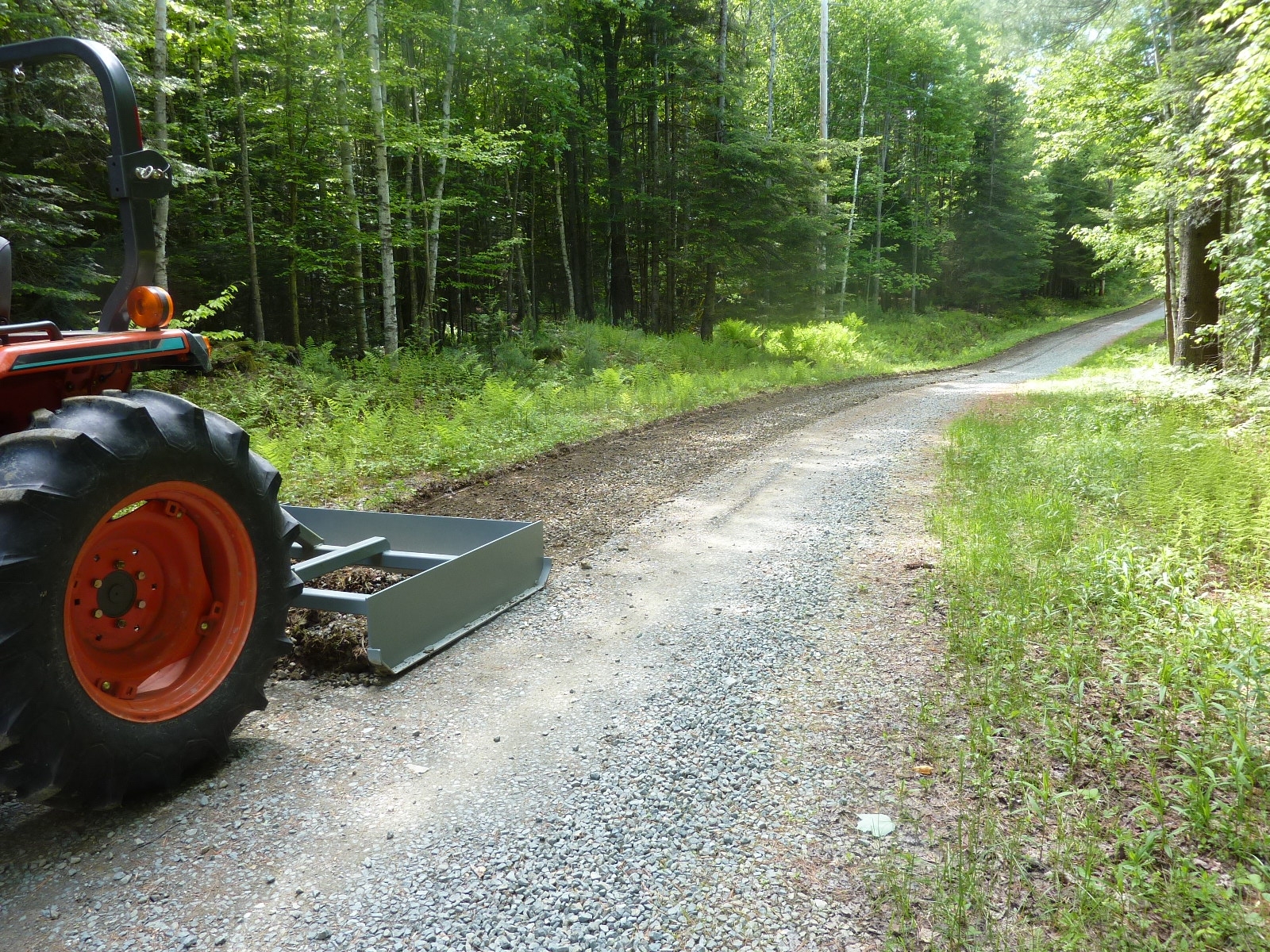

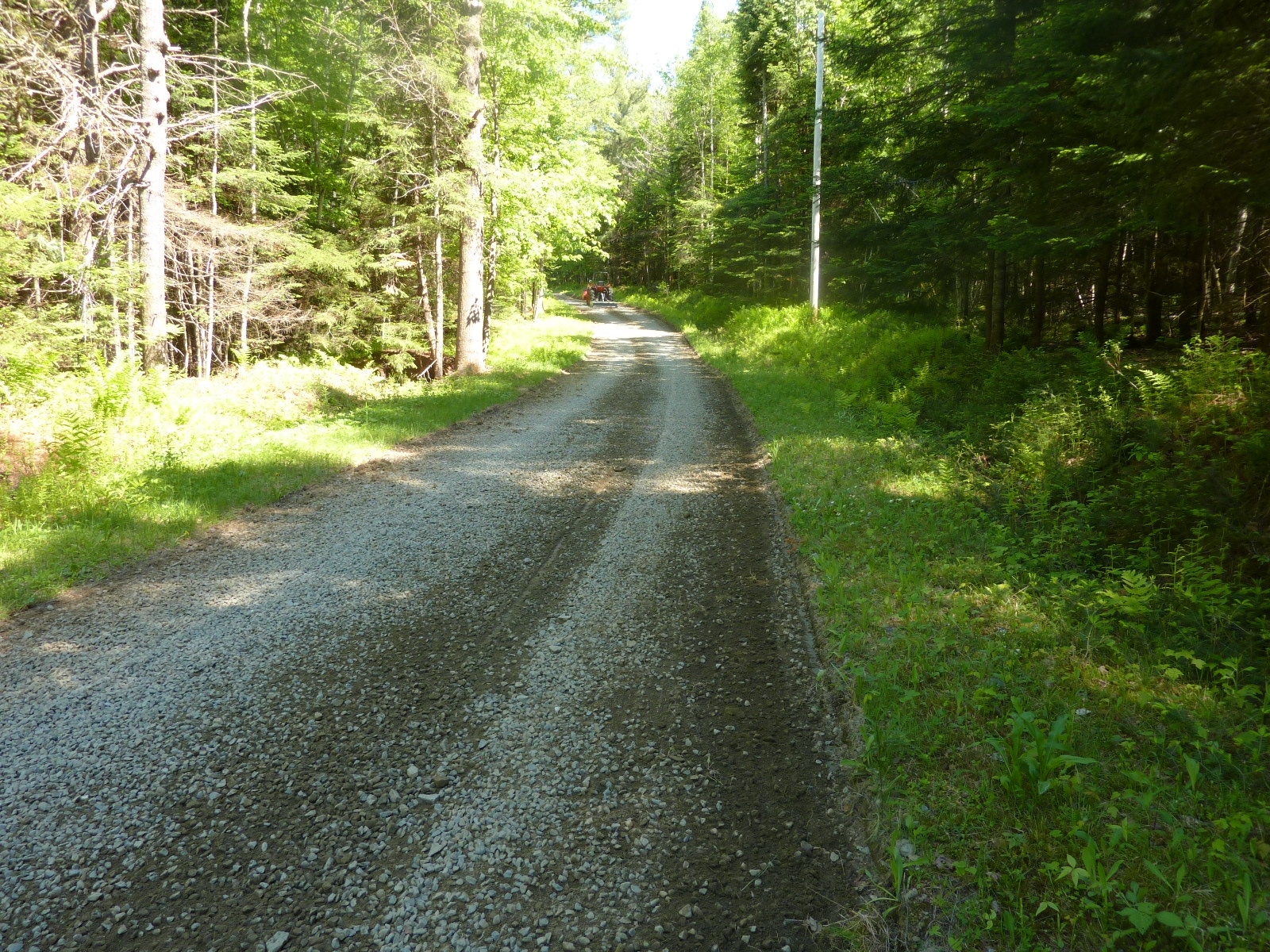

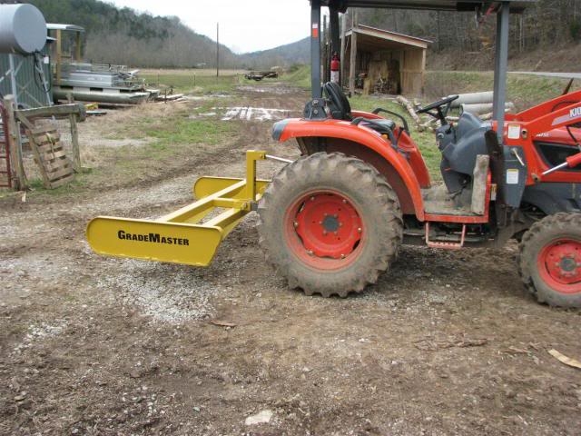

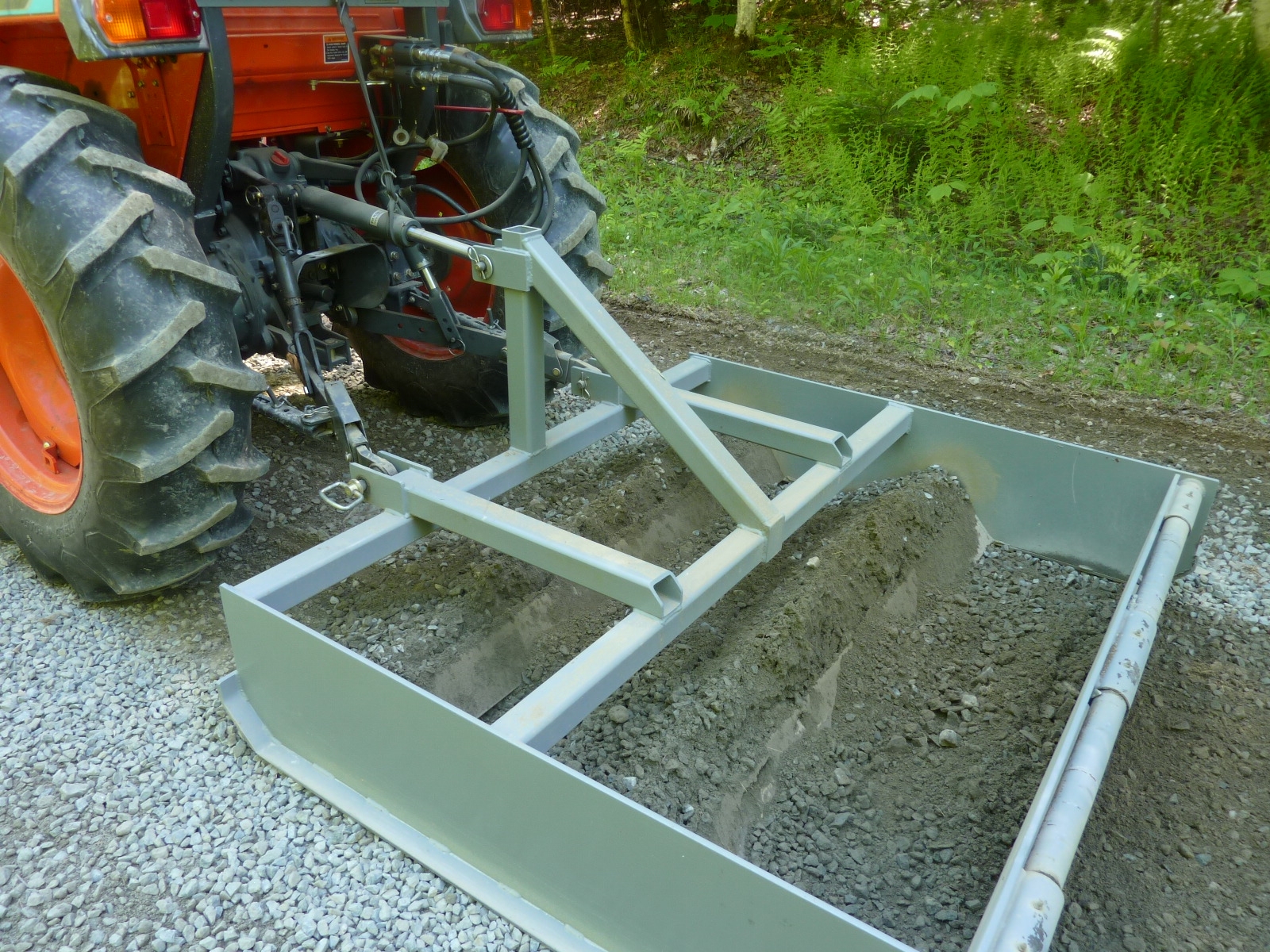

I use a rear blade and a landplane to maintain my long drive. It's make up varies from good base and 3/4 gravel surface to old logging road with some 3/4 crushed stone mixed in. We also have a spring mud season. I use the blade to contour for good water run off and I use the landplane for surface maintenance. You want a heavy land plane. Mine is 5' wide and 650 lbs. I do not have scarifiers.
Rear blade
Landplane
Rear blade
Landplane
gg

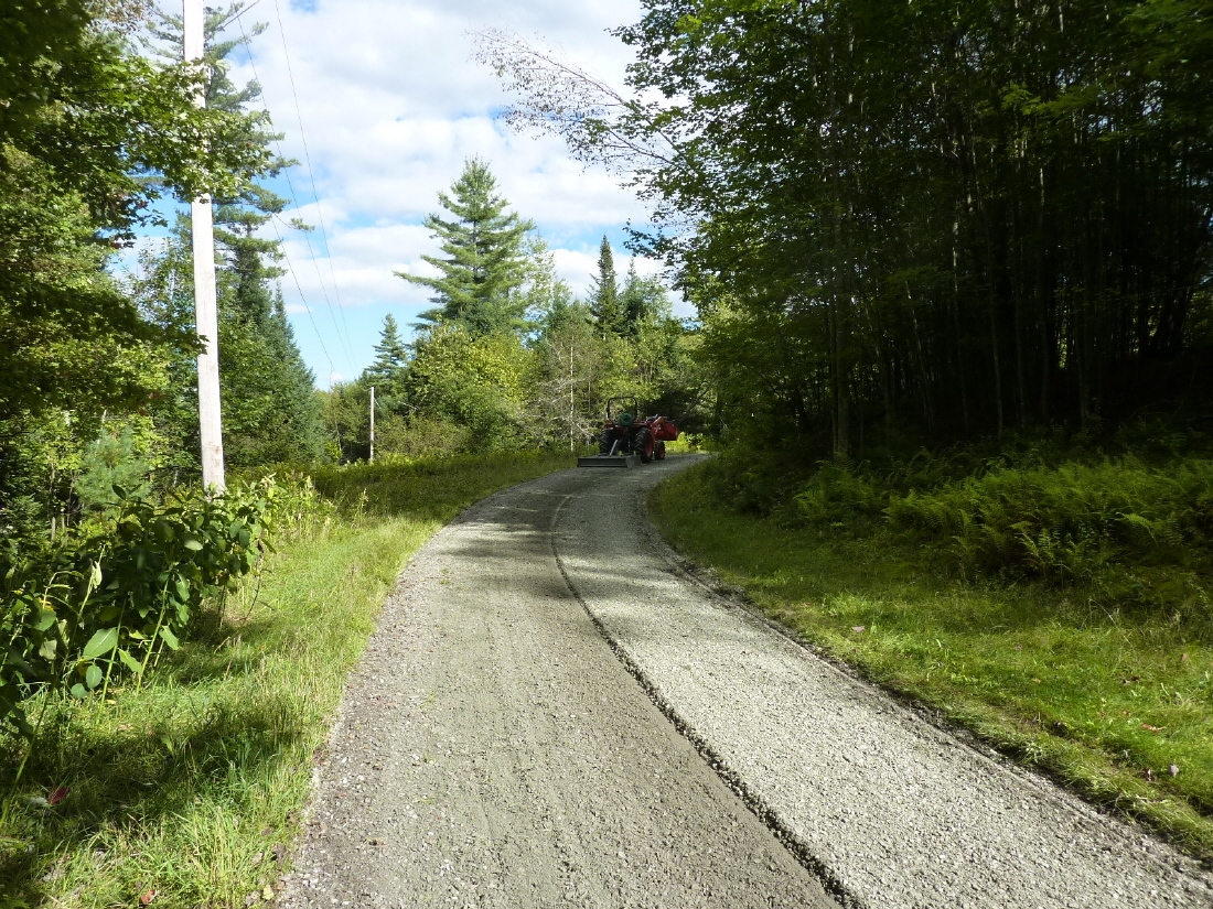

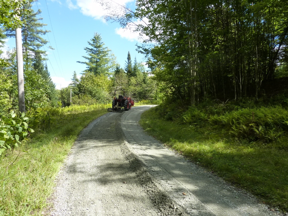

Landplane at work
The land plane is my go-to road tool. I use way more often than the rear blade. Keeping the surface in good shape helps maintain the road contour.
