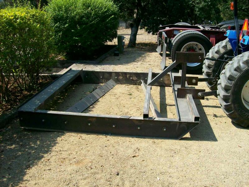

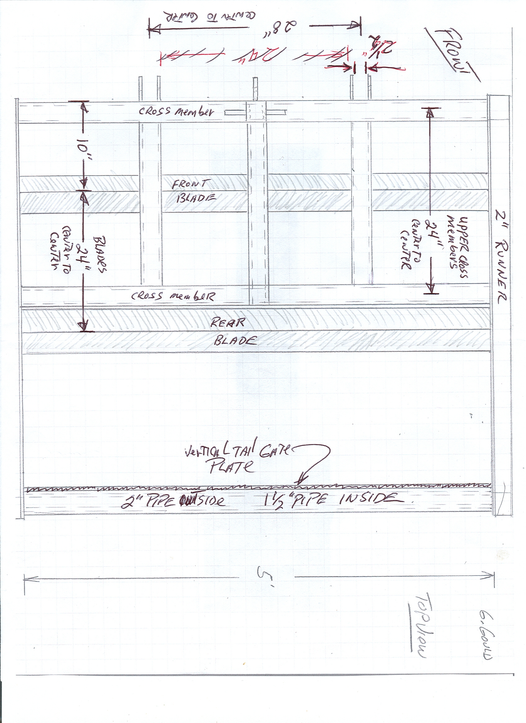

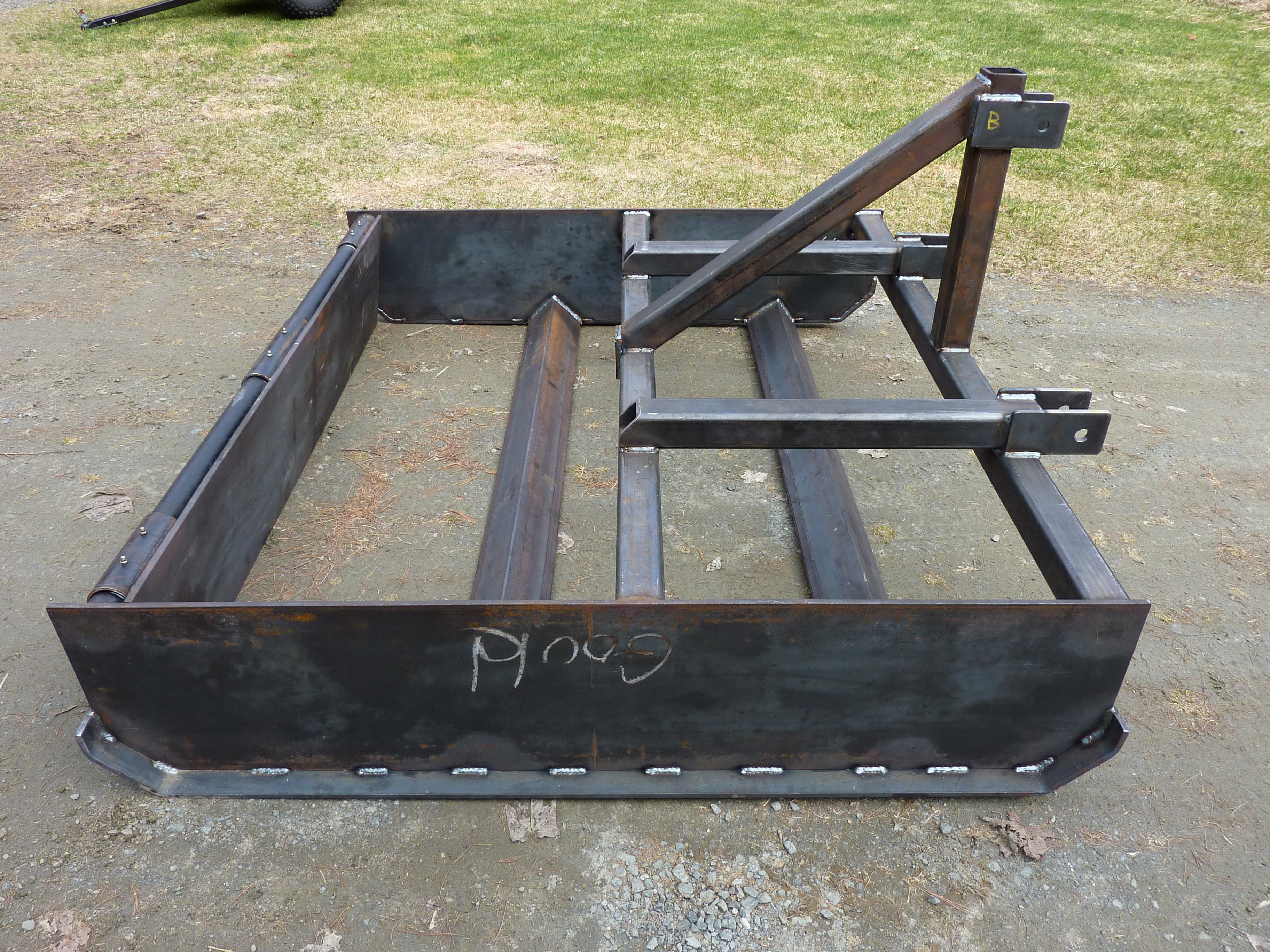

I have been thinking (for a long time...) about building a land plane. I have also looked at a lot of them, and the best method I've seen for mounting the blades is to use a piece of angle iron with the open side of the angle facing down, and bolt the cutting edge to the angle like this:

It works fine for me. I think the key is weight. At 5' wide it weighs 650 lbs. So 130 lbs per foot of width for blade pressure which is the important number.
Gordon, Thanks for all your info. I looked through my landplane pictures file and I have all your pics and drawings that you previously posted on TBN. I will probably steal your design when I build mine someday (if I ever get around to it....). Hopefully you take that as a compliment.:)

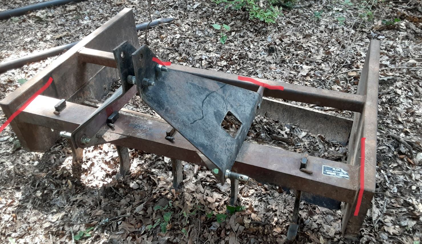

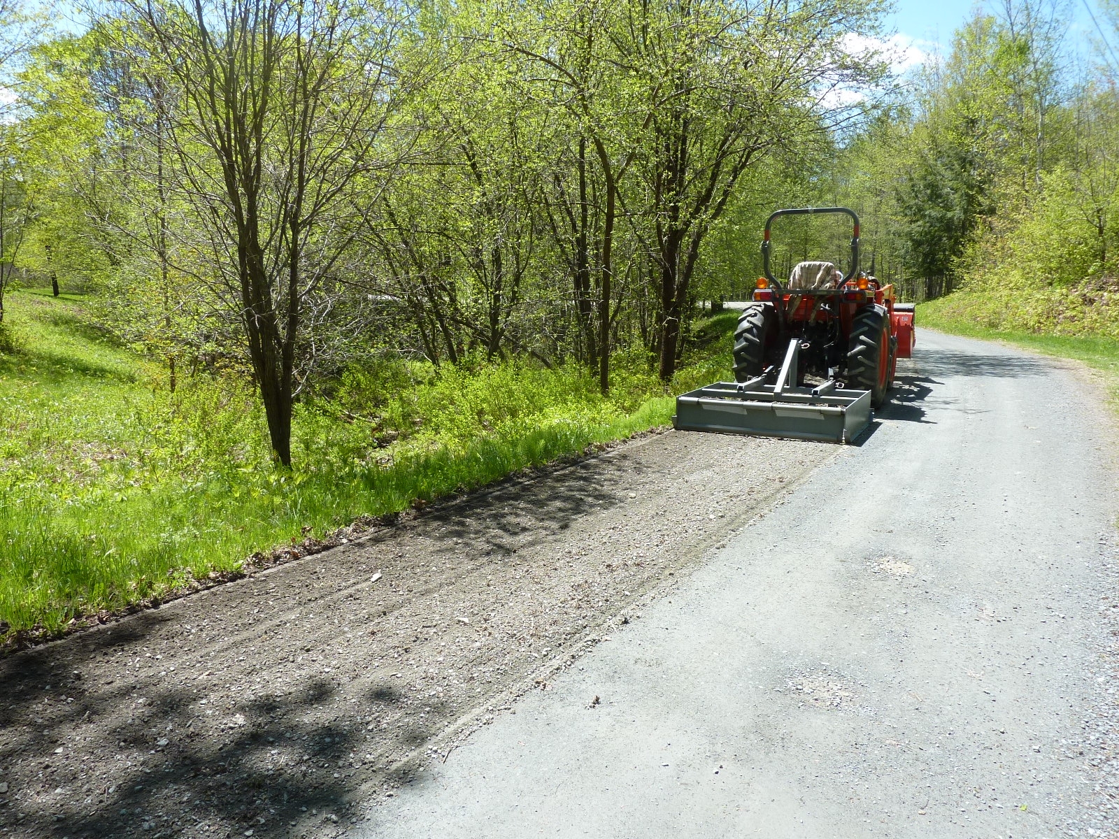

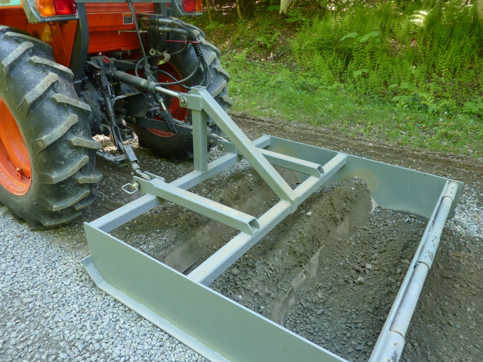

My land plane is 58” wide for use behind a Kubota BX25D. The front blade is angled 15 degrees. The cutters are standard box blade cutter bars which are bolted to 4 four inch angle iron. If I had it to do over I would move the rear blade all the way to the back of the unit and move the front blade back to about ten inches from the leading edge of the right side rail. I got some gravel spill over with the current set up which I solved by bolting on a twelve inch long “wing” on the leading edge of the rail angled out to redirect the gravel into the plane. The plane weighs 470 lbs. I added scarifiers after the picture was taken but the tractor has trouble pulling with all four engaged.

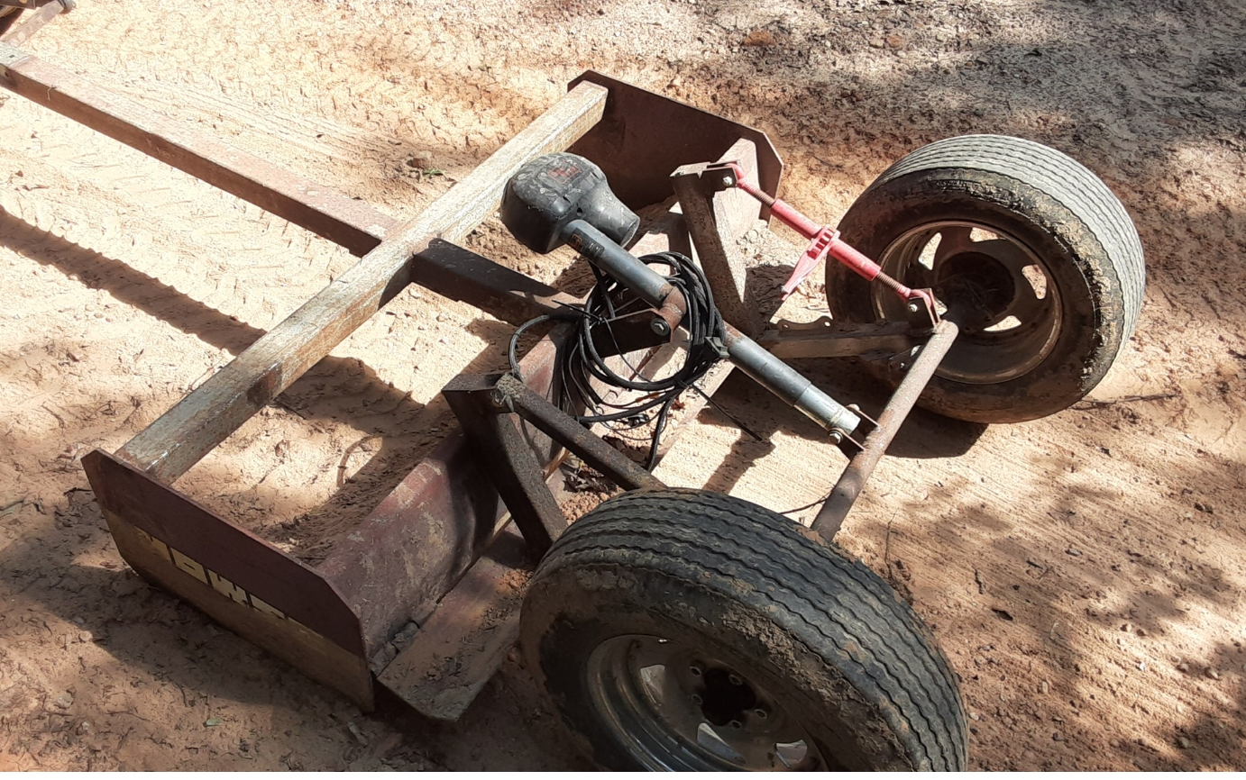

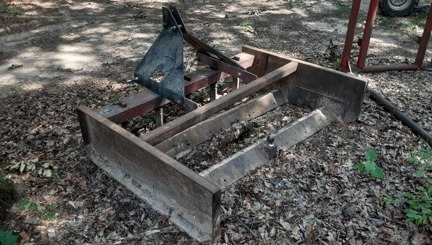

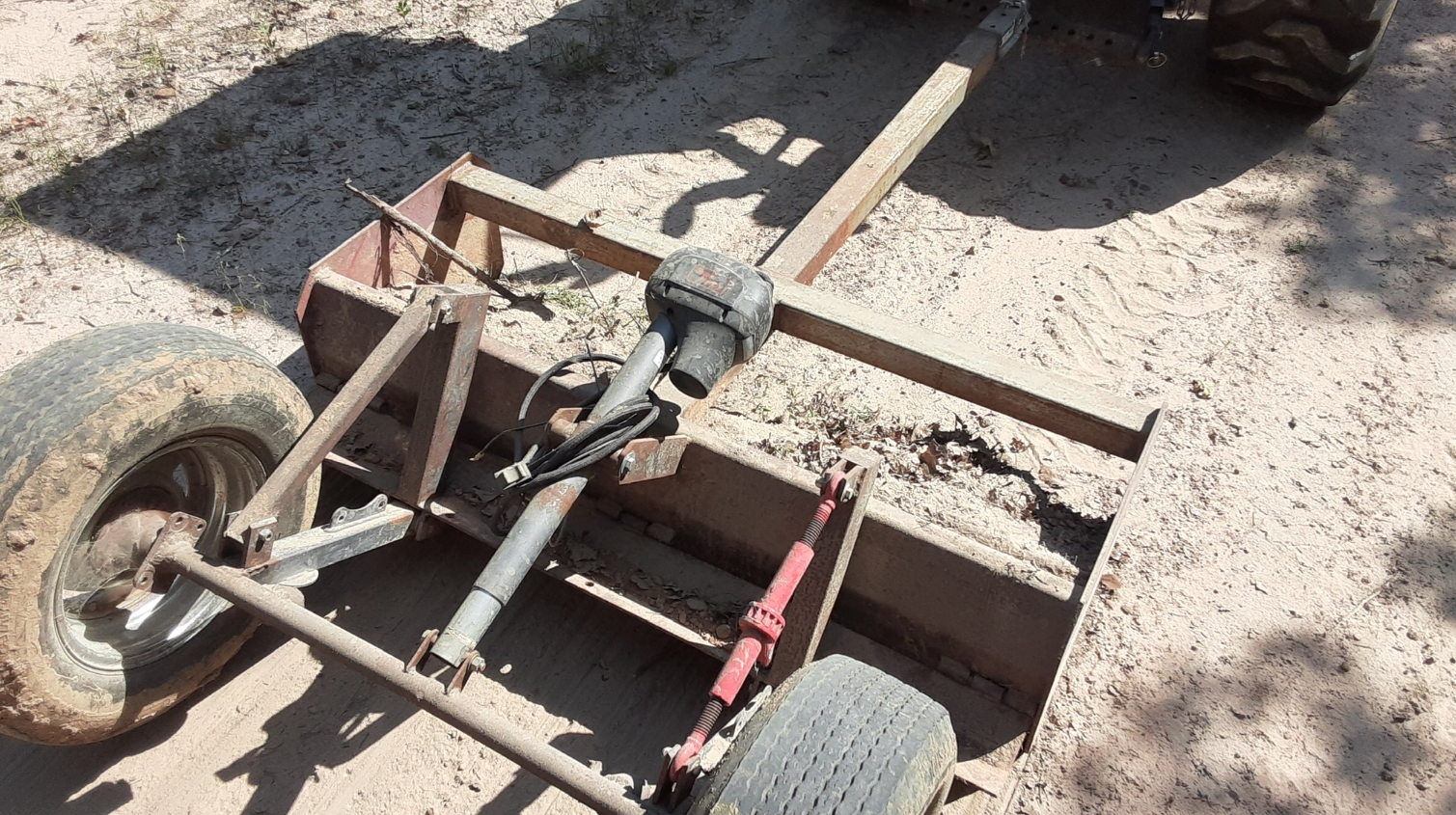

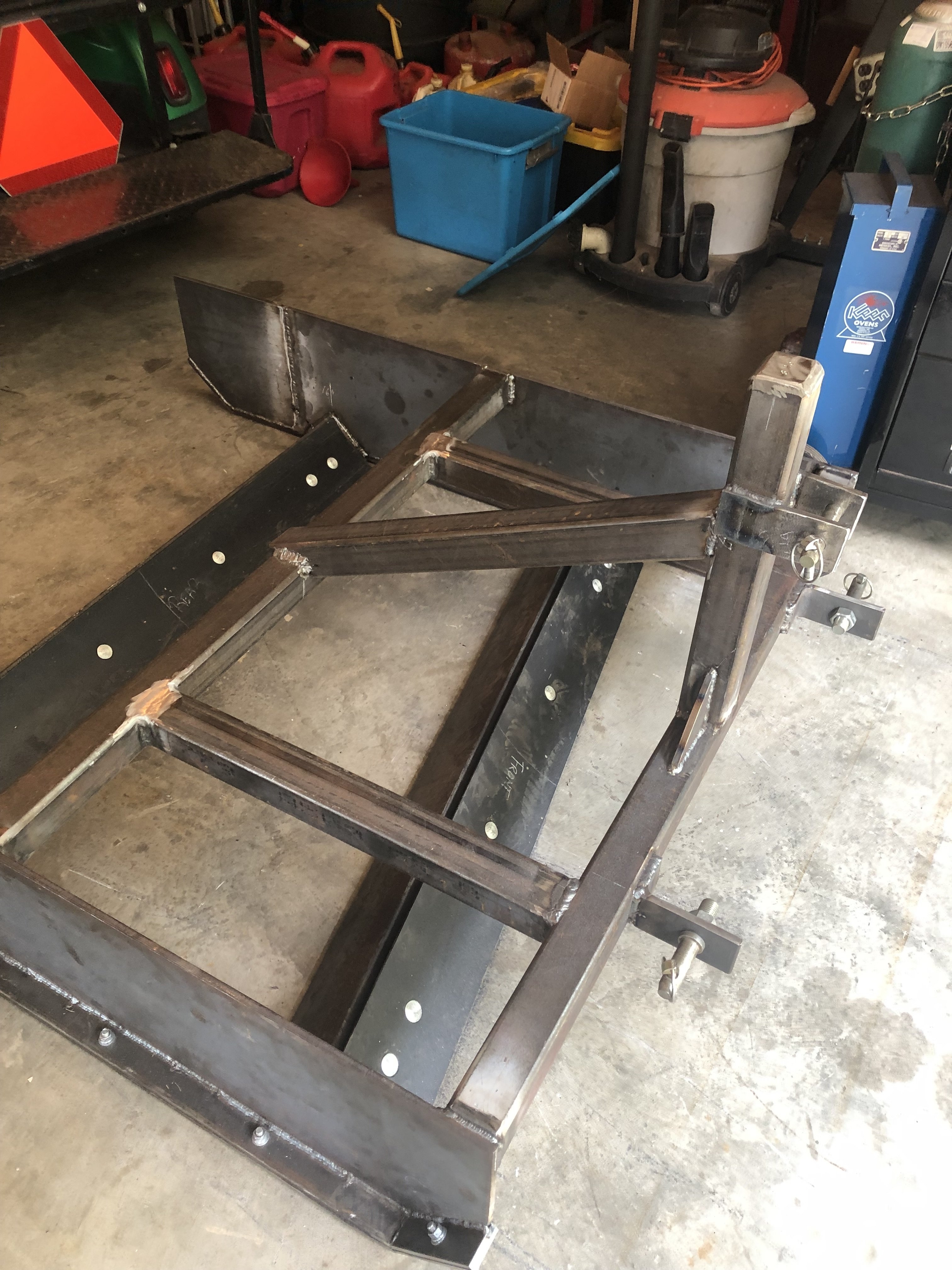

I built these out of a box blade, this one works great for moving material and I used an electric trailer jack so I could use it with a fixed draw bar but on the 3pt is much faster.
It had a floating rear blade, so it cut a lot better than smooth as a box blade. I used the rear baldw hinge, as the hinge for the rear wheels.
The load binder is to adjusting for the crown angle you want.
The 3pt and rippers, I turned into a landplane with 6x6x3/8 angle, 1/4" plate and added 3/8" thick replaceable skids on the bottom.
Ball to drag a 3500 lb roller behind, on back.
Blade depth adjustment but I always run it at a 1/2" down.
I really didn't like that box blade, after I bought it. Turns out to be the best $250 I've spent in awhile.

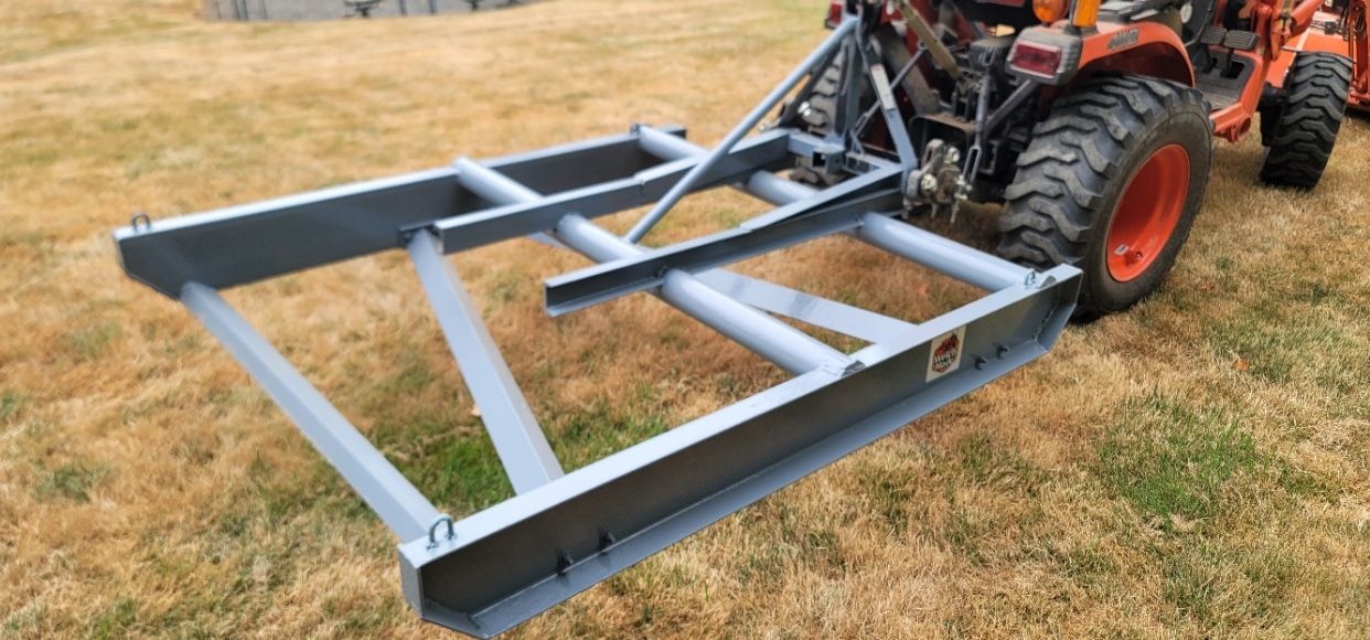

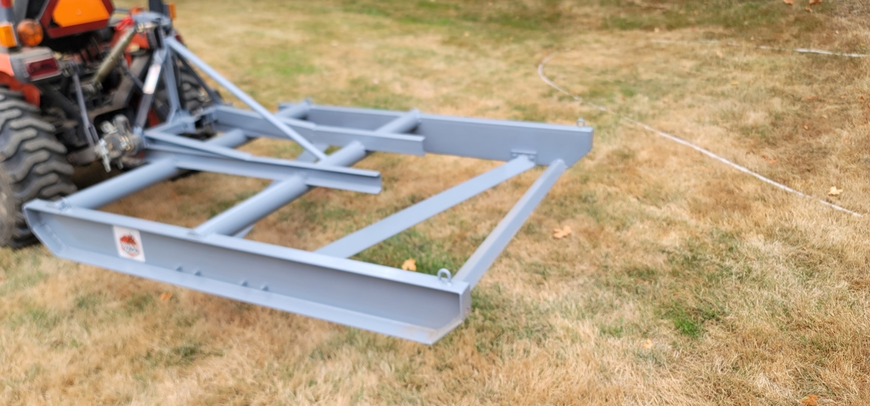

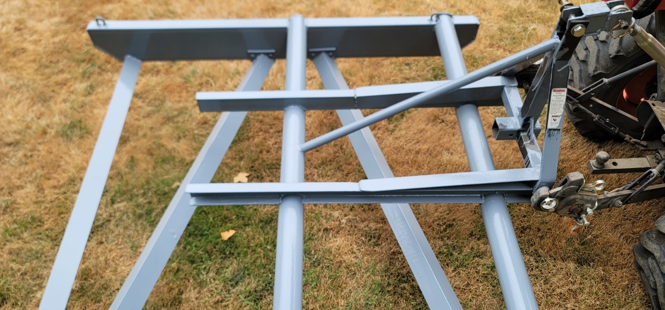

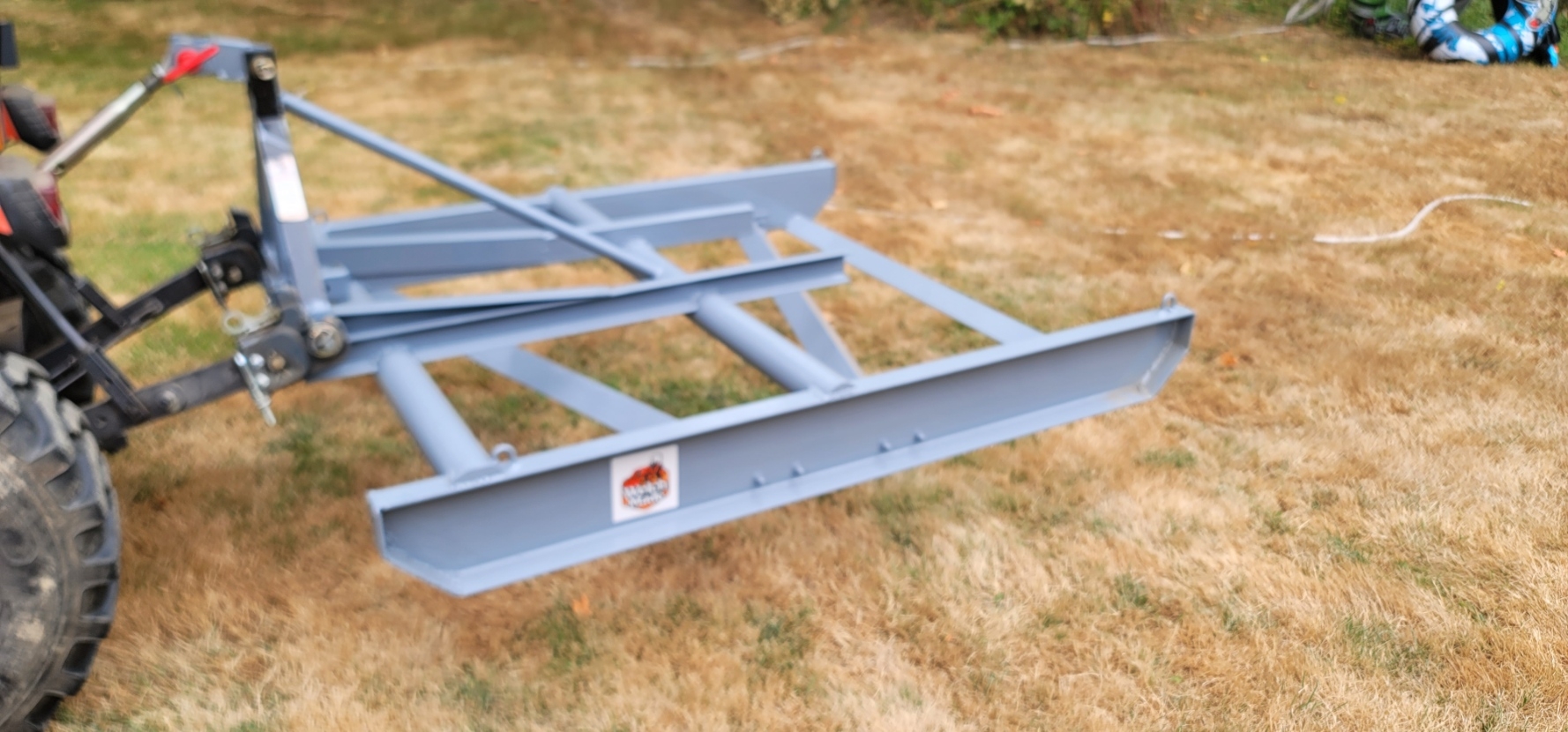

My land plane is 60 inches wide and about 60 inches long. Like many, I wasn't sure how to position the cross blades, but I knew I didn't want them at a 90° angle to the runners. Placing them at 90° assumes that the dirt will not move to the proper low areas. Instead, angling the blades pushes the dirt across the blade, piling it up at one end before it drops over and is pushed back across the blade on the backside, continually filling the low spots. Finally, a 90° cross blade blends out any lumps or piles that slid over the blades.
I made the blades bolt-in so I could change, repair, or redesign them if needed. I've heard of many people having their cross beams bent or broken by rocks in the dirt. Each cross blade is secured with two 5/8” grade 8 bolts on each side.
My design is a mix of what I had available and what I could buy. The three-point attachment is a simple 3-point slip hitch mount from online. The round upper tubes were pieces of metal left on the property by the previous landowner. Most of the other parts are cut-offs and mill cut-offs that I purchased at a discount.
Hope this helps
