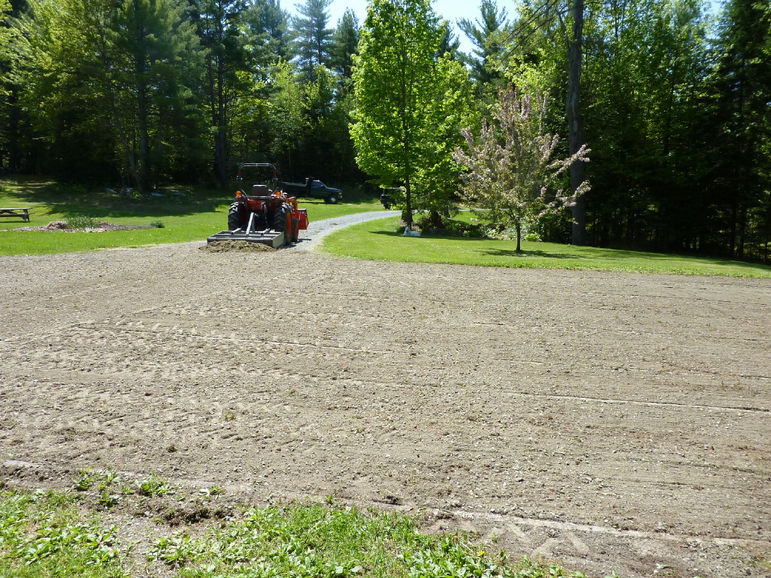

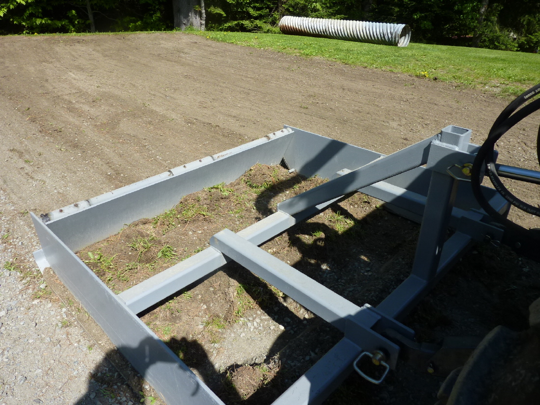

Hey guys-
Long time lurker, first time caller. I've recently found myself needing a land leveler to smooth out a 1,000 driveway I've had put in for a house I'm building. I'll be dragging it behind a Massey 4243, so I'm thinking a 7 footer..
I've been around tractors most my life, but nothing too far outside landscape boxes, bushhogs, hay rakes/bailers as far as attachments go.
What besides smoothing out this driveway can I accomplish with a land leveler?
Thanks

I don't own one. Have used one once. Perfect tool for maintaining a driveway. Requires little operator talent. With a new 1,000ft driveway I think it should definitely be on your "buy" list.
   / Land leveler uses? #3
With your MF you can handle a large lpgs 12' width and use it for field smoothing. If you plan on using for smoothing the driveway only then buy one that is half the width. That will allow you to travel each side without removing the crown.
Leveling is easier done with a box blade.
   / Land leveler uses? #4
So far, I have found my land lever to be a 1 trick pony, but it does that one trick really well.
I have about 3000 ft of unpaved shared road to maintain. I used to use my BB.
Last summer I broke down and bought a LL--talk about a world of difference--in a very good way. You drop it and drive.
I have used it to do some leveling in the horse pastures and it works great, but to be honest if all it did was the road work, it would be worth it.

I find that my box blade leaves waves in the surface where as on the other than my land plane does a much better job with little effort than I can do with the box blade. I do driveways and pads. I have used the land plane to do the finish grading for the concrete contractor inside the forms. I have use a landscape rake and box blade. Land plane is my choice for a smooth surface. It will not move dirt like a box blade.
   / Land leveler uses? #6

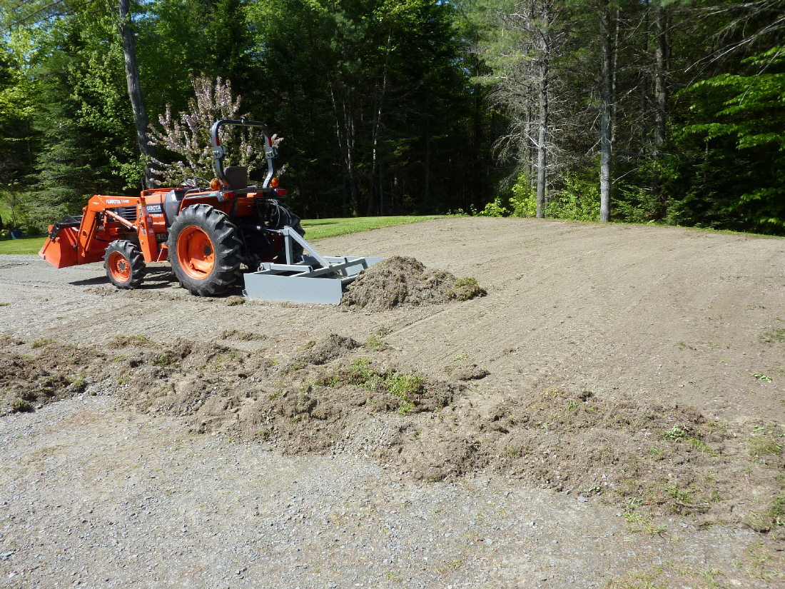

It is basically a tool for making a flat plane as they said. I can use mine for removing sod but it is a little different than most.
When Steve said leveling was easier with a box blade I believe he meant in the case where the surface to be leveled was at an angle, ie not horizontal, where you have to move material from the high side to the low side to get it level. A smooth plane is not necessarily level is his point I am thinking.

After 10 years of keeping my 1/2 mile driveway with a box blade I got a LPGS and when everyone got home that night they were thanking me. The best money I've spent.

So, for those of you using a LPGS (what is the G and S?) does it turn up the gravel a lot?
I'll have a chert driveway topped with crusher run when it's all said and done..
I'm a little curious about how the crusher run will wind up mixing with the chert when I start dragging a LPGS on it..
   / Land leveler uses? #9
Land Plane Grading Scraper. It will disturb your existing surface as much or as little as you want. Most come with adjustable rippers like a box blade if you REALLY want to mix it up. And most have a blade depth adjustment relative to the side skids, from negative (above the skids) to maybe 1" or even 2" below the skids.
I haven't used my brand new one yet, but I plan to try it first set like I have read others on here have done - 2 or 3 paint stir sticks. Or about 1/2" or so. My road is similar to yours, a skim of crusher run over larger mixed river rock. I don't want to disturb the river rock much since it is a good, solid base.
