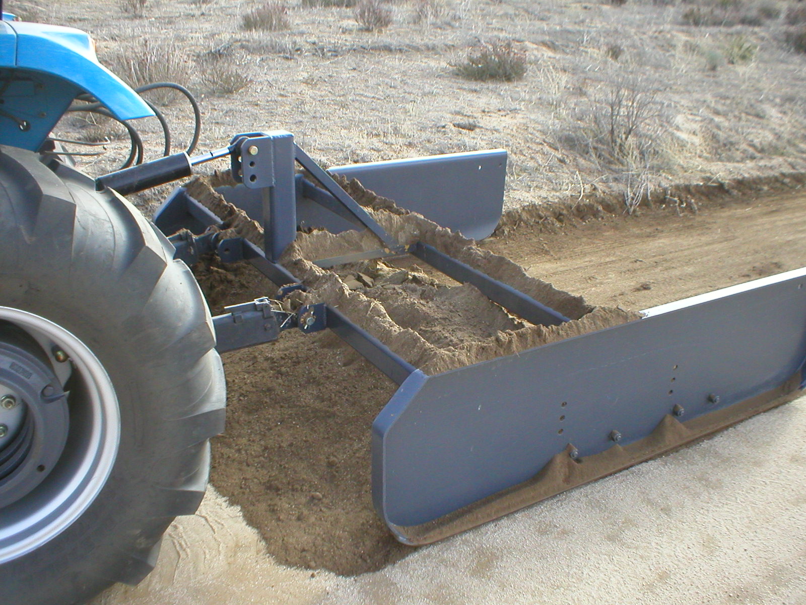

All depends on conditions and what you are trying to do. I can and have moved on a regular basis about 3 cubic yards of material at a time with my 7' LPGS. Big big difference between barely making a cut and having the material just flow over the cutting edges vs making a full cut and actually collecting the material. Now this does not apply to crushed rock as much as dirt or fine gravel. For me the ground has to have the right moisture content, but that is usually about right where it should be for grading a road anyway.
Can't find any pictures of the LPGS full of material, but you can see where dirt has been up and over the top cross bars and just that by itself just under 2 yards of material.
Just my experience, others will vary. ;)
