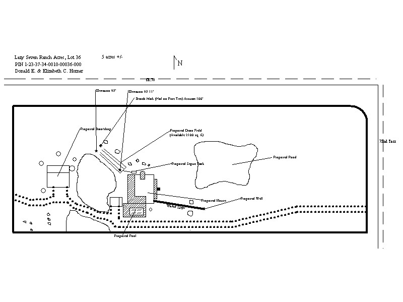

There are only two fool-proof solutions for me. (1) Dynamite the flood gate. (2) Bring in enough fill to raise my entire property about 1 foot. That would be about 8,000 or so cubic yards, and it would kill a lot of the native landscaping, so that isn't going to happen. I'm just going to have to live with a certain amount of flooding when the gate is closed. When the flood gate is open, my entire property is nicely dry within hours after a storm -- there are no actual permanent wetland areas.
I do have some intermediate solutions to control areas which are more prone to flooding than others. Most of it was created when I raised the driveway high enough to stay dry for the entire length of the property; about 800'. The area on the "short" side of the property cannot drain over the road. In the attached rough drawing of my site plan, it's the area at the bottom of the property, below the dashed lines showing the driveway. I'm going to create some drainage swales and some pipes under the driveway to transfer the water to the side where it will continue to drain. Some of the areas will be built up a little. I expect the work to take several years at my current speed. We'll never be able to prevent all the flooding, but we can make it easier to live with it.
