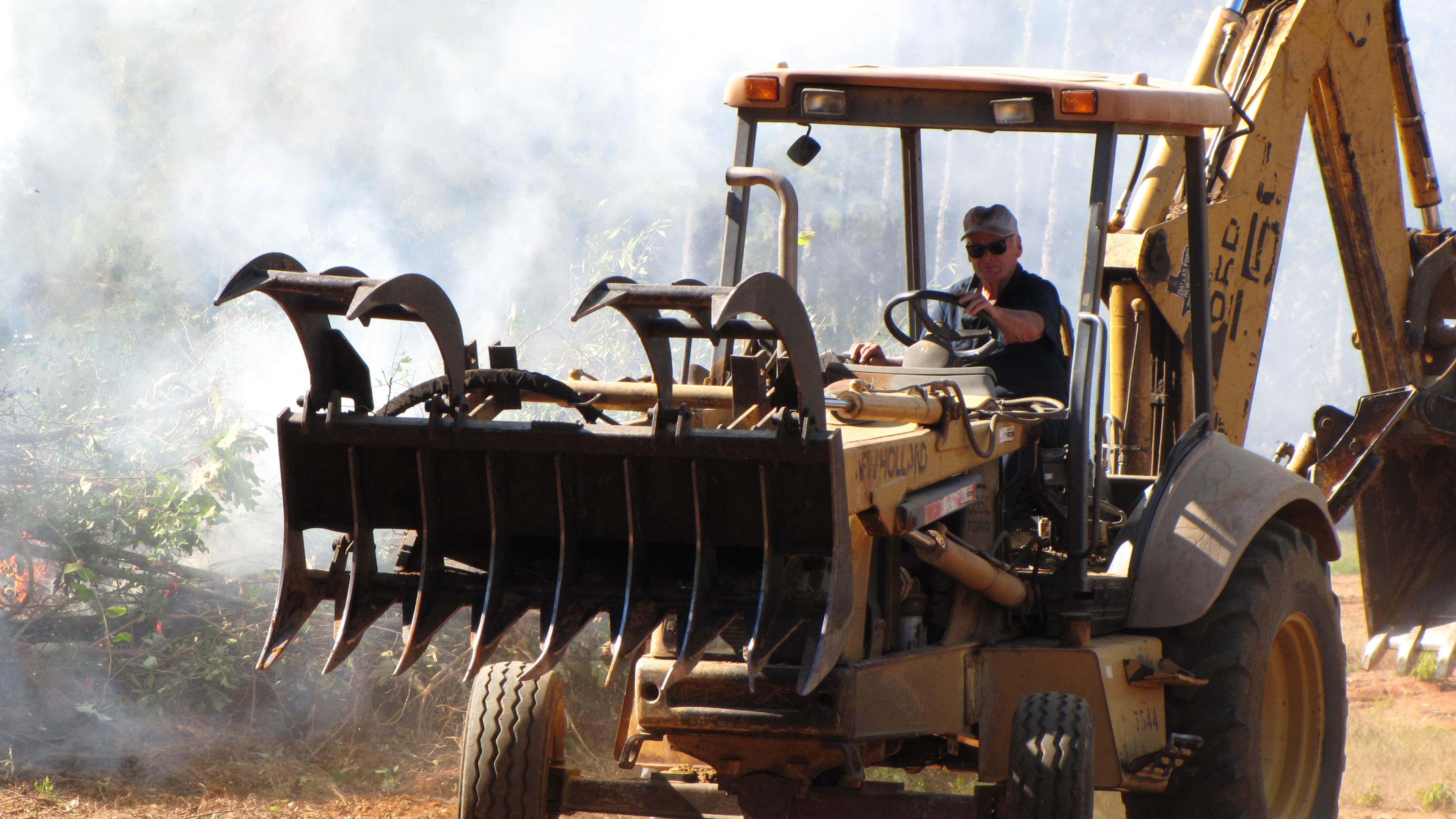

I have a pretty good sized dozer and it's the last thing I would use for land clearing. It does the job, but it also creates a heck of a mess that has to be cleaned up which means doing everything twice. An excavator is the best tool for clearing land. Pulling out small trees and brush with the roots intact is quick and easy. No roots to deal with later on. roots in the ground will haunt you for years. Disking or plowing them up doesn't work so well and it creates more work and a lot of frustration. Getting the roots out with the tree all at once is the fastest, easiest and cleanest way to clear land. Especially if you are going to plant a garden. Most small excavators have a blade on them for cleaning up the ground. It's nothing like a regular dozer, but it will get the job done. I have a full sized backhoe and that's what I use for clearing land. The hoe either plucks out the smaller stuff, or digs down around the roots for the bigger trees and pushes them over. I've taken out oaks and pines that where 3 to 4 feet thick at the base without any problems. The hole is pretty big on those trees, but with the front bucket, it's easy to bring in some dirt and fill it up so you never know the tree was ever there. Time wise, taking out the entire tree is anywhere from 15 minutes to half an hour for trees from a foot to 2 feet in diameter and depending on the species. Cutting them off with the chainsaw takes about five minutes, but then several hours to dig up the stump. Stumps are the worse thing in the world to dig up. You lose all the leverage of the tree standing there and it's where all the damage to the machine occurs. Using a dozer to take out a stump is even worse because you have to get the blade under the root ball and cut at least have the big roots. The only way to do this is to dig. And a dozer blade digs a BIG HOLE!!!! If it's small enough to just pluck out and push over with the dozer, it's even easier and faster to take out with the hoe.
Are you going to burn or haul off the debris? Either way, it's is going to be faster and easier if you can pick it all up and place it on the burn pile or trailer. The dozer, even with a rake, adds dirt to your burn pile. You end up with a dirt hill as big as the burn pile by the time everything is done, which means more work. By picking up the debris and putting it on the pile, you get a clean burn that goes a lot faster and leave very little to clean up. I don't know how you would load anything with a dozer.
Once it's all cleared, the dozer is by far the best tool for grading the land, and that's what I use mine for. You can also grade the land with a backhoe or boxblade, but both are slower. If I already had either one, I probably wouldn't rent a dozer for such a small area, unless you really have to move a lot of dirt. If you don't have any experience with a dozer, it might be cheaper to hire it out. An operator should be able to get 2 acres level in half a day with a decent sized machine.

If you are going to get a backhoe, or already have one, you really need to look into getting a grapple for it. NOTHING comes close for cleaning up the debris you take out with the hoe. You never have to leave your seat to wrap chains around anything. We have found that it's best to take out as much material as possible without driving over anything. NEVER EVER drive over branches. They will tear off hoses or go through metal. Once you have an area of debris laying around, then concentrate on cleaning it up with the grapple. Being able to stack everything allows you to burn it clean. Once the burn pile is done, there isn't very much left to clean up.
