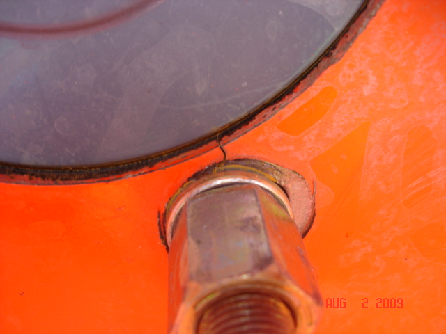

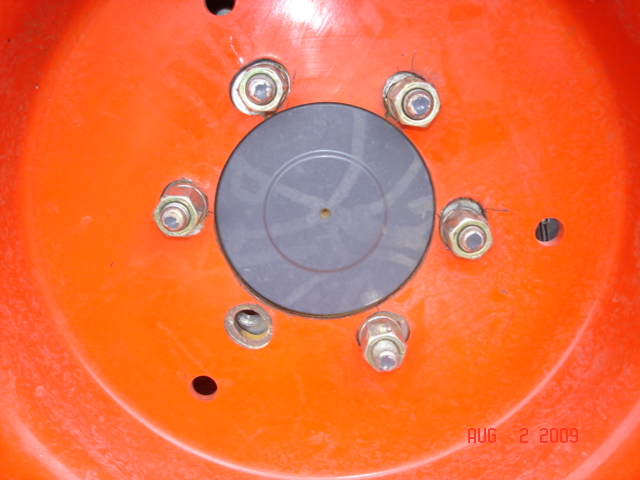

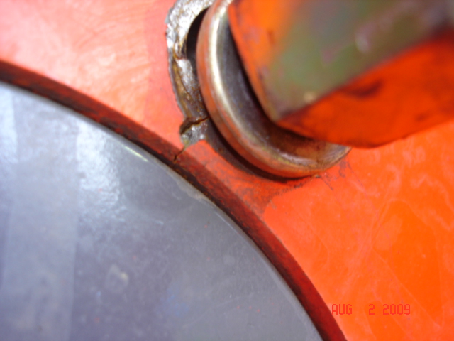

So in between downpours, I dash off in the Kioti to borrow forks from my buddy about 2 miles away so I could get my wife that round bale she always wanted. On my way back on the paved road to get to my lower field to fetch a round bale, I noticed some rear wheel wobble while tooling along in road gear. I looked the tire wobble and thought, "geez that sucks" and proceeded through the field, up to the house, and I dropped off the bale by the garden. Since it was so sloppy, and I plastered the Kioti with clay and such, I decided to give it a good rinse why the clay was still wet. It is then when I noticed one lug missing and the remainder of them really loose. The nuts did not loosen - rather the bolts backed out of the flange! The wheel holes were worn larger, and the steel is all cracked.
I religiously check the wheel lugs, and the bolts have red loc-tite on them. That's why I though nothing much of it, other than I may have bent the rim during some serious ground engagement. I had done that to my Jinma. I'm surprised, but glad that it didn't come off at 16mph! Looks like I'll be ordering a new wheel center and a set of lug bolts.....

BTW - my wife found the missing lug bolt, with nut firmly attached, in the driveway in front of her Jeep ( ~50 feet from where I parked the DK). I'm not certain, but she may have been looking for worms after the rain......

Thanks fellas. Yes, the tires are loaded, but I can swap the dish out with a new one with the tire resting upright. No big deal.
