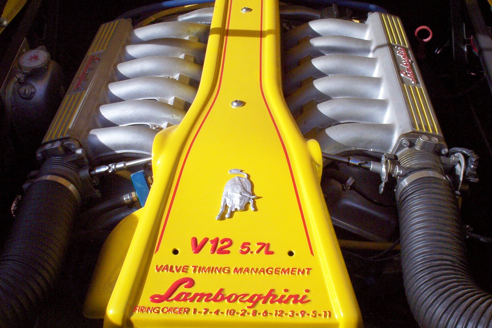

I've dealt with some diesels that had issues from brand new with the glow plugs going bad. They are just a heater and by their nature should have low resistance. Take the lead off and test from the glow plug terminal to ground, should be a very low reading on your ohmmeter, like 5 ohms or less, maybe lower than 1 ohm. If it was a dead short, you would have a blown fuse.
Does the motor look like the motor in the pic that's in my car?
   / Lamborghini/Mistibishi Starting troubs #5
How did you ever stuff a 12 Cyl lambo engine in your Yugo? It sure looks good, though ;-)
