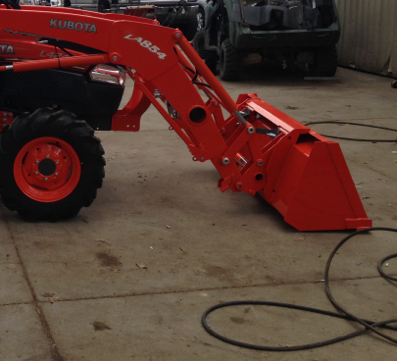

Did Kubota ever make a QA conversion for the LA950A?
   / LA950A Quick Attach Conversion
#2
Im going to guess the answer is no. I'm tempted to get a Titan Quick Tach and find a welder that can cut the ears off my bucket and make it work.
I have seen those, just a little pricey. Measuring, my pins are the same size and arms are the same distance apart as a LA854. Anyone think of a reason that wouldn't work?
Looking at pictures of the two, I see the angle of the pins is higher on the LA854. It appears I would loose some roll back.
I snagged a couple of images from other posts. My thanks to those who posted them.
I looked at an LA844 loader and now feel I would actually get more roll back and a little less dump. That would actually be a good thing as I always wanted to be able to roll back farther when scooping. At $450 the Kubota QA adapter is a good price for a quality piece as well.
