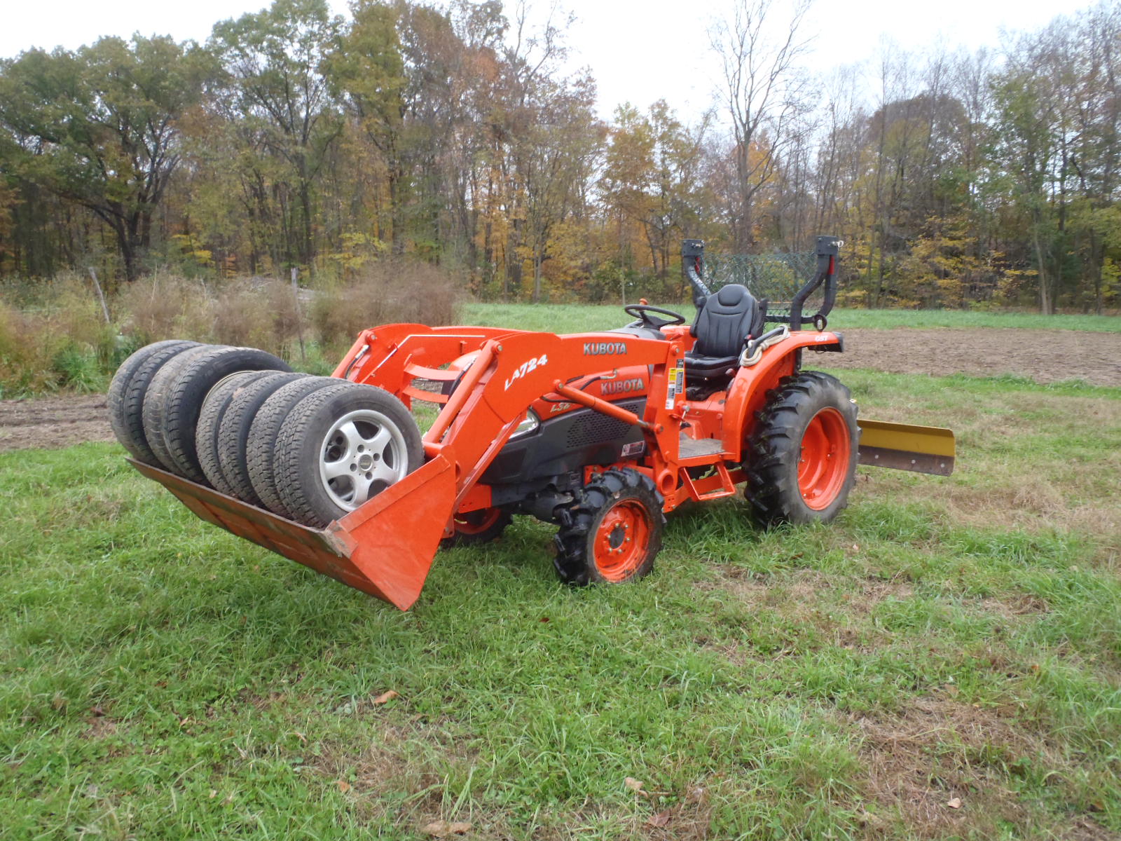

Why I like the 72" round back HD on my 724/3240:
... fits both sets of snow tires, so just one trip back to the shed to fetch them and one more to store the Summer treads.
It's also nice to able to dig wider than your track - keeps your machine level with the last pass and allows you to dig deep with ease.
If I'm working in an area where it gets in the way, I take it off.
