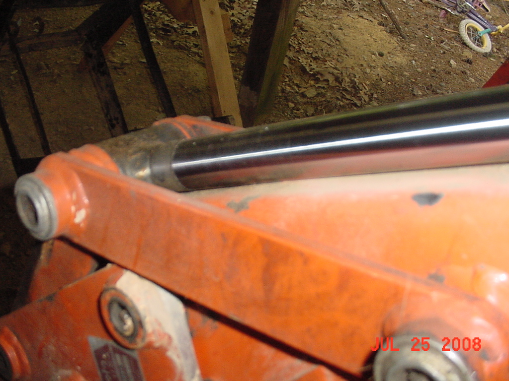

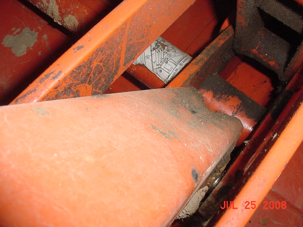

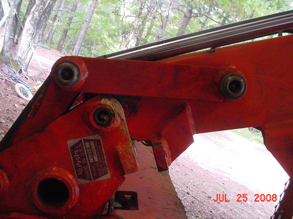

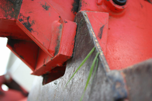

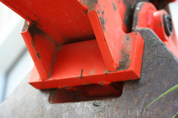

I recently stripped the nut off the cylinder rod on my loader.
I got a new rod and nut and took it to a mechanic to replace the parts. When I picked up the tractor the mechanic showed me that the curl stops on the loader were not making contact - see pictures.
This has caused the sides of the cylinder rods to press into the top of the booms.
I sent pictures and explanation to the dealer. He said a Kubota rep is coming by this week and he will discuss with the rep.
Has anyone out there seen this happen before?
When you buy tractor, curl the bucket down all the way to make sure stops make contact.

I had the same thing when I bought a quick tach for my loader it was simple to weld in a half inch shim to allow the stop to contact before the cylinder rod contacted. KennyV.

The fix looks simple enough but this loader was delivered new this way and I've had the tractor for over 4 years (approx. 360 hrs) before I became aware of the problem. I have not modified anything on the loader. I can't see how the factory welded the stops in the wrong location on my loader and in the right location on all the others? I would think it would be an automated manufacturing process?
It has already cost me about $450 to replace one cylinder rod and the mechanic believes the other rod is bent. I've had a leaking cylinder - seal kit for one cylinder costs about $90 and Ronnie at Tractorsmart told me they are very difficult to install. There's no telling what else might be damaged.
Anyway, I hope Kubota will do me right on this deal.

I looked at my LA723 and It had the stop located as yours is but it had an additional structure that extended the stop 1 1/2-2". Both sides the same. A manufacturing step was skipped. Ride the dealer and Kubota until they make you whole. Some body should have caught this before now.

If that loader was not a QA to start with and someone changed it over so it would be QA, then the stop will not be in the correct position. When I got my LA723 it was just a stander FEl. I soon bought the FEL part and the plate for the bucket. After getting everything together I soon found that I didn't have that "snap" action to allow cleaning out my bucket. I asked my dealer about it and he immediately produced a kit of weld on pieces to put the bucket stops where they had to be, and at no charge I might add.

I bought the QA loader new. I've never modified anything. I was new to tractors when I bought the L3830 so I had nothing to campare it to. A year or so ago I bought an old B2710 w/ FEL and noticed that the bucket did not flop at the end of the curl. I don't use the loaders everyday or I might have investigated further as to why the 2 loaders behaved differently.
I would love to see a photo of the correct stops on this loader.
The stops on my FEL are on the booms and on the QA bracket/linkage.
/ LA723 Loader Stops #13

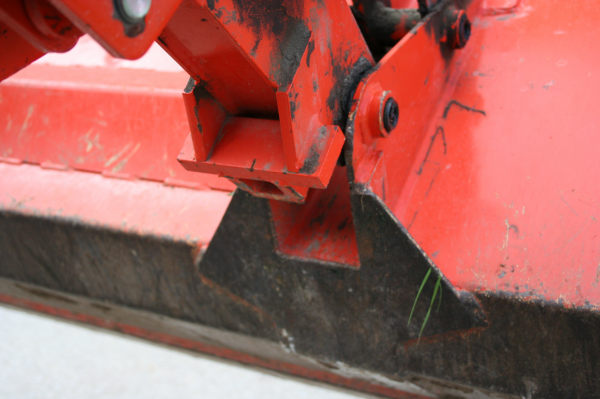

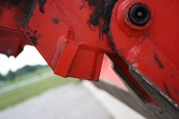

Someone did a half modification on your FEL before you got it.

Thanks for the pictures. I guess this is what mine should look like? It makes sense that the blocks of steel are where they are on the pictures.

By half modification I mean that someone made that standard LA723 a QA but never welded on the extended bucket stop blocks.

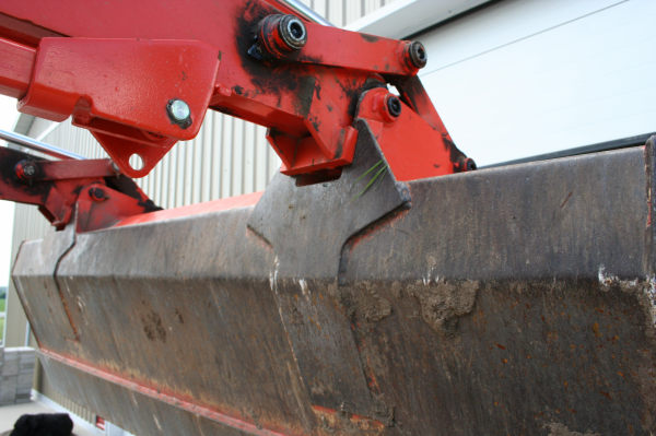

I am note sure if this is too late but here are a few shots of my 723 loader stops. I have the standard bucket not the QA. Steve

THANKS FOR THE PICTURES.
My dealer was supposed to have the Kubota rep call me. I haven't heard from anyone at Kubota. The dealer thought the most I could hope for is Kubota installing the blocks on the boom - where they should have always been.
