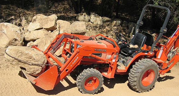

The service manager at my Sacramento Kubota dealer asked me if I was having slow/weak curl problems with the LA352 on my B7610. I thought the curl was weaker than it had been in the past. We're talking about over capacity loads here. Stuff I couldn't lift but used to be able to still curl back. I'd just skid the boulders along that way, even if I couldn't lift 'em.
He said he'd put me on the list he had for Kubota when they come up with a solution for the slow curl. That was six months ago, I haven't had any calls yet.
Pix is of one boulder. I moved the whole pile in the background to another storage spot.
