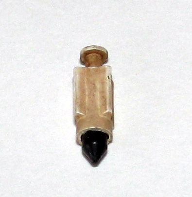

I bought a carb rebuild kit from Briggs & Stratton for my LA145's engine. It was delivered about 6 months ago after I discovered that I could get around the problem by blowing low pressure air into the inlet hose to pop open the valve when it sticks. The engine would run perfectly after one "fix" and maybe start and run again the next time I needed it too. Then I switched to non-ethanol fuel and the problem seemed to disappear. I must have used the mower 10 times and started it another 10 times just to see that it was working properly. A couple of weeks ago, it started acting up again, so yesterday I decided to put an end to my misery and replace the float needle valve after cleaning its seat.

I replaced the sticking float needle valve today with the one from the rebuild kit. The major difference in the needles is the one in the kit was solid brass with a rubber tip. The one I removed was plastic with a rubber tip. The weight difference is amazing. A photo of the plastic needle that was sticking is attached.
The mower starts instantly and runs perfectly. I won't know if this fixed my problem for several weeks, but I'm thinking the new needle will do the trick.:thumbsup:
