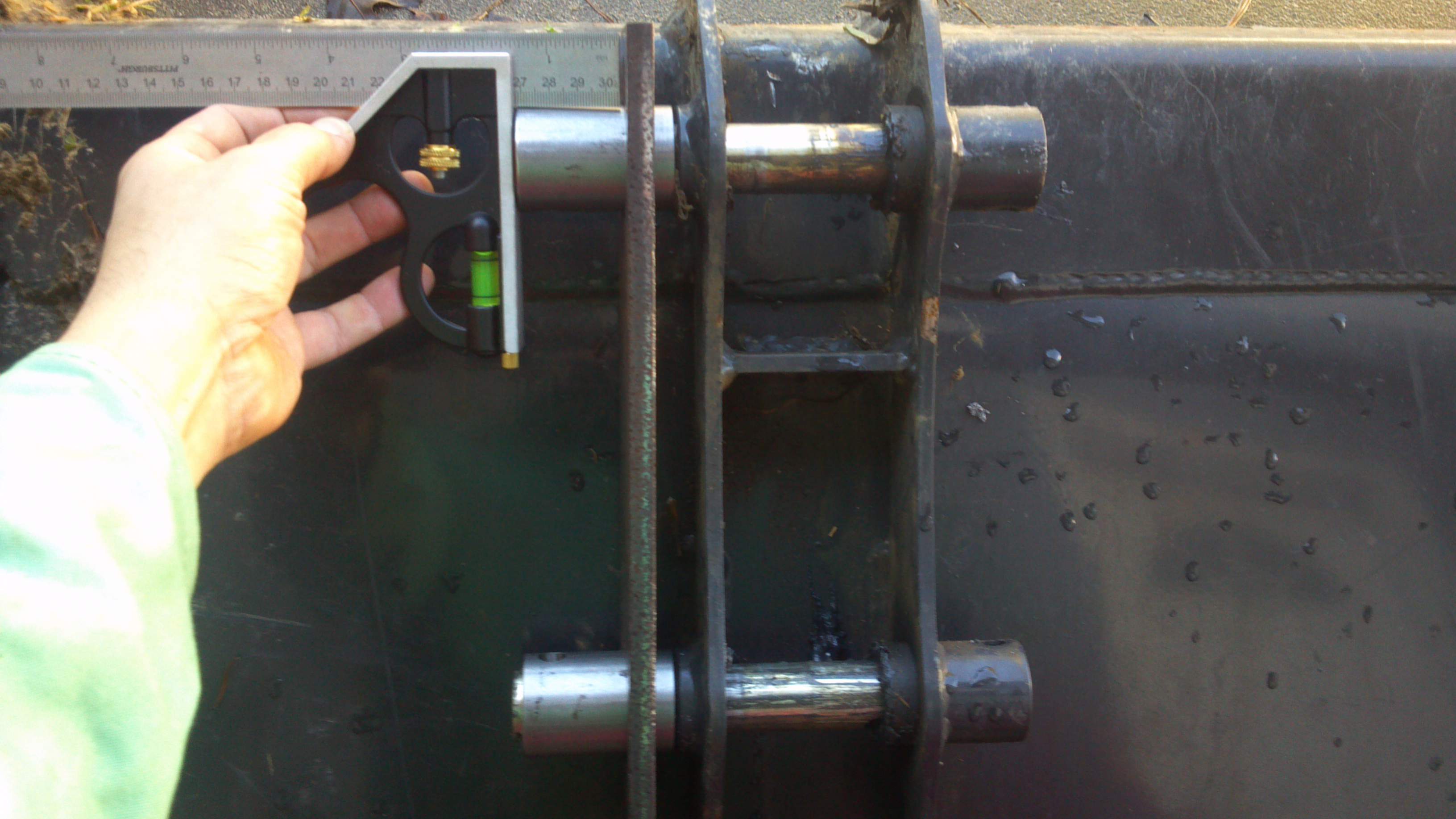

I am looking to modify a older plow to accept my loader arms with Quick Adapter - I realize I can take some of these measurements myself but I was wondering if a drawing exists that shows the dimensions for the receiving end of the FEL Quick Attached. In other words what the dimensions for what is depicted in the picture attached for a B2920 LA364 loader.
Anyone have a suggestion as to where I can look?

No, I don't have dimensions, but have built a few implements for a 365 loader. I built a template out of stiff paper/cardboard off the bucket attachment. It's very tough to get the pins and bushings to line up correctly unless you have nice tools to work with that will allow you to drill through multiple pieces of metal at one time. Take some time to set things up and you'll be able to do the same thing.
