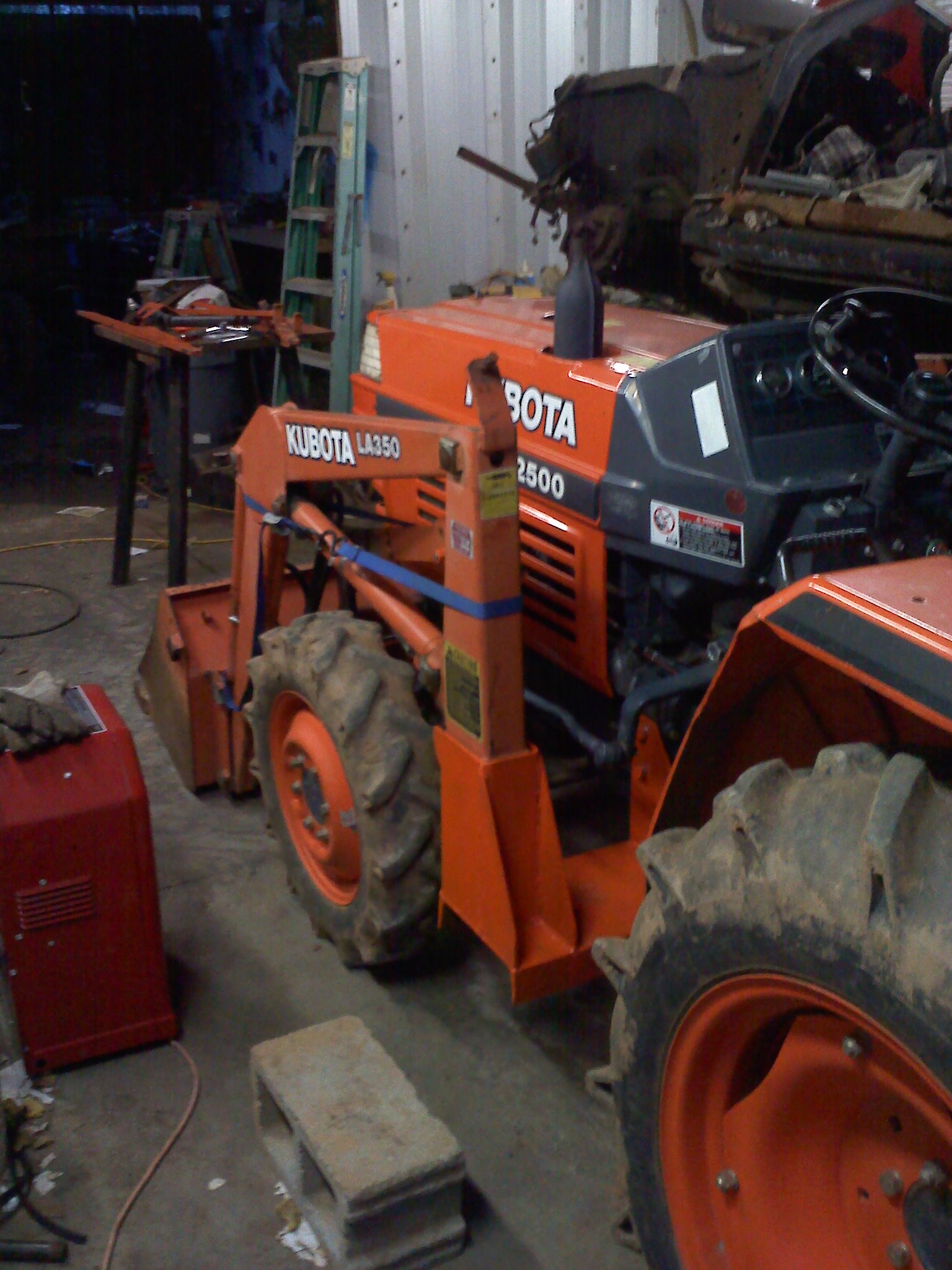

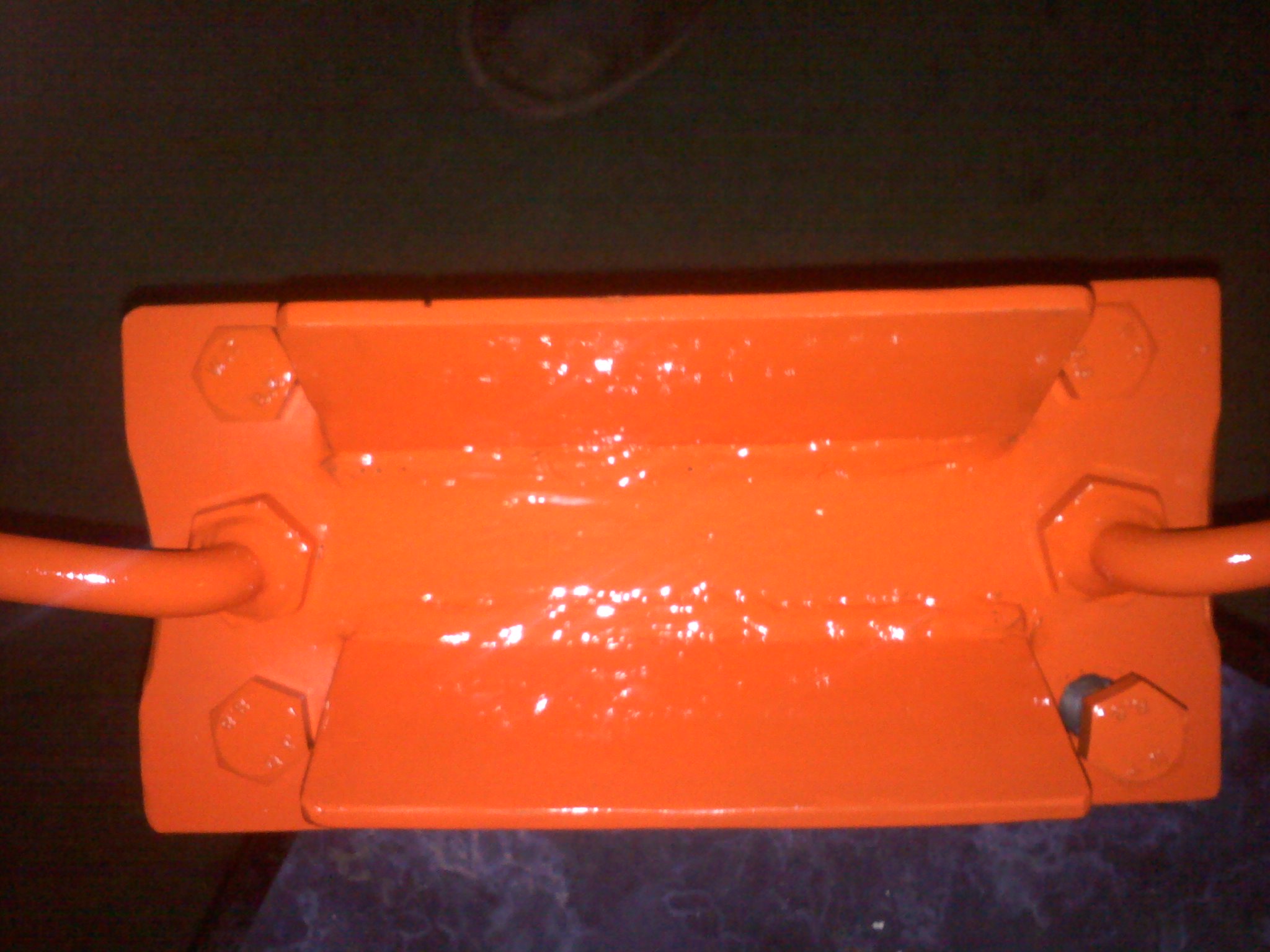

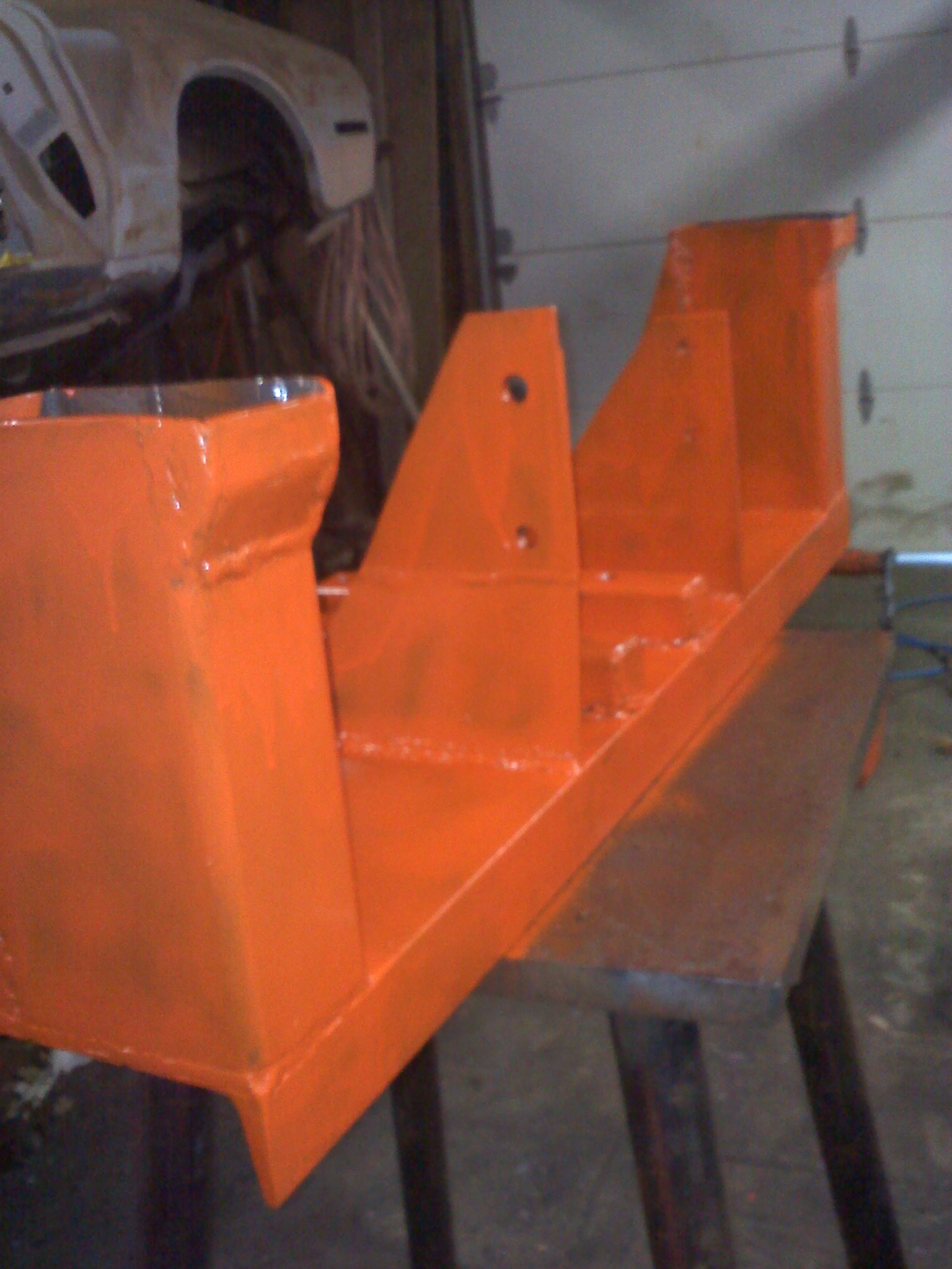

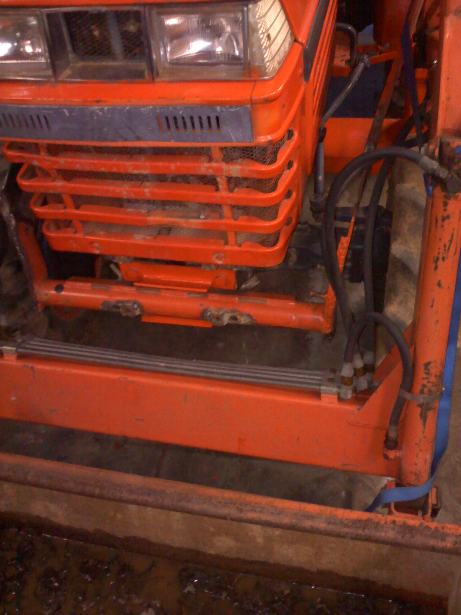

Thanks for the replies and here is a few pics of what my son and i built over the last 4 weekends.
We need to do hydraulics and we will be ready for the white stuff :)
Thanks Again Carl

Looks close to stock.Back one looks factory.I think the front one was a bit beefier and tied in on the front sides just behind the grill.They were a bent bracket not sure how thick maybe 5/16. As long as it works its good.One day when I am up in the interior I will get pics.

Nice job Carl it looks solid. I will have to keep my eyes and ears open for something that will work for me.

My son and I worked about 30hrs on in over a few weekends but the cost from kubota for new was 2 k and I'm a bullhead when it comes to cost of things.
I spent 175.00 on steel and labor so maybe total cost i have into sub frame is 600.00
My son and I did get last bolt holes drilled and hydraulics hooked up today but lines are hooked up wrong :confused2:
We`will figure it out next weekend just need to move hydraulic lines around.
Thanks Again To all that HELPED Carl
