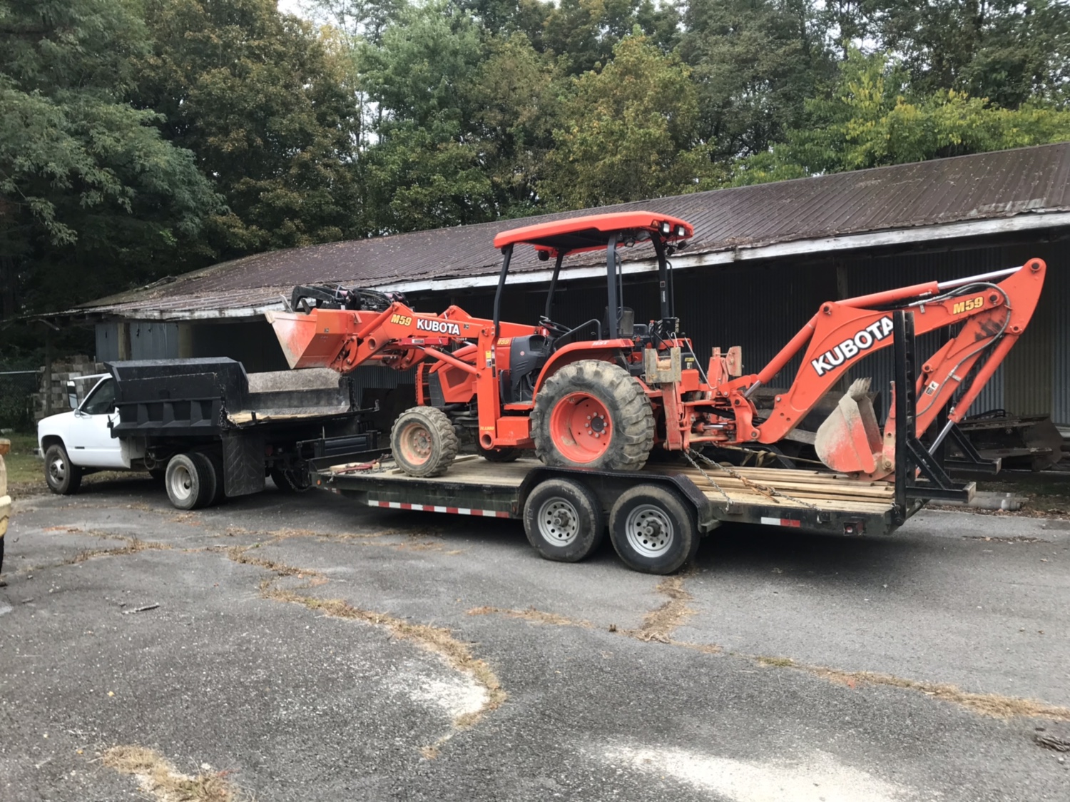

You should be able to haul a M62 without a CDL. My truck, trailer, and M59 weighs somewhere around 21k. The truck GVW is 10,000 and the trailer gvw is 14,000 which is still a GCWR if less than 26000. I’d probably have to switch to my black trailer vs the heavier yellow trailer but I could move it behind my 6500 and be under CDL weight. Under 26,000 GCWR probably not. BTW I just bought a Kubota KX040 and if you already have one you’ll probably be disappointed in the backhoe especially the L6060 one. IMG_9144.JPGIMG_8580.JPG

That’s a ripoff. I don’t see how you’re going to haul a L6060 either. They’re 4300 pounds base weight plus your backhoe and loader. You won’t be much if any less than the M62 and you’ve got half as capable machine.

The M62 backhoe comes off easily. You’re probably in 10k trailer capacity with it off.
