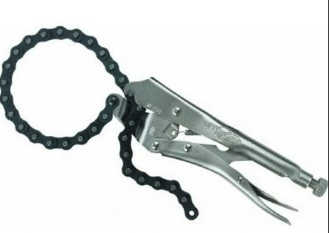

I was gonna just tell you about the vacuum trick, but it seems you found it out on your own. Works great! Getting those filters off is a real bear. I upgraded wrenches a couple times until I reached this one, that did the trick. Still not easy:
