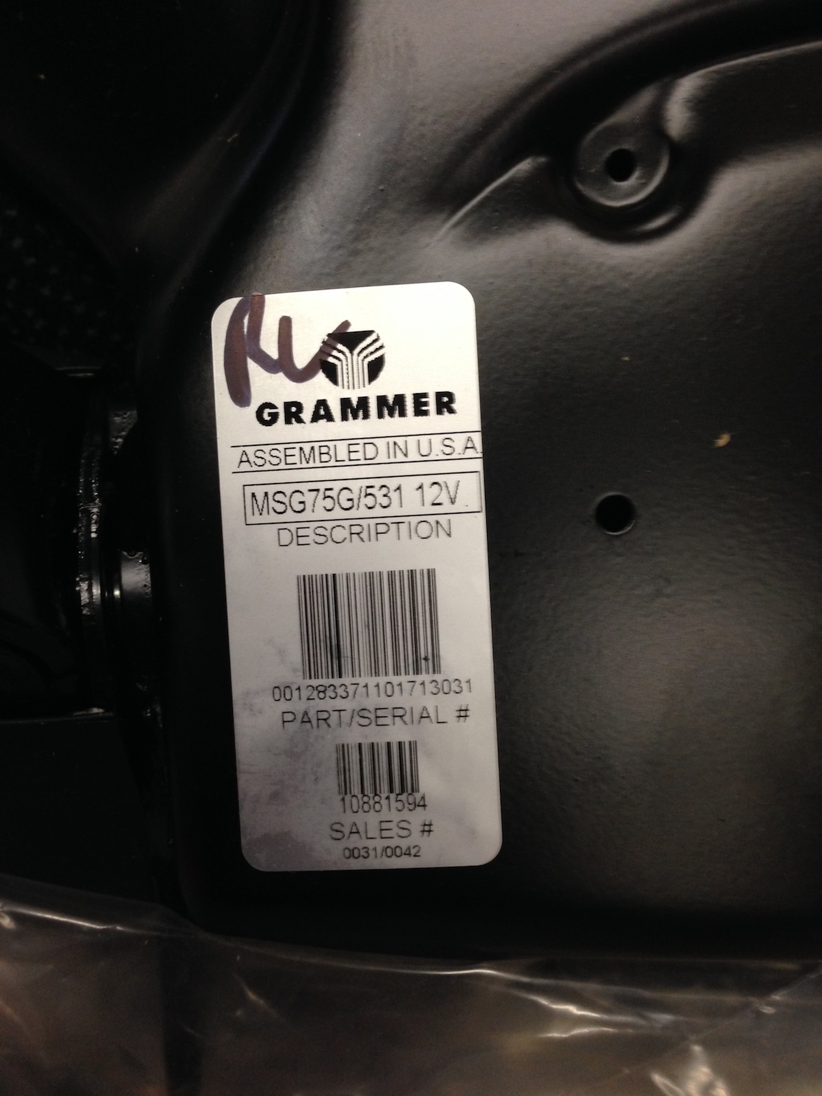

According to an old thread, Grammar makes the seats for Kubota, the one shown was an MSG75G/531. I am sure the Grammar catalog will show one in vinyl.
