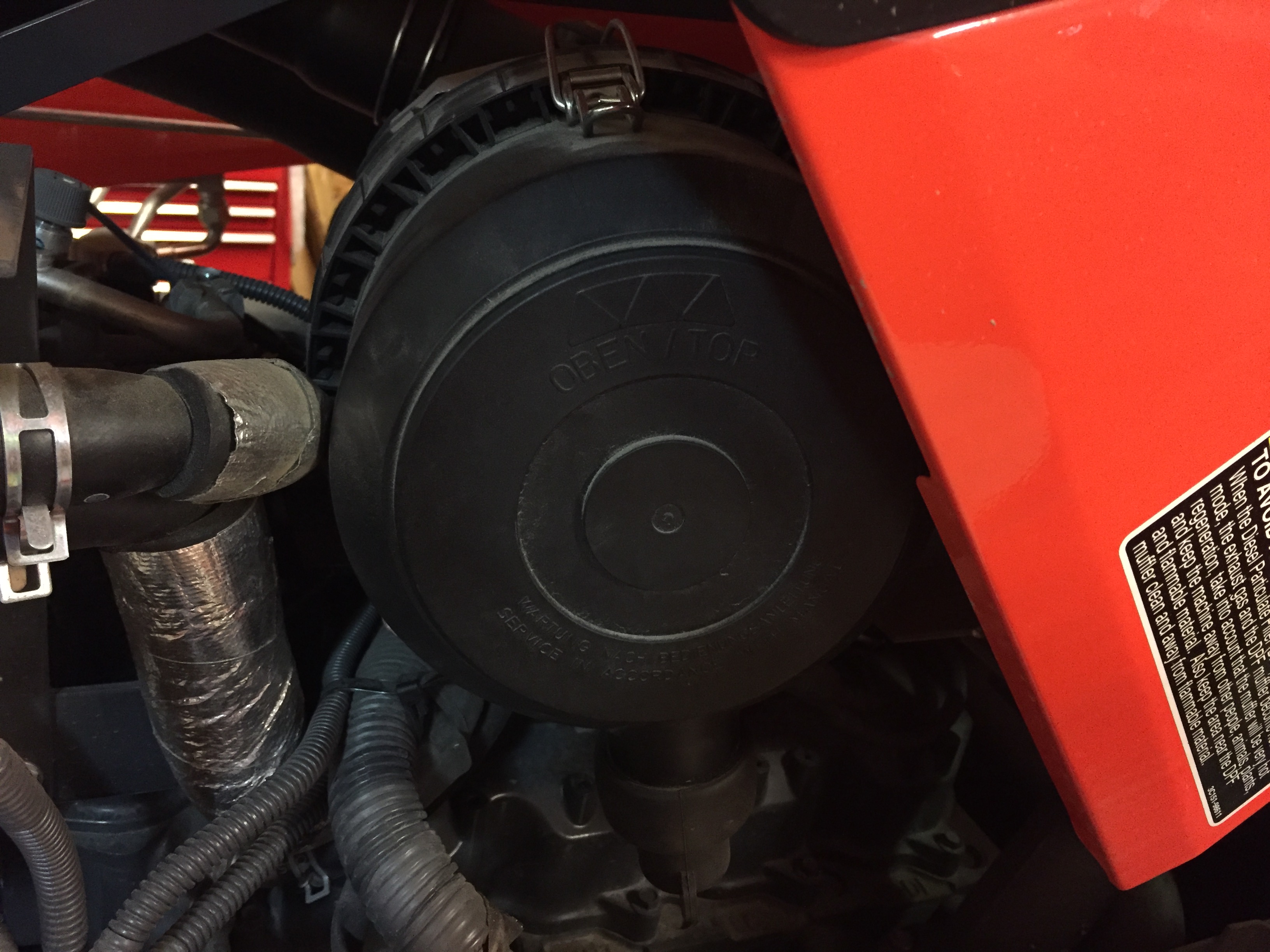

I've been inspecting it and going over everything to make sure it's all in order, and I recently discovered that I cannot remove the air filter housing cover because the side of the hood is in the way. It seems like I may be doing something wrong because I'd think I'd have heard others complain about that. Does anyone else with these tractors have that issue?

Have you had your air filter out? My hood doesn't seem to open enough to give clearance to get cover off the air filter housing.

I've had the air filter out to blow it off a handful of times. Not particularly difficult. Make sure you are unlatching the brush guard so it tilts forward. Otherwise the hood wont go up all the way. It doesnt go super high, but enough. Might be a tight fit to wiggle the cover off, but it wasnt painful or memorably hard.

Thanks a lot guys for the insights. I'm trying to show a picture of the problem I'm having with my air filter cover. There's no room between the hood and the lines for the oil separator.

I tried to push on the hood and the lines to get the clearance, but I wasn't able to wiggle it out. I'm thinking I may have to unhook the shock for the hood to get it to open more.
You should be able to undo those spring clips & pull the end of the housing off. One of the 3 clips is visible ontop of the housing in the pic. Then once that is off the filter inside comes out part way. Lean it over to one side to get it the rest of the way. Nothing particularly challenging at all if I recall.

I was able to undo all the clips I just can't fit the cover out between the hood and the pipe. I'll have to try again and be a bit more forceful.
